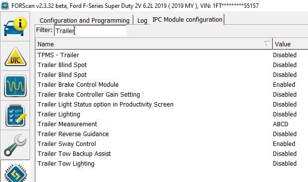

On my 2019 I'm pretty sure I enabled the following, but can double check this weekend:
  • IPC Module -> Trailer Brake Control Module
  • IPC Module -> Trailer Brake Gain Setting

Got it. I was able to go into ForScan and enabled both Trailer Brake Control Module and the gain like you mentioned. I noticed also there was a third option there for "Trailer Brake Module" which I believe is the module under the dash by the ebrake. That was also disabled. Do you know if that one also needs to be enabled? Maybe see what you have yours set to. Much appreciated!

These are my settings. Looks like I was wrong about the gain settings. I have no problems with trailer brake gain.
