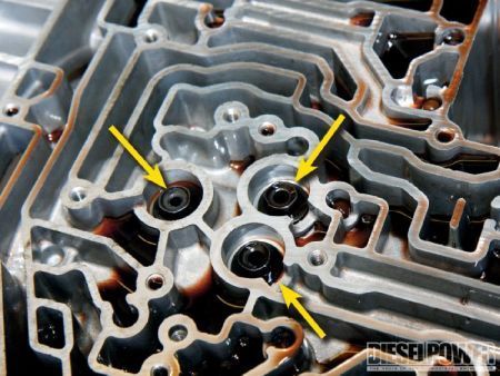

How did you come up with the torque converter being the problem? The torque converter doesn't know what gear the trans is in. It can't work in reverse and not forward, that's impossible.
It could be loose feedbolts. If they are loose it can cause this. If they are tight, the trans is done and needs to be rebuilt or replaced.
To get to the feedbolts you need to drop the pan and the main valve body. Then you can see them up in the case.

Had to do this on a buddy's 2002 Excursion. I also found a valve stuck way open. I shimmed it so it wouldn't do that again and while it bought him time, it ultimately had to be rebuilt. I found way too much clutch material in the pan.
