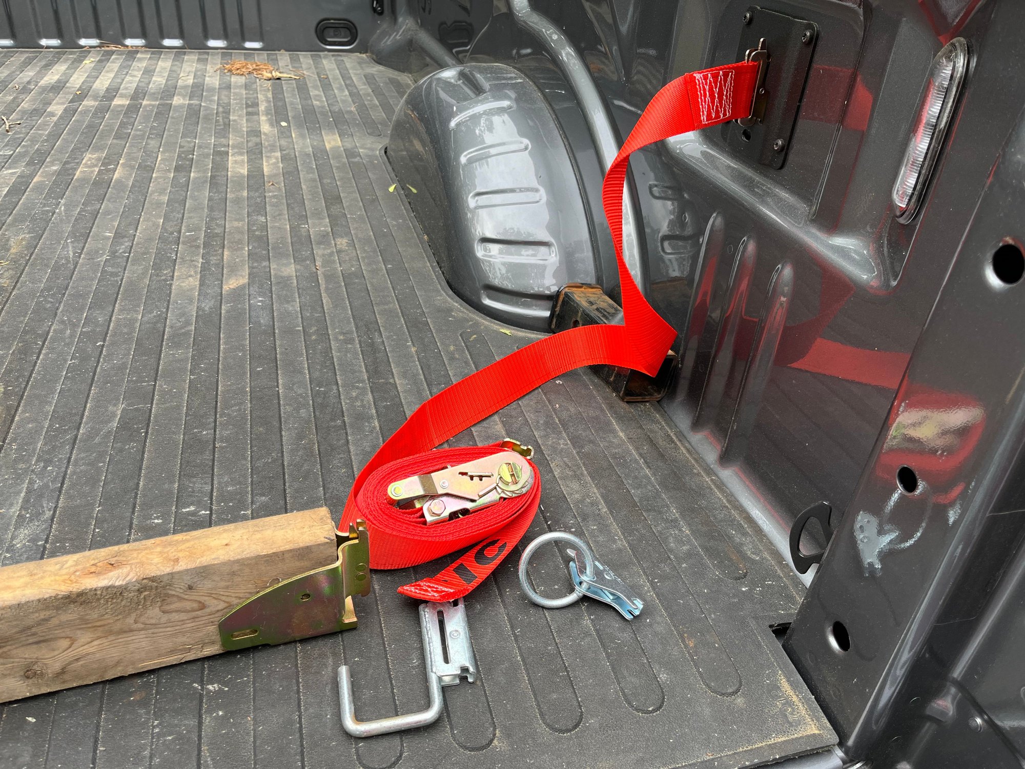

I am missing some piece of information and am embarrassed by my lack of knowledge and no amount of poking around has led me to the answer so if anyone here can educate me I would appreciate it. My 24 F-350 CCLB came with brackets installed for bed cleats in four locations in the bed. I bought some cleats which were supposed to fit this model but all the cleats I can find have to slide up into a slot in the bracket but my brackets from Ford do not have a slotted hole just 2 identical holes the same size. I guess I could buy some cleats that come with brackets and replace everything but I guess this whole process has confused me. FWIW this is my first truck since a 1994 which I sold in 2004, learning on the job I guess. The picture is of what is installed on the truck.

For 24, Ford switched to these new tie down plates instead of the Boxlink plates used on previous years. These new plates are just anchors and do not accept accessories like the old style. You will need to swap them out if you want to use Boxlink compatible cleats.

Buy a few motorcycle tie down straps and loop them thru the plates and leave them. If you ever need to use a rachet strap just attach the hook to the strap you looped thru the plates.
The Boxlink plates will also accept E track accessories. I found it easier to use them than the Boxlink cleats. They were a very tight fight and I thought it was a pain trying to slide them in or out. In fact the last couple of trucks I let them go with the truck at trade time, still unopened in the factory packaging.
As Randy said you could also use motorcycle "soft tie" straps that have a loop on each end. Generally used on handlebars when strapping a bike down.

I’m not against spending money. What advantage do these tie down cleats have over a simple strap looped thru the plate?

I don't want to leave a strap looped through the plate, and all my ratchet straps all have hooks that won't fit between the back of the plate and the bed of the truck. I want something that's going to hold things securely, and I think my lightest-duty strap is rated for 1k lbs and go up from there.
The old box link cleats allowed for larger hooks and no extra straps that could get lost or break, as well as giving a good place to attach the looped end of a rope to if you needed to use a rope instead. BoxLink also allowed for a host of other Ford-branded accessories such as their stowable ramps and whatnot, though it sounds like those didn't have a high take rate.
Knowing now that the box link plates accept E-track components opens up a whole WORLD of options for things other than just tie-downs. Tool mounting, hanger brackets, whatever you might need is available through E-track.

The old style box link plates accepted E-track accessories. There is an entire world of E-track attachments out there.
