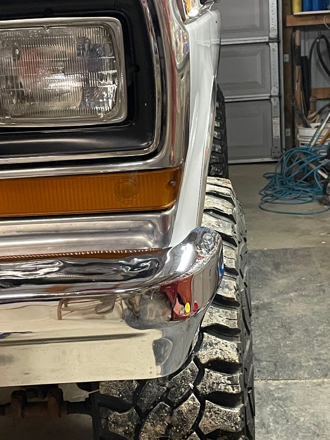

I have a 1978 f150 that looks a little off. How would I go about determining if my problem is body alignment or axle alignment. First post, be kind. I’m a senior citizen.

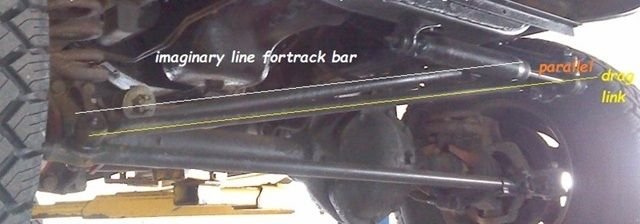

If "the real hillbilly" looks from the front, the trac bar and the drag link should be very near parallel end to end, going by the bolts as the trac bar has a bend out at the wheel end. If not, good chance the extended mount wasn't used. Not lifted, it's just up on a lift.

So, your trac bar and drag link are parallel?

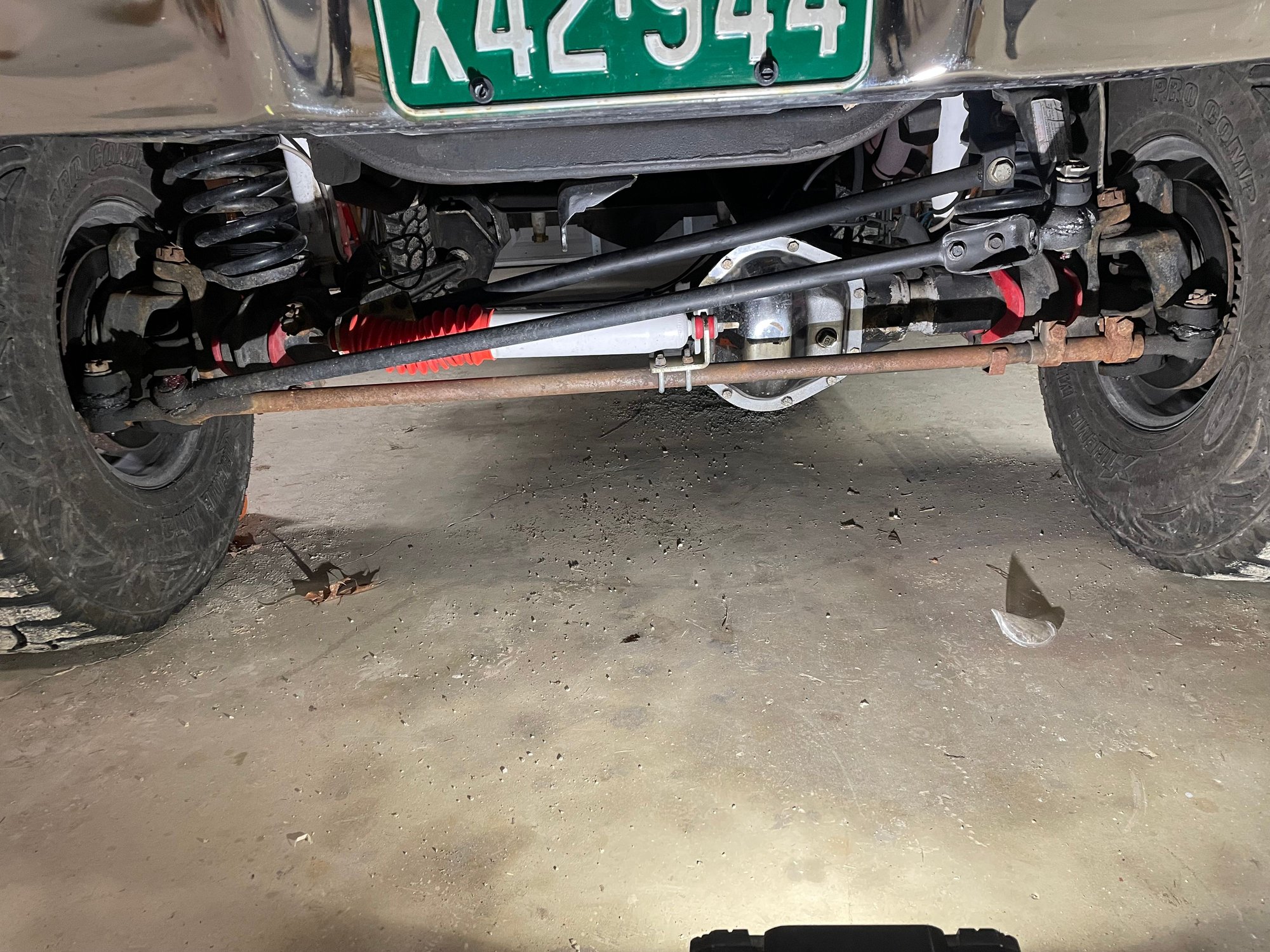

Here is a pic of front end. What will I be looking for behind the bracket? Cracks I presume?

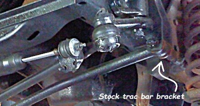

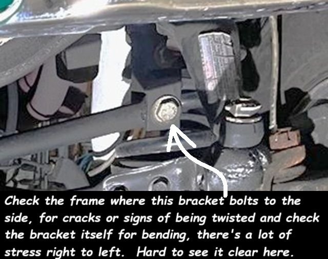

Yes, cracks, and try to determine if the frame rail is twisted or not when compared to the other side rail. The outside of the frame rails should be plumb with each other. Hard to see that bracket, how it's made.
Here is a stock bracket, only the bushings were changed.

Everyone is right, and somethingclever is spot on with his linked part. Truck has a lift, truck has a trac bar drop bracket, but it looks like it does not have a adjustable trac bar. Because the complete axle is off set to the dvr side. It looks to still have a stock/OEM trac bar. Quick, simple and faster to just purchase a proper adjustable trac bar and not make home made steering components.
Buy one, and take it to a reputable 4wd shop/front end shop (that does that level of work) and have them install it and adjust it. And then while it is there have them double check the front end alignment. That new adjustable trac bar will recenter the axle and stop the bump steer...AKA death wobble, caused by the lack of the proper trac bar installed. Sorry up front, I am just talking to get the point across very matter of factly. I am not meaning to be mean, just honest.
Very nice looking truck for sure. Interesting that they added the lower steering stabilizer instead of putting it back in the OEM brackets, that are still there. I recon the amount of lift made them to far outa line to reuse.
If you are not a fan of a trac bar drop bracket you can get a trac bar riser bracket that attaches to the top of the axle in place of where the OEM trac bar attaches (on/to the passenger side of the axle). It does involve reworking the OEM lower trac bar bolt and welding the riser bracket to the axle. But then you can go back to a OEM trac bar coming off the frame.

X100 trac bar and drag link "should" in a perfect world, be parallel to each other, for best steering geometry. The riser is what early Bronco folks do to deal with the even narrower (width) axle and lots of lift.
