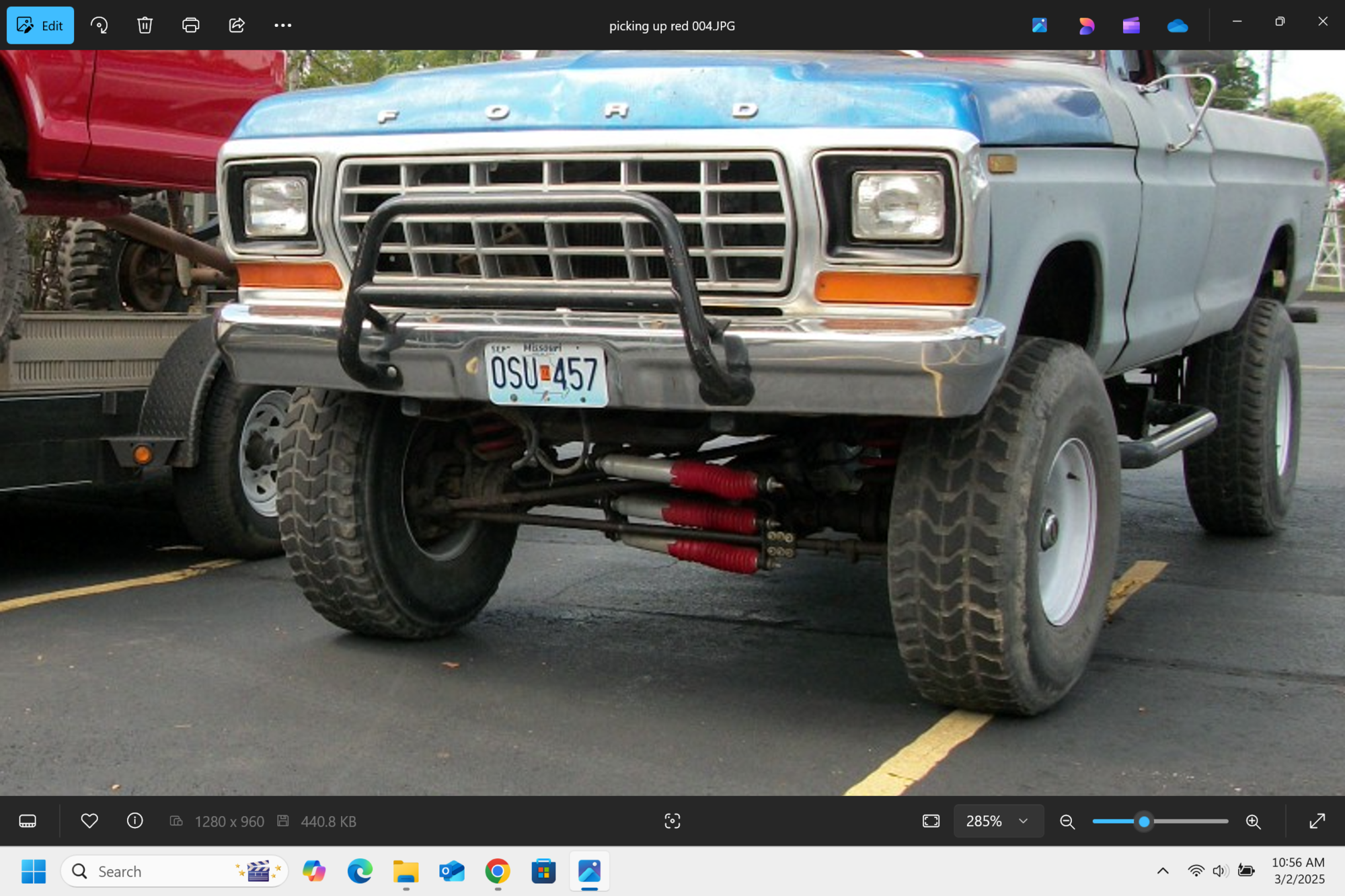

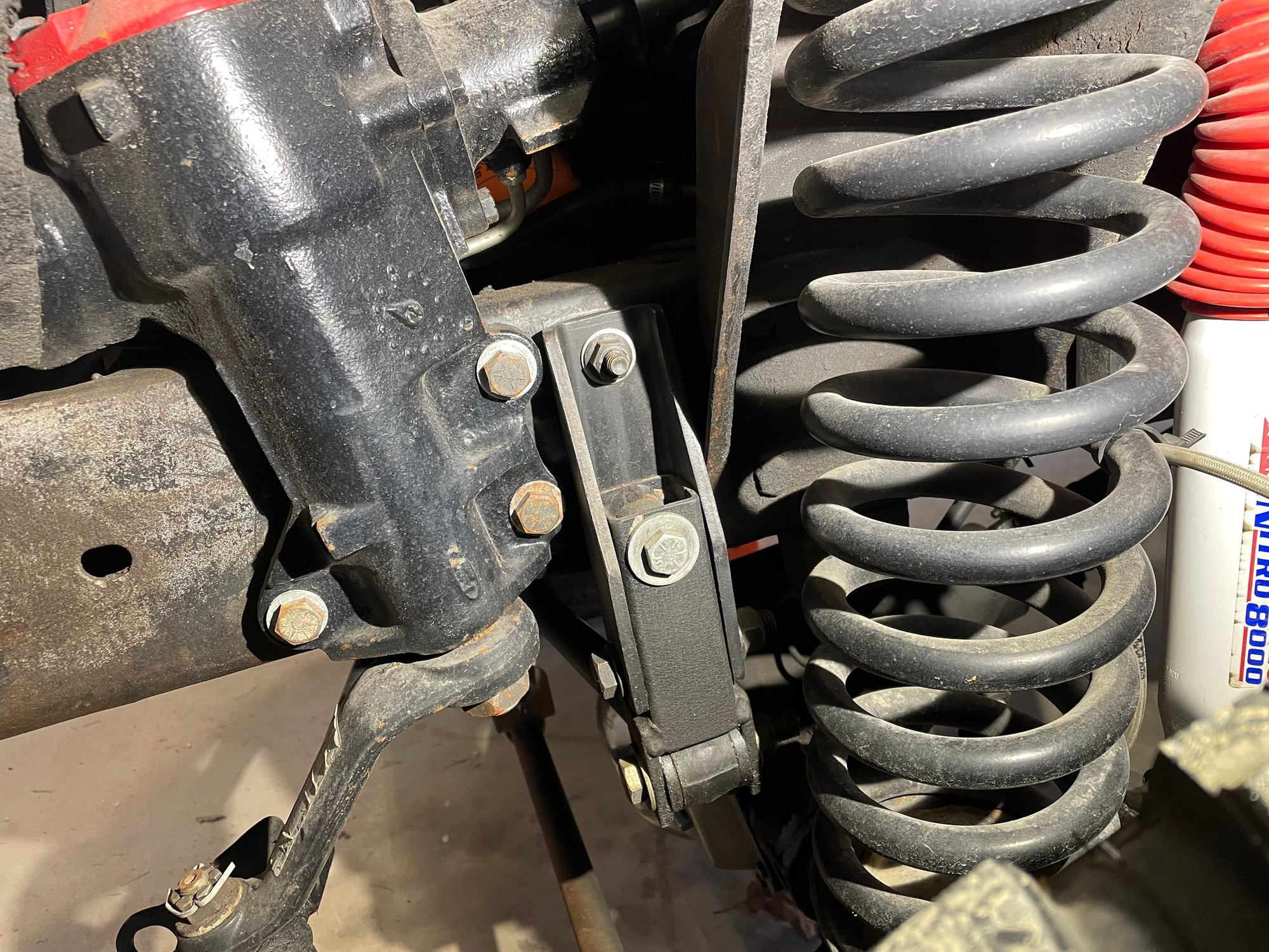

Quick update: truck is actually running dual steering stabilizers. I had taken them off to check them and only had one back on during the pic. The drop bracket fits inside of what I presumed to be the stock bracket. After having the wife work the steering while I lay underneath, it did not take long to discover one of the bolts for the bracket had come loose. Weird since it is a locknut. I will be replacing all the hardware with correct grade and size. After tightening it certainly drove better(obviously). I am putting the 50th Anniversary on the calender for sure. It’s a short drive. And it will give me the opportunity to see my old boss again. Oneton, this was undoubtedly death wobble. The second instance I was prepared for seeing as how the first instance does not leave the memory very quick. I will also make note that the first time you experience it, it takes a person some time to get the vehicle up to and beyond 10mph. I will probably be ordering an adjustable bar early this week. I will keep y’all posted and thanks again for all the help and advice. I have also added a better pick of the drop bracket.

So it does have a drop bracket inside the OEM bracket. IMO the best way to keep a bolt tight, it to get one that is grade 8 and you can lock it down with a cotter pin, after you install a castellated nut. Or do the aviation safety wire method. But that kind of hdwr can get $$.
Bolts https://www.aircraftspruce.com/menus/ha/bolts.html Nuts https://www.aircraftspruce.com/categ...us/ha/nut.html
If one works, then 2 is better, and 3 for a win.

That almost looks like something "Johnny Jackleg" built using a thin wall square tubing, and those thin welded ears just to modify a thicker, much stouter OEM mount. Sure, it's finished nice, maybe even powder coated, but no thanks. Left to right, that mount sees some serious stress. Those tires don't help it. I would expect a dropped trac bar mount to be at least as stout as OEM. Does the tube even have a tube between the sides where the bolts go through, the frame does. If not, you could tighten and torque that lowest bolt going through the frame all day, and first drive it take a few bumps and it'll be loose after that tube crushes a hair.
Nice truck, but there's your wobble.

T-bear I wouldn't be surprised if that squared tubing that is inside the OEM bracket is probably solid stock. They do make a heavy duty version that's solid stock that goes inside and it has ear tabs to mount it outside also and then you can always weld it to the frame at the top. But yes I've seen some pretty sketchy ones made also.

It does have spacers inside of the square tube. But that was my thoughts also. This is actually well executed when compared to the ladder bars I removed from the rear axle. It was 1”square tube about 6’ long attached to the rear axle with u bolts and to the frame by way of a u-bracket welded to the frame then bolted with an additional weld for assurance. If that confused you, yes the ladder bars were welded to a bracket that was welded to the frame. THE LADDER BARS WERE WELDED TO THE FRAME! Thank you for the compliment tbear. It can be stressful at times but I wouldn’t have any other truck. I hate to assume but I guess the adjustable track bars are meant to be used with the stock bracket?

I should of looked closer, now I see the tubing has spacers inside it. Ladder bars IMO are only needed for a pulling truck, high power race truck/mud bogger. Not a DD/ mild off roader. Welded at both attachment point, brain surgeon right there....not.
Yes if you get a adjustable trac bar you can probably ditch the trac bar added on drop bracket...as long as when all said and done the new trac bar and drag link are parallel to each other, in a perfect world.
