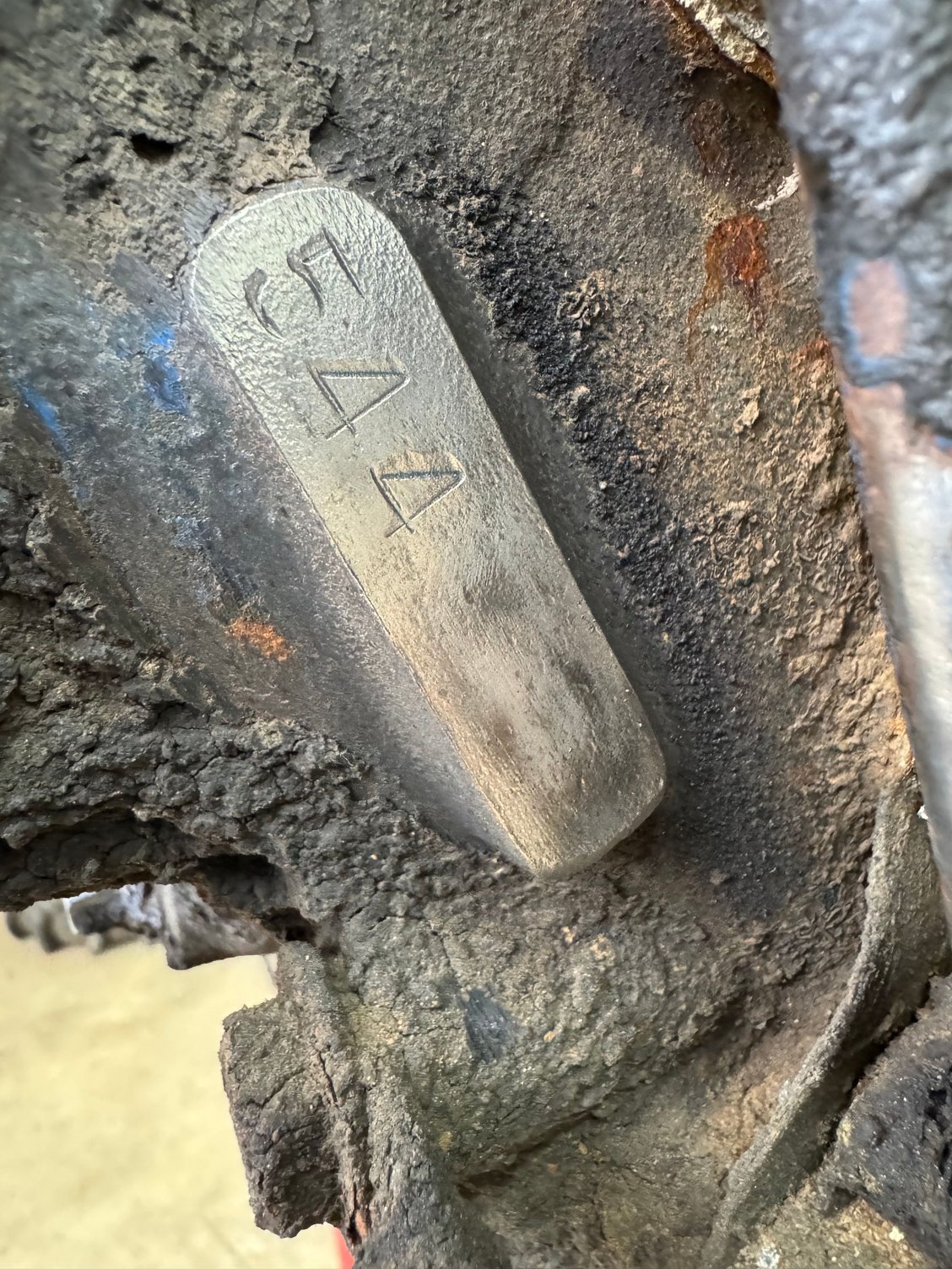

Hey all. I have an older (supposedly 1970) F100 with a 302. I do not have a title, the door and fender tag is missing. I read where the VIN is stamped into the frame, right (passenger) side front around the motor mount area, sure enough I found it “F10GLH94073” but unable to find much detail searching for it. I pulled the engine from the truck, I found the engine VIN “1A100852” and cannot locate any information with it. Can anyone assist on this. My next move is to clean the front drivers side of the engine up to see if I can locate a casting number.

Thanks for the information everyone. The only other number so far I found on the block is a “544” on the front, right upper side. I cleaned all along the right side of the block and cannot find any numbers or letter/number combination. What I’m wondering about is the difference in the early 302s and later 302s. I’m kind of sure it is an early 302 because of the dip stick in the front not on the left side, and yawl confirmed that by decoding that is was built in Atlanta in 1971. Are gasket sets, and things like manifolds, water pump, etc. etc. the same on all year models?

I'm not familiar with the 544 stamping, I don't believe that's a factory mark. It may be a rebuilder code if the engine was commercially remanufactured at some point.
Casting identifiers on a 60's-70's 302 would be found near the starter on the side of the block. They would be on a web near the starter on 80's and newer engines. There should also be numbers on the heads (under the valve covers), intake and exhaust manifolds. You're looking for something that looks like this.
