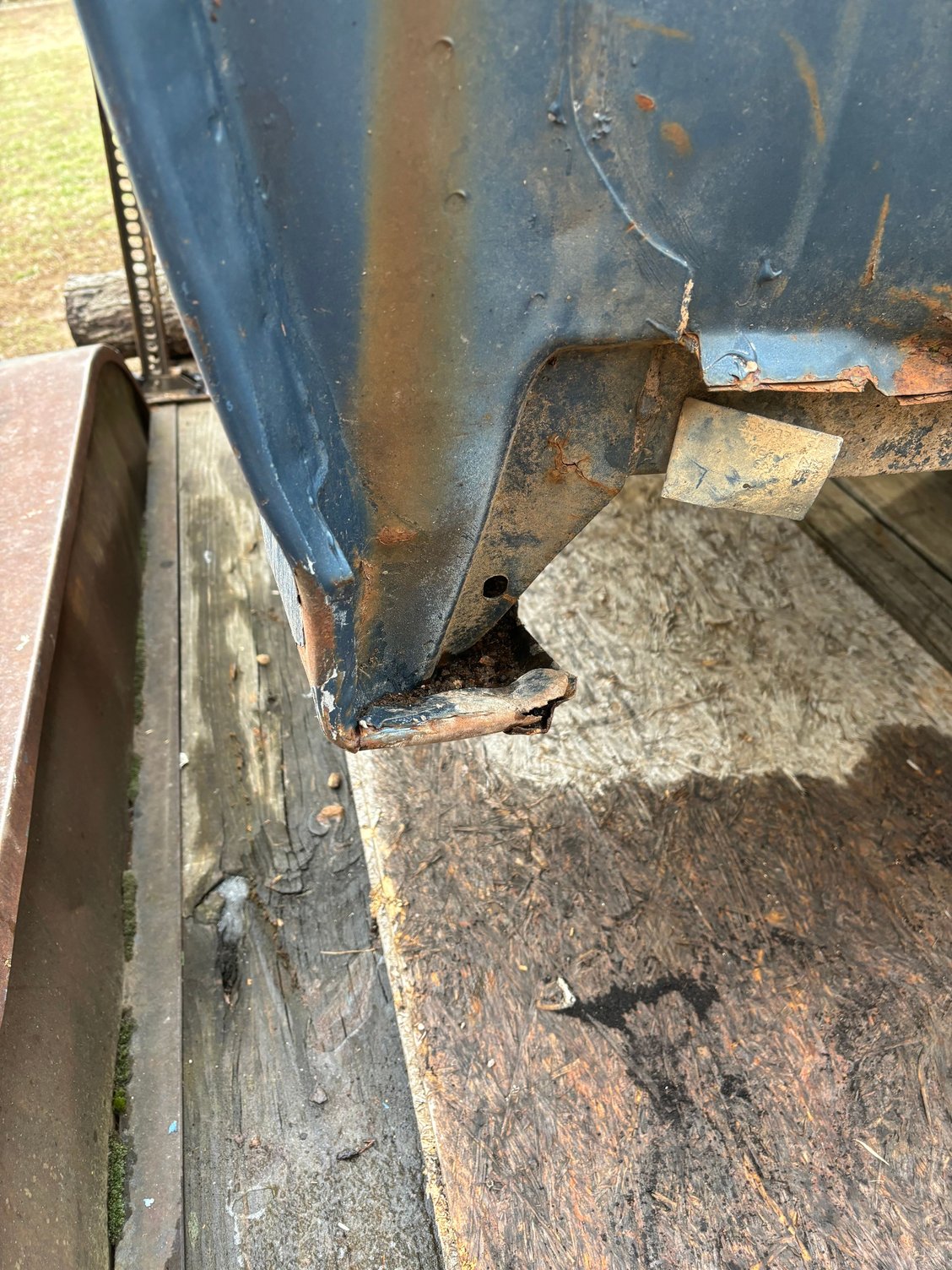

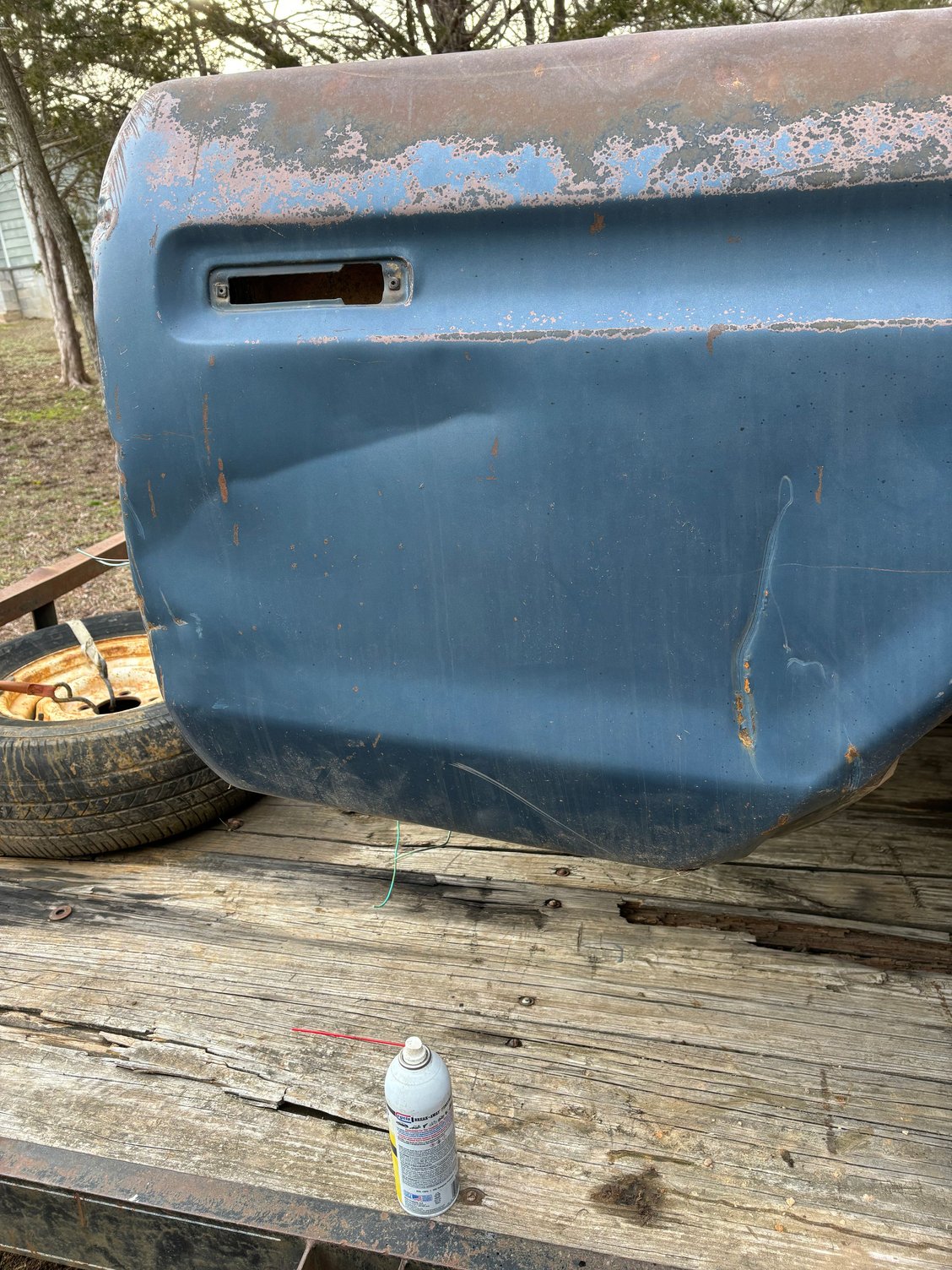

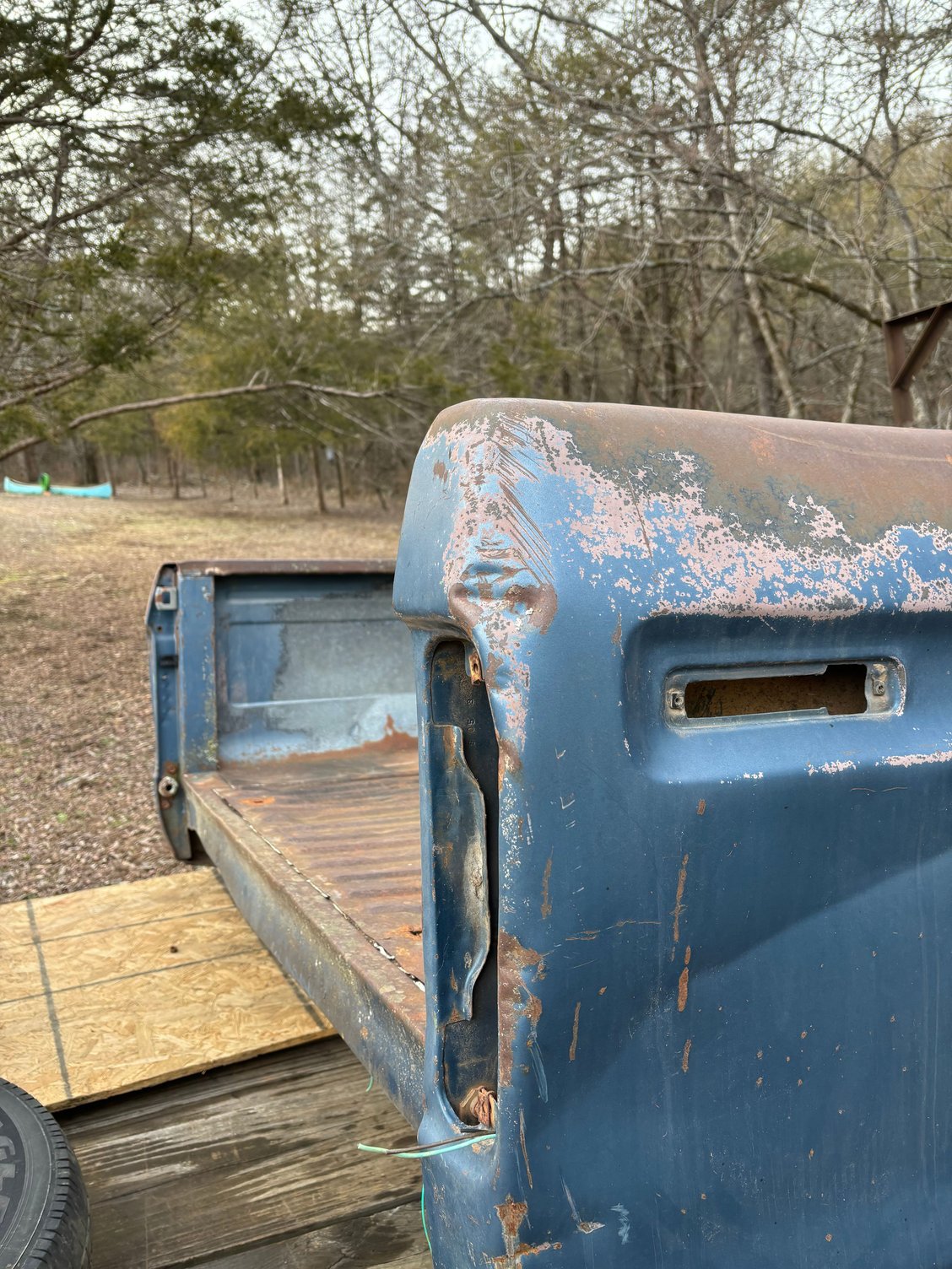

It took a couple days but here’s some pics. All opinions welcome.

I've fixed worse but it would take some work. but so would installing a new side panel.
If there's no rust I'd probably fix it, but the pictures show a little rust and old Bondo? if that's the case maybe a new panel makes sense.

behind that bondo is the only rust on that bed.
I think I’ll try to fix it. Worse case I’ll still have to buy a new side.

Looks fixable to me. Local deputy sidelined as body man in a shop's extra bay once for awhile, I had some worse damage from backing up on a log that kicked up behind right rear tire, he cut / hammered / fixed it, it only bubbled up after 10-12 years Was a cheap fix.

Panel replacement is the go to these days because it's faster and cheaper and the skills required to do good body work are nearly gone.
It can definitely be fixed, it's just going to take time and a lot of work. you're going to need to learn how to shrink metal but it's all doable.

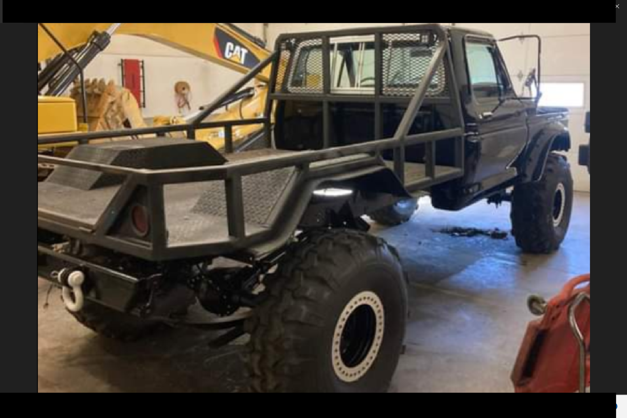

Old Feb 17, 2025 | 08:08 PM
77&79F250's Avatar
77&79F250
Moderator & parts slinger
Posts: 50,193
Likes: 5,793
I would sale of for cheap and put a flat bed on it. Lol JK Just saying there is always options. Like using steel versus rubber for the rear fender flares below.
Old Feb 18, 2025 | 05:01 AM
Ar. Hillbilly's Avatar
Ar. Hillbilly
Joined: Sep 2016
Posts: 492
Likes: 77
From: Eureka Springs Arkansas
a flatbed is a good possibility. 👍
