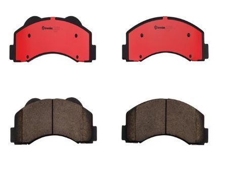

Did you put the correct pads on the inside/outside?
Some pads come with 'ears' that go on the inside so the piston can press fully.
Some manufacturers stopped putting them on, but not all.

The front pads are side specific, as in one pad goes on the inside and one on the outside. Usually they are labeled inner or outer. The pads with the bumps on top (if yours have that) go on the inside.

Hopefully you cleaned everything, and used brake grease on the various points (ie you watched a few videos). Many people make the mistake of the 'ears' mentioned above, I simply do not know if the brakes you chose have them? A slight mild rubbing is normal until a decent drive and a few braking cycles, between brake thickness and rotor thickness, it might just need a short drive. I would place my hand on wheel to make sure they were not getting too hot. If your brake instructions said to bed them a certain way, do so.
Also, did you pull out you caliper pins, clean them and the recess they go in, then regrease them with brake specific grease?
Not so for the power stop pads. They make them identical (no bumps) so you don’t have the issue of putting the wrong one on the wrong side.
