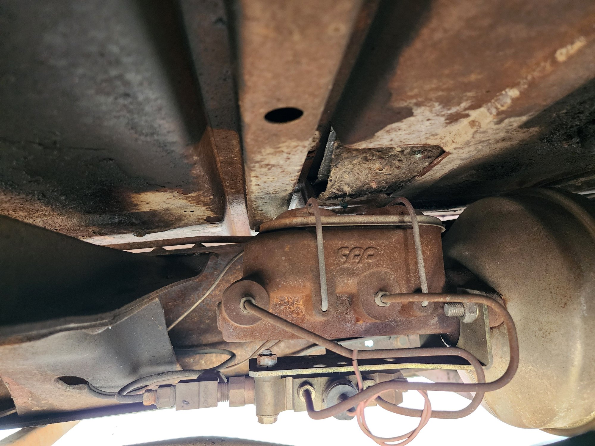

I made a new member post in the Intro sub, but now it's time to start the technical questions!
Just picked up a 56 F2 and one of the previous owners did a front disc conversion (CPP). The brakes are extremely touchy and will lock up the tires if I'm not very, very careful. The brake pedal is still the stock pedal, so I'm assuming the ratio is way off with a manual vs power pedal?
Suggestions on pedal to make it work properly? My wife will be driving it for her new business, and this is really the only thing that I feel needs to be addressed before I'm comfortable with her in it.

It may not be the pedal issue. Can you share some pics on the whole setup? Do you have any proportioning valves? Still drum rears? What is your plumbing setup? Dual circuit master?

Thanks for the reply. It has a prop valve directly under the master and still has drum rears. The rear brake lines are hard tubing to above the axle, then rubber to the splitter on the diff, then hard lined. Front is hard lined to the front, then rubber for the drop to the calipers.
Yes, i see it is leaking at the booster, and the bracket that is zip tied on the pedal looks like its just that way to keep it from rattling
Not the greatest pictures, but here's what I could get. If you want a picture of something more specific, I'll grab it!

The various proportioning valves all look very similar so you may not have the best match for your setup. There are disc/drum, disc/disc, etc.

So maybe I'm overthinking it, but I'm trying to compare pictures with what is on the CPP site and... could these lines be hooked up backwards? Does that matter?

I think they just flipped around the valve. The output on the left side of your picture should be going to the rear brakes. Then there should be 2 outputs on the end on the right side of your picture with one line out of each going to the front brakes.

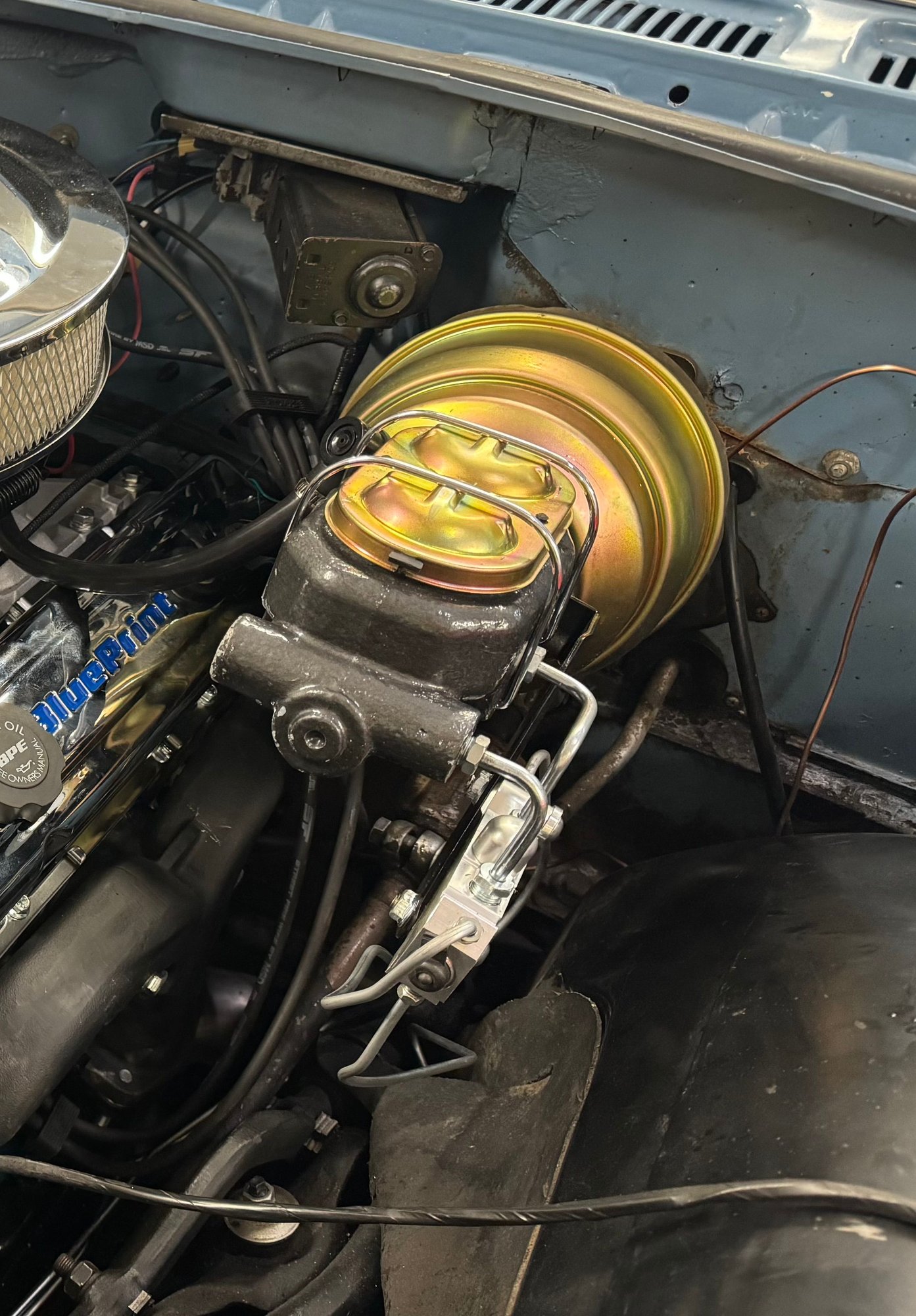

I have a photo of the setup I just did on my Biscayne.
Mine is oriented different but you can see the two lines that come out of the front of my proportioning valve and go directly to each front wheel. Those are fed by the port on the MC that is nearest us in the picture.

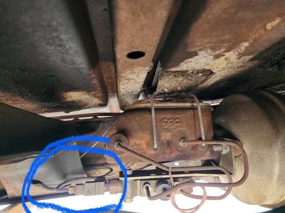

What I just posted is about as clear as mud!
Does the line coming out of the circled part go to your rear brakes?
Yes, it does

The master underfloor is mounted backwards so the rear facing outlet should go to the front brakes which it does .Oil on rear pads would be the first place to start .
