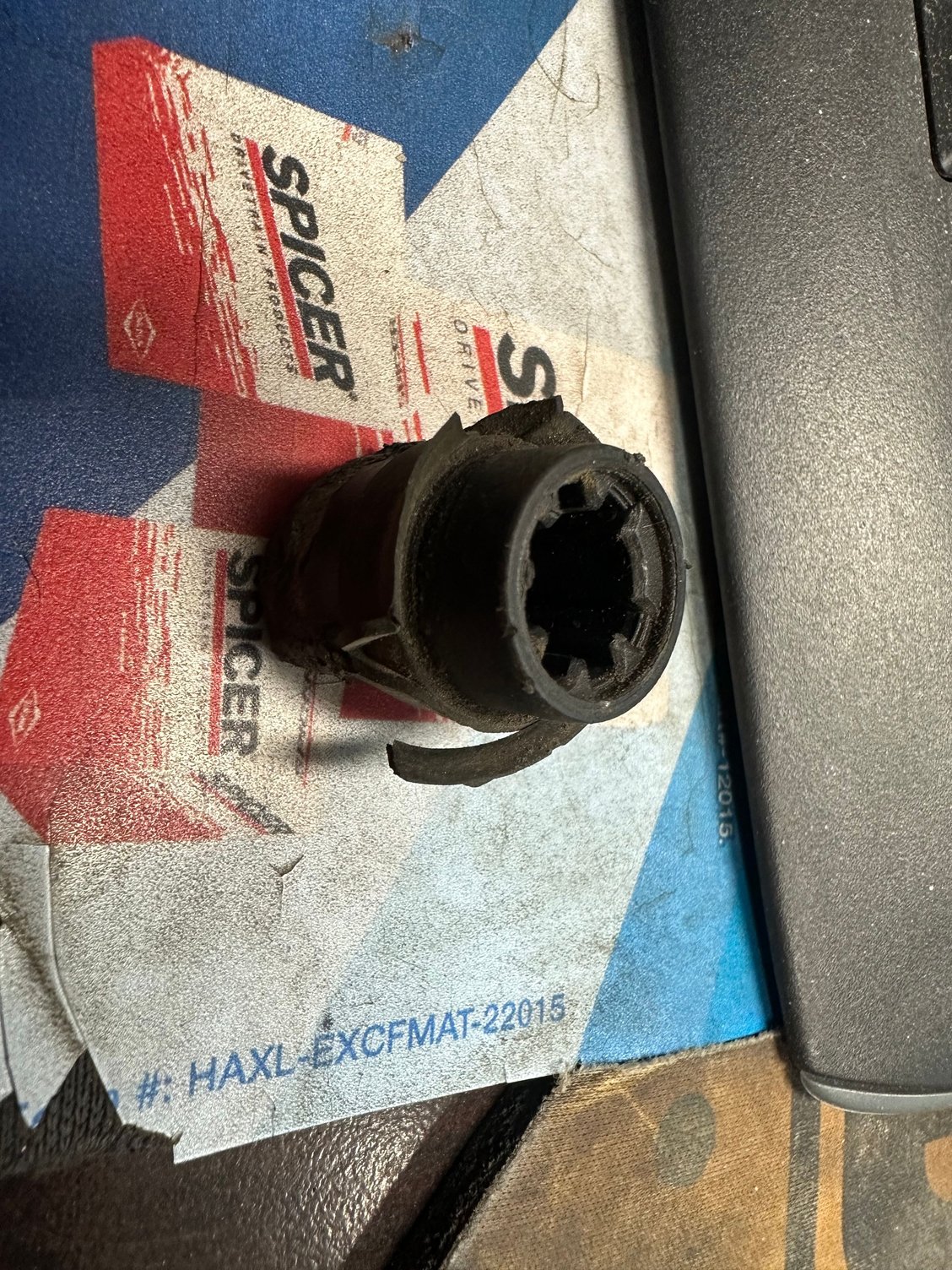

We have a 2013 f250 fan was vibrating. Found a piece in the cage see pick.

Fresh air intake door is broken. It defaults to outside air only when that breaks. Dash has to come partially out to replace it.

Yes it definatly is broken. I was afraid of that.
