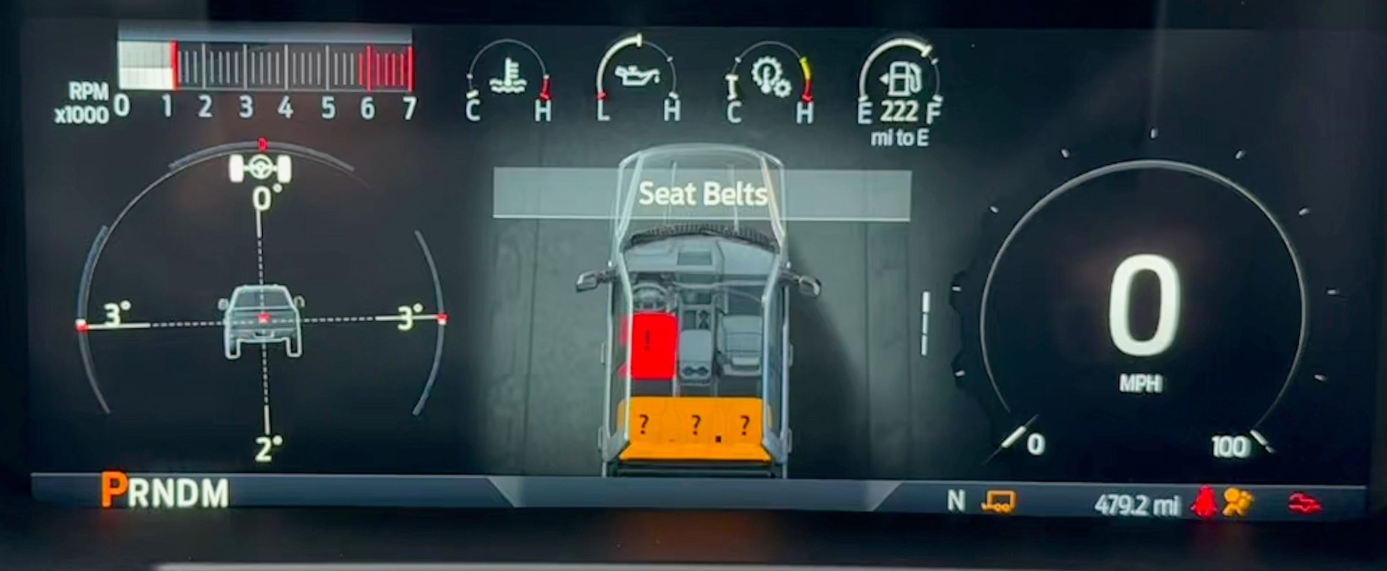

In my 2024 F350 Lariat SuperCab, I removed both (60 and 40) rear seats and simply disconnected the wire connectors that run off the female seatbelt sockets. When starting the truck, I would get two related error messages. First, a "WTF" orange question mark across all three (removed) rear seats. Notice that this symbol is slightly different than the red "put your seatbelt on!" message:

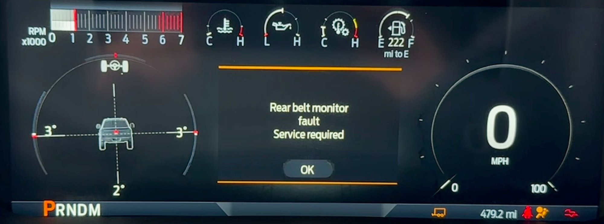

And then a few seconds after this message faded away, a second error message "Rear belt monitor fault Service required":

People here reported success removing the (female) seat belt sockets from the (removed) seat, putting them back in the rear of the truck, and "connecting" them. Not one single post here has qualified what "connect" means exactly, because there are two things that can be connected: The seat belt wire harnesses, and "buckling up" the seat belt themselves.
If you just reconnect all three wire harnesses, then the "Rear belt monitor fault Service required" goes away. And now all 3 rear seats show a red "!" instead of an orange "?".

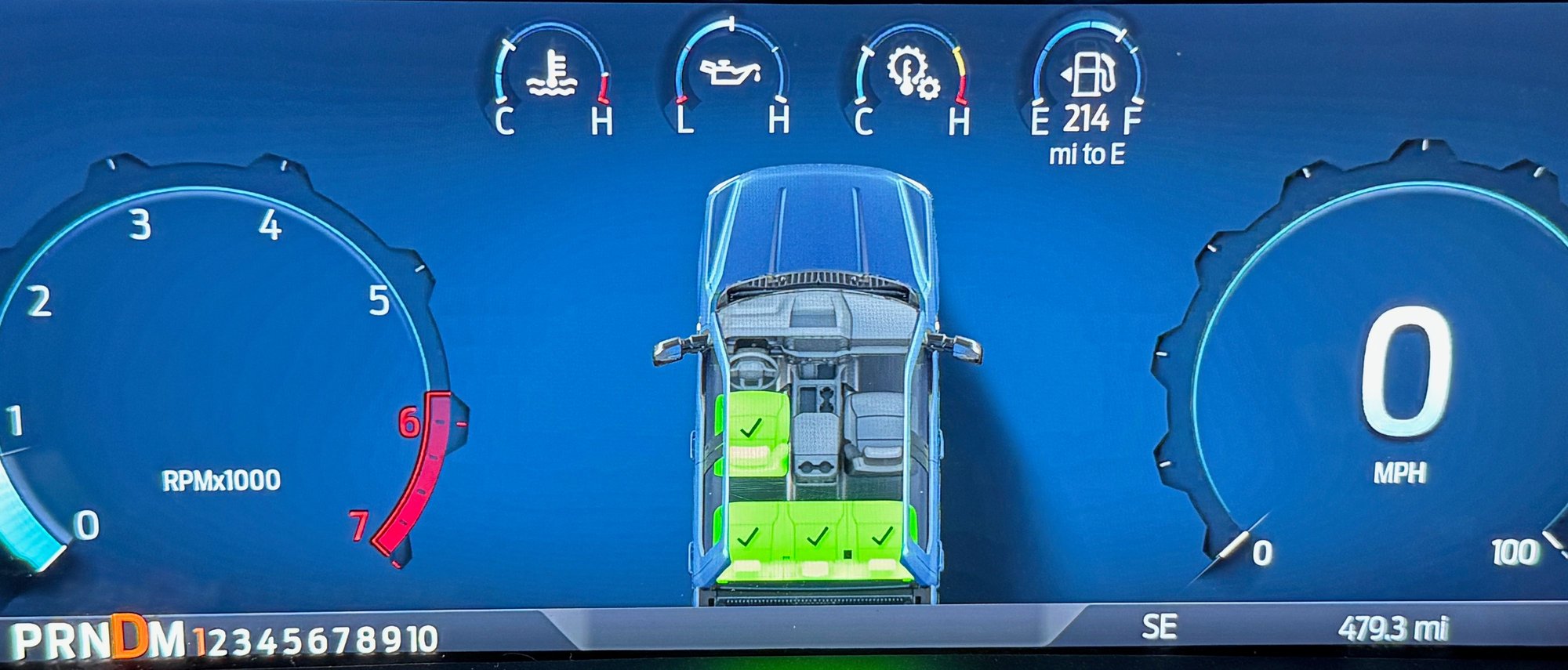

If you then "buckle up" all three rear seatbelts, the red "!" turns into a green checkmark.
This is all expected behavior. However what is driving me crazy is that now, the green checkmark seatbelt status screen shows up AND NEVER GOES AWAY. Even as I am driving around town, there it stays, smack dab in the middle of my console, telling me that why yes, you and your three phantom passengers all have their seatbelts on correctly! I have to explicitly go in and select, for example, "Offroad -> Compass" or some other info screen, to get this screen to go away.
