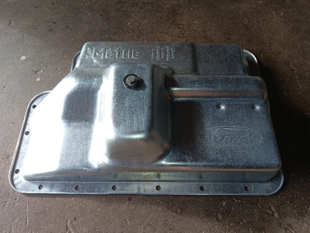

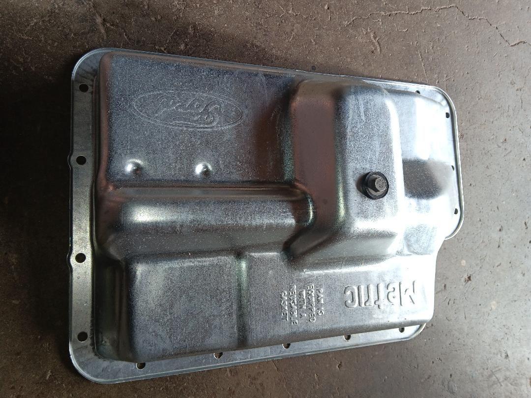

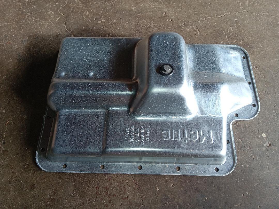

I could not find on here where I mentioned my trucks transmission pan having a stripped bolt or bolt hole. this is the part a member had suggested which I ordered and just recieved:
Amazon Amazon
Anyway, I recieved the pan from Amazon that a member suggested and I am adding pics of it:
It Does have a drain plug though the Amazon pic did not show the bottom of the pan - it looks like a very good eom reproduction, all of the mating surface lays flat agains the concrete floor, no spaces fromany warpage.
Thank you

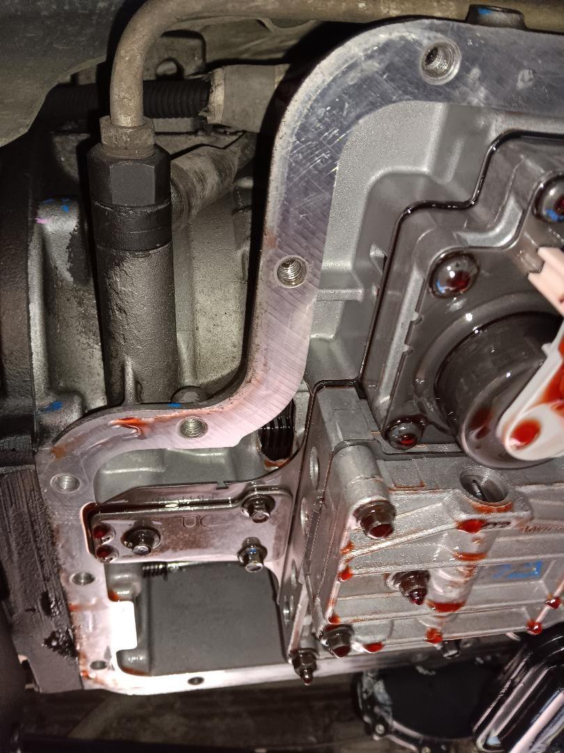

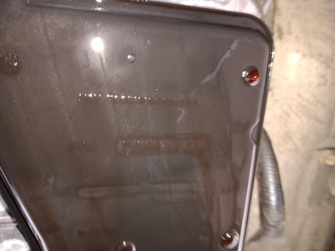

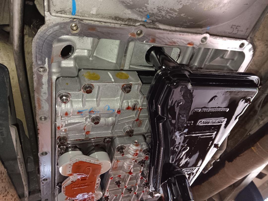

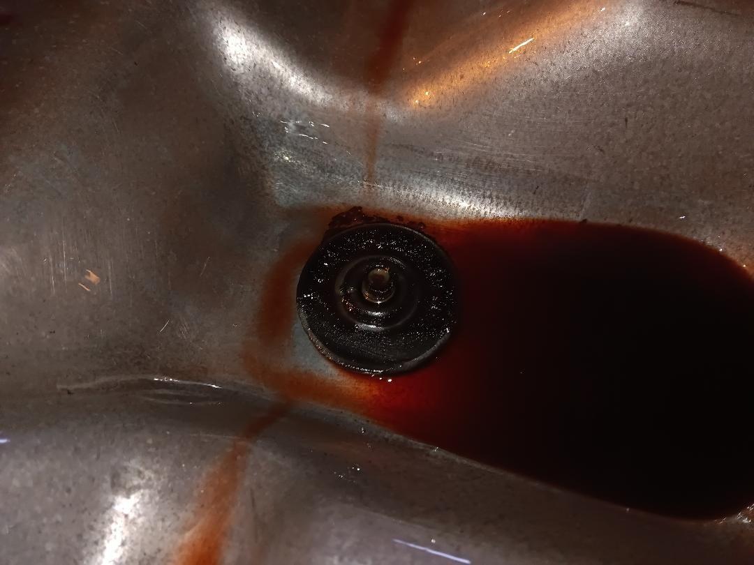

UPDATE:
I R&R'd the transmission pan today. I took some pics of the bottom of the transmission with the pan off, and some pics of the inside of the old pan. The reusable gasket fell off easily and in one piece when I dropped the pan and I was able to re-use that pan gasket.
There was some very fine metal dust type stuff stuck to the magnet inside the pan the amount seemed to be normal, no chunks of any kind and fluid was RED, so it was fresh and had been changed lately.
Both the old and new pan looked like exact matches so the one I got off Amazon was a Good Pan.
I forgot to take a pic of the new pan installed on the transmission. Per an online fluid fill suggestion i put in 6.4 quarts of Motorcraft Mercon V.
On the way back from doing this job and after the trans fuid warmed up I noticed a lot more power, each upshift sceeched the tires and only at half throttle so I think this pan with the Silver Bullet color and aluminum metalflake in the paint was a good choice.
Also... I could NOT get that drain plug to come out of the old pan, it just keeps turning, tried forcing a screw driver into between the pan and the washer but even doing that the bolt would not come out so I do Not know if the Drain Bolt threads or the Drain Hole threads were the issue.
*The owners manual does not say how much fluid to re-fill when dropping the pan only. I went with the 6.4 qts per what someone had reported on here somewhere?
the bottom part of the magnet has been wiped off with my finger
