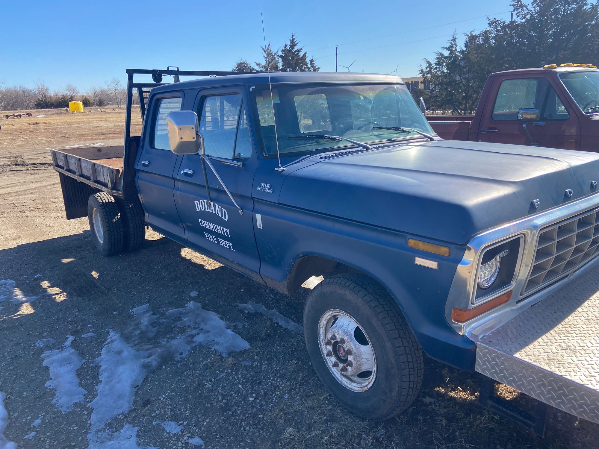

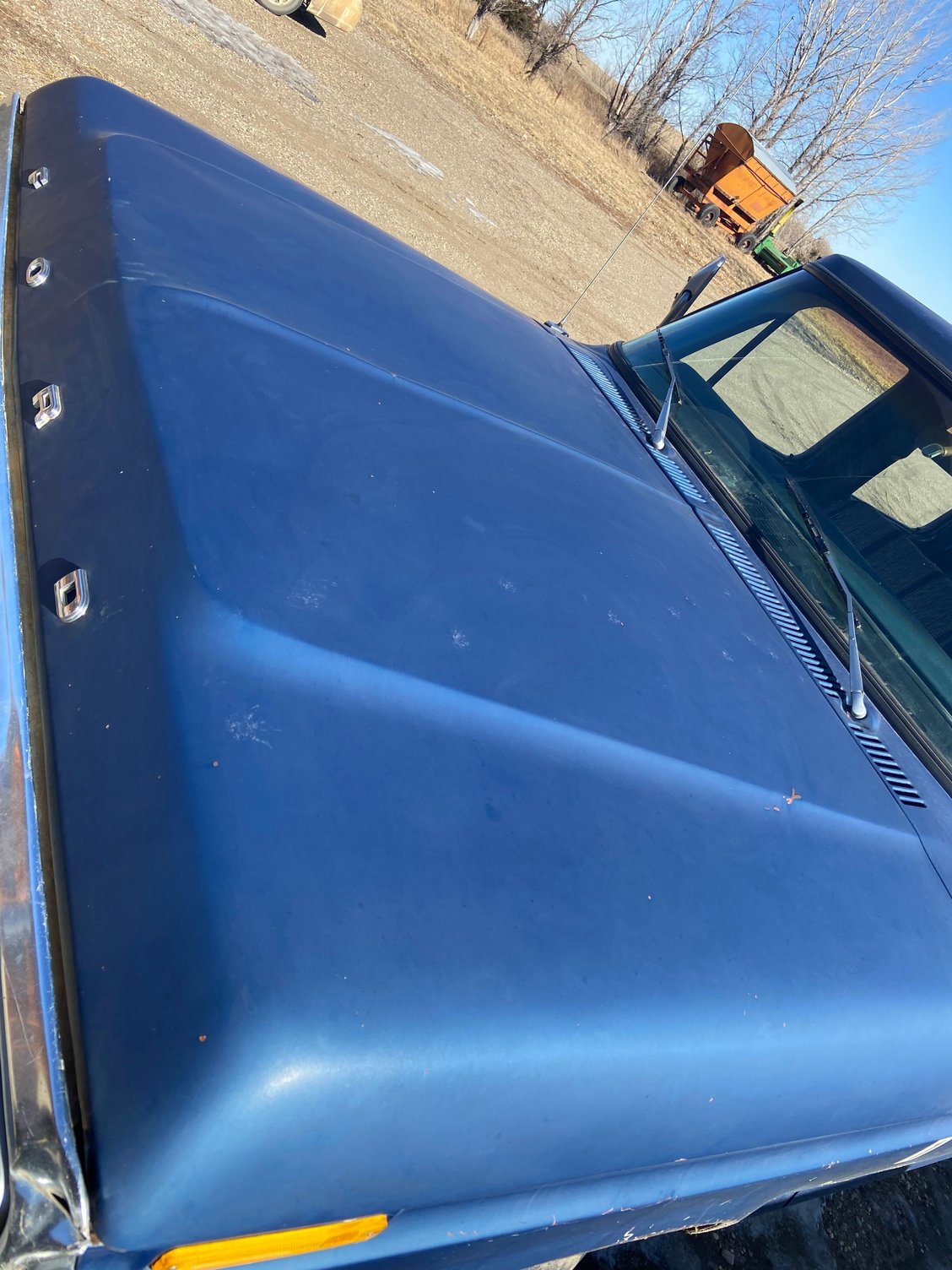

Attached I have pictures of my ‘78 crew cab and as you can see the paint is oxidized. I was just wondering about some methods and/or product recommendations to restore the shine. I’ve read mixed reviews about buffing and polishing, and I was also curious about things such as wipe on clear coats. If anyone has any suggestions or recommendations or can tell me something that I don’t know about restoring the paint on these old pickups that would be greatly appreciated!
Also, side note, any suggestion on the best way to remove the decals on the doors?

There's no substitute for doing a job right. No wipe on product will do the job with any real or permanent success. If you're careful, with a traditional polishing machine, a wool pad and a quality rubbing compound, you can make that truck look like new.

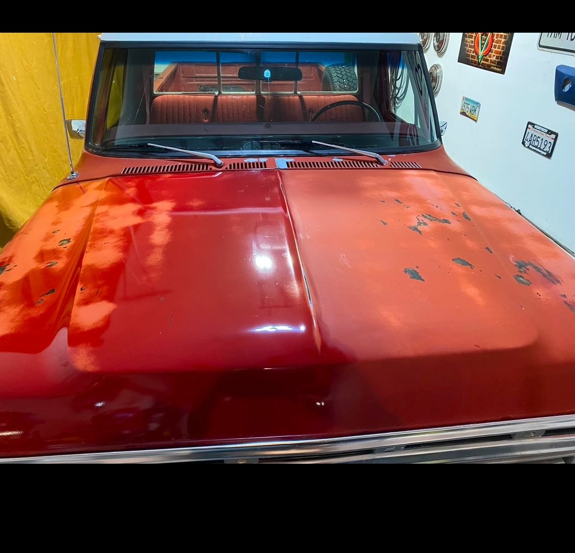

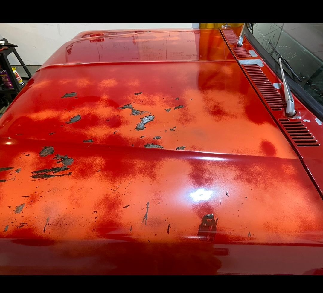

One like this.

I agree that buffing and polishing that paint will make it look almost brand new. It looks to be in really good shape.
i use wizard products, same cost as Meg but a better product in my opinion.
use a DA, “almost” impossible to burn through paint. I do 3-5 passes in a cross pattern, and about a 40% overlap.
