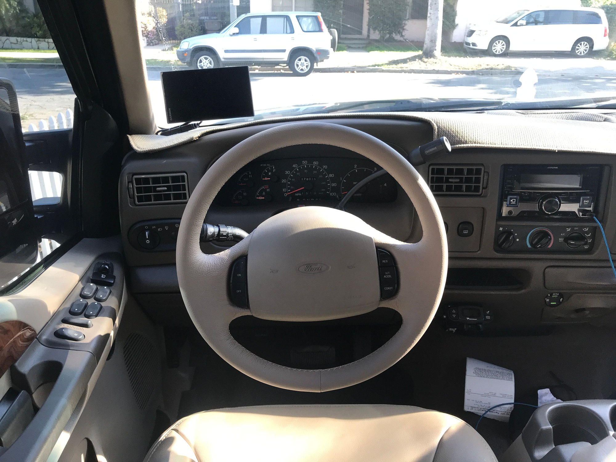

Just had my compressor, condenser and dryer replaced, all OEM parts. The shop supposedly flushed the system and replaced the little micro filters.
While driving home on surface streets I had the air on with the fan at 3/4 speed.
I Have one of those round temp gauges with the long pointed rod, like a cooking thermometer in the center dash vent adjacent to the instrument cluster.. It’s a common type that a/c guys use.
While driving home the temperature variation was 42-48 degrees. It seemed at idle it wasn’t as cold as driving. Outside temperature was about 63 degrees.
is it normal for the temperature to vary like that?
