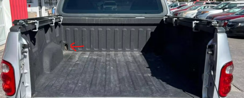

Hi Guys
I have 2003 F-150 and I am trying to find rthe correct name so I can try and find some
Does anyone know the part number for the lights that go here. Or at least the correct name so I can go hunting.
UK based so can't pop into a local Ford dealership
TIA

Those are drain holes. That’s what I’ve always thought. Definitely not lights as those weren’t even a factory option idea until rather recently.
Lights would do no good buried behind stuff once you’ve loaded the bed, anyway. In my Ram, the bed lights are actually mounted inside behind the tail lights, opposite end of the bed.

One guy here told me about an LED cargo light/third brake lamp by Recon I believe. This may work if you require more lighting there.
In my '96, I have installed a 'power port' in the bed where I can run whatever that runs off 12V. An inverter with an LED lamp works great. Charge your phone. Whatever.

The OP's bed light by the 3rd brake light might be burned out and he doesn't realize it. This is an informative post.
It's called the Cargo Lamp.
2003 F150 (f12)
Owners Guide (post-2002-fmt)
USA English (fus)
Lights
Headlamps 2 9007
Front park/turn lamps 2 3157K
Foglamps 2 9145 1
Backup lamp 2 3156K
Rear stop/turn/sidemarker/tail lamp 2 3457K
High-mount brakelamp 1 912
Cargo lamp 2 912
License plate lamp 2 168
Signal mirror lamp (if equipped) 2 906/921
Running board lamp (if equipped) 4 168
