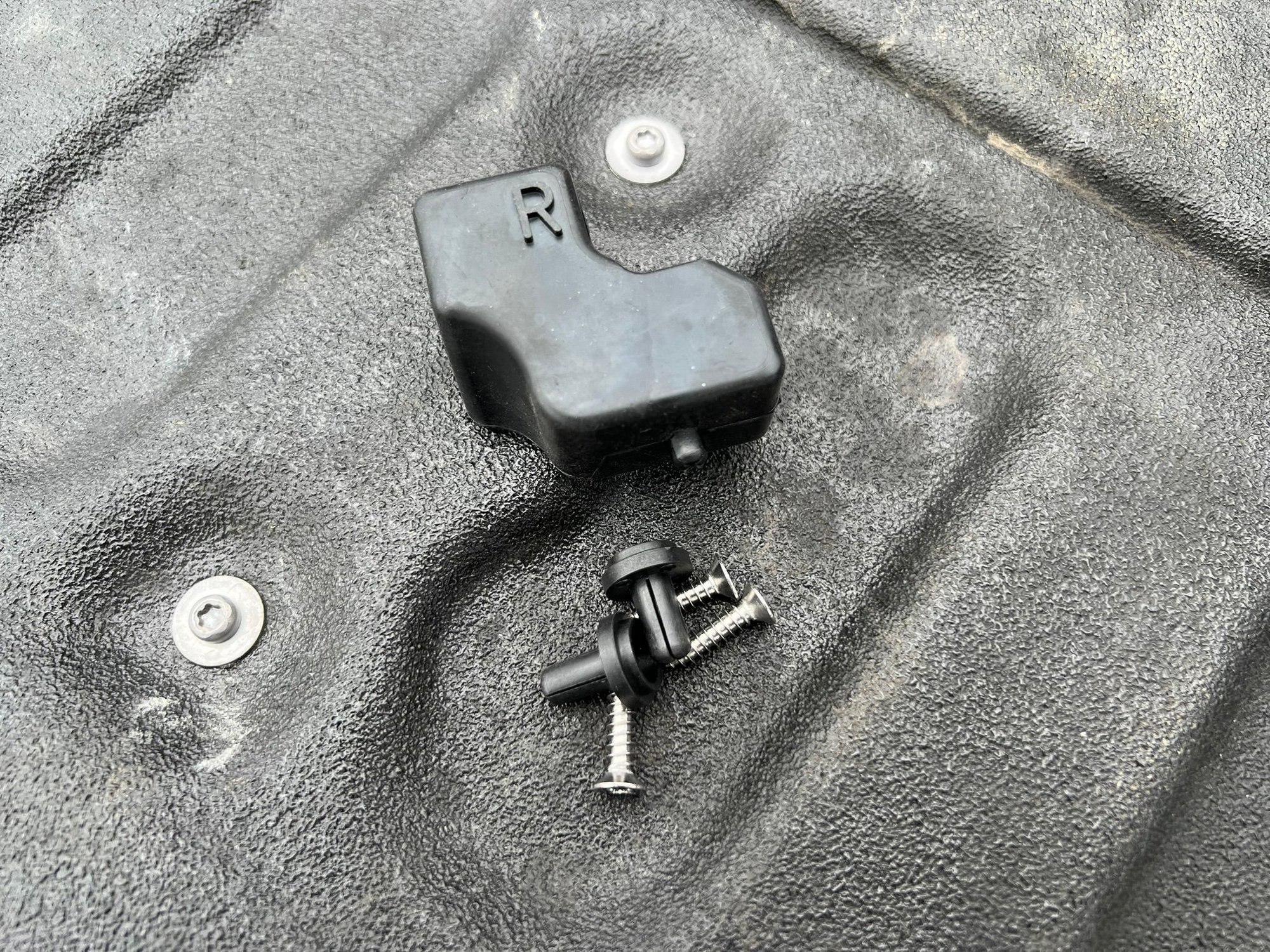

It’s there to protect the tailgate when you slam it shut and helps reduce vibration from the tailgate. Just because you can’t hear it rattling from the cab does not mean it’s not moving. Some have claimed that it also holds pressure on the gate and makes it easier to pop open when you release the gate. It’s not made to last forever as it’s just rubber. It’s only held on with a push rivet to make it easier to replace. Most folks lose them because they hit them with stuff when loading the bed with tailgate down and may not even notice.
As far as the stop not doing anything and it’s not needed. Do really think Ford would spend even one cent on something that they would not deem as a necessary part. They go over each model year in an attempt to cut costs and yet these “not needed” parts survive the cut every year.

Mine fell off about year1/2 ago , ran a Molly through it and it’s good to go , prolly caught a ladder or cord or something on it , the other side still hanging on for dear life , good thing I bought a pack of two mollys

It's sole purpose is to keep the tailgate from moving when latched in place. It actually helps keep the latches and hinges from wearing when going down rough roads, which is like 99% of them, since it prevent the tailgate from bouncing and moving side to side.
ONE plastic clip though? Geez.

I used a M6 rivet nut, aluminum, with a M6 socket cap. Works great. The plastic push pin Ford used is a joke.

I got my Amazon upgraded bumpers today and at first I thought no way, these hardly stick out and won't be any better. But they did tighten down really snug so we'll see. Way tighter than my home-made drywall anchor fix did, that's for sure.

Interesting, ford gives you a left and a right tailgate bumper those are ambidextrous🤦🏻

Well, I didn't have to order any, just have to get the screw and anchor for the stock one.
