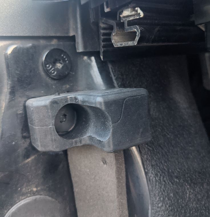

Hi All,
I found my right tailgate bumper loose over the weekend and saw that the pin that holds it in place was damaged. Where might I find one of these retainer pins?
Thanks!

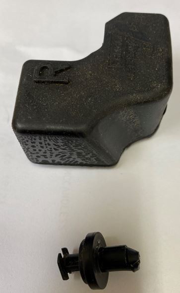

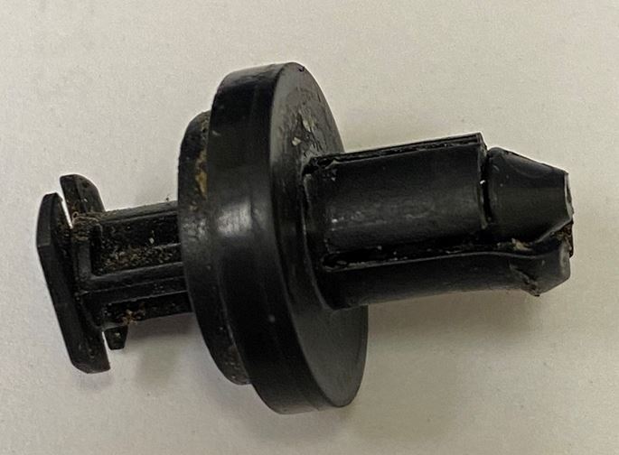

I opened my tailgate to find the right side bumper laying in the bed. I looked at the other side and discovered that bumper was gone. My younger brother has a 2018 F-150. We opened his tailgate and he had one in place and one completely missing. After looking at the Ford parts cost and the crappy plastic rivet they used to hold them in place I headed to Amazon. I found these "on sale" for $13 with 1 day shipping:
Tailgate Bumpers On Amazon Tailgate Bumpers On Amazon
They are EXACTLY like the factory units - except they moved the L and R letters on the rubber. I compared mine to my brothers - they definitely have a different contour to them. Not sure why Amazon says they don't fit my truck because they are exact replicas. I bought the plastic rivet two pack at Home Depot for $1.24. I had to trim the plastic rivet head with a pair of wire cutters so it would fit into the rubber bumper. It is much sturdier than the original rivet. I threw the new rivets they shipped with the bumpers into the trash. No more tailgate rattle when off-roading or on rough streets.
