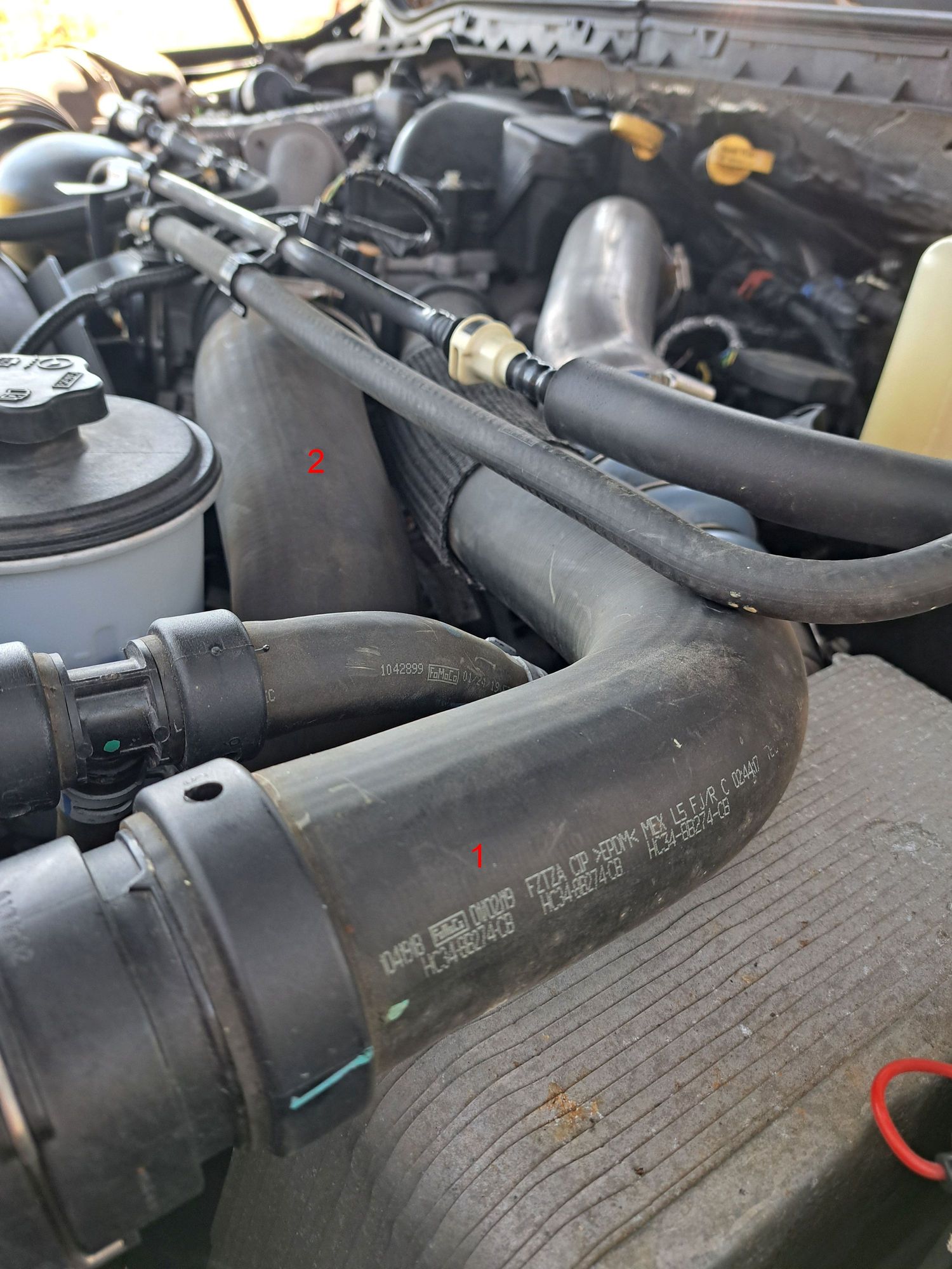

@04badford I checked the turbo hoses this morning. Not sure which one is the upper boot to the turbo but searches for that product name always to lead to the one marked as 1 in the picture. I couldn't find any splits in #1 or #2. Both are in great condition.. Everything in the entire area very clean.
I've checked this high idle thing twice today at 60 and 75. The spin up to 1000 is like clockwork again today.
@4wd6.7L That service bulletin SSM 50636 is one thing I found last night. It makes sense but doesn't seem to be the same thing my truck is doing. I suppose it could be applicable but wouldn't that mean my truck has an unsatisfactory amount amount of unburned hydrocarbons after 55 seconds of idle? Or maybe the previous owner had somebody figure out how to modify the PCM for an automatic high idle? I understand he's a bigtime contractor who used it for his mobile office. People down here in Lower Alabama love our AC.
Anyways, for the other ideas on cause of this, the climate control was turned off and I very rarely let any automotive battery go down below 70% SOC. Although the temps were down in the teens the week before last, the cold is long gone for a while.

It’s the center hose you have a red dot on , check it when the engine is on , if there’s a split you’ll feel the blow by.

No red dots, there are two numbers on different hoses.
