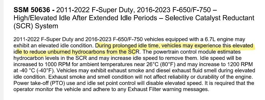

Or the real reason.....

Is it? I don't see any reference to "wet stacking" or anything about engine wear in the Ford SSM. It reads to me that the purpose of the elevated idle is to address hydrocarbon levels specifically in the SCR. Is that exactly what you posted? By the way, I don't drink Bud Light.
