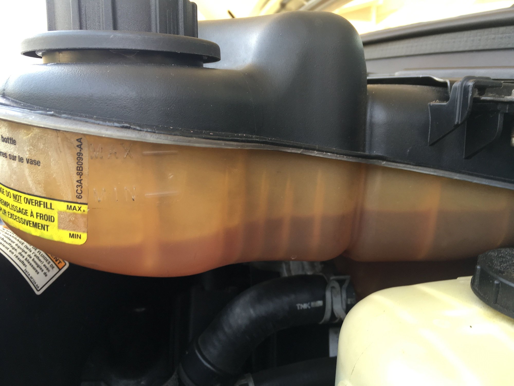

Keep your degas level (cold) about 3/4 to 1/2 inch below the minimum line.

If the coolant level in the degas bottle is too high, IT WILL PUKE. Reason is that liquids expand when heated (it is an expansion AND degas bottle).
The level I posted is for cold fluid. I actually keep my level a bit lower than that.

I’ve always had mine at the level mark, may have had something to do with things, as I think I’ve had faulty caps as well.
