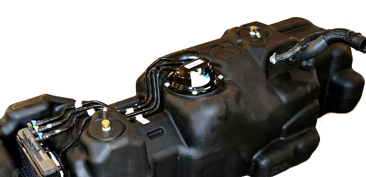

I stopped topping off like that when a rollover vent valve failed and spewed diesel all over the place. They sit in a cavity at the very top of the tank and supposed to have a small air bubble to allow air to enter the tank ans fuel is used and seal up when rolling over to prevent fuel from spilling. Topping off to the neck of the pump can also fill that cavity and cause fuel to come out the vent.
Those brass looking things are the vents.
epa allows open air venting
I had no idea.
Thought it vented via some port in the system
thanks

Diesel doesnt vaporize like gas does. Gas turns to an explosive vapor, hence the use of the vapor recovery system, it prevents the cars from going BOOM on a hot day, but diesel doesn't form explosive vapors nor puts any fumes in the air, so it is allowed to vent to atmosphere.
