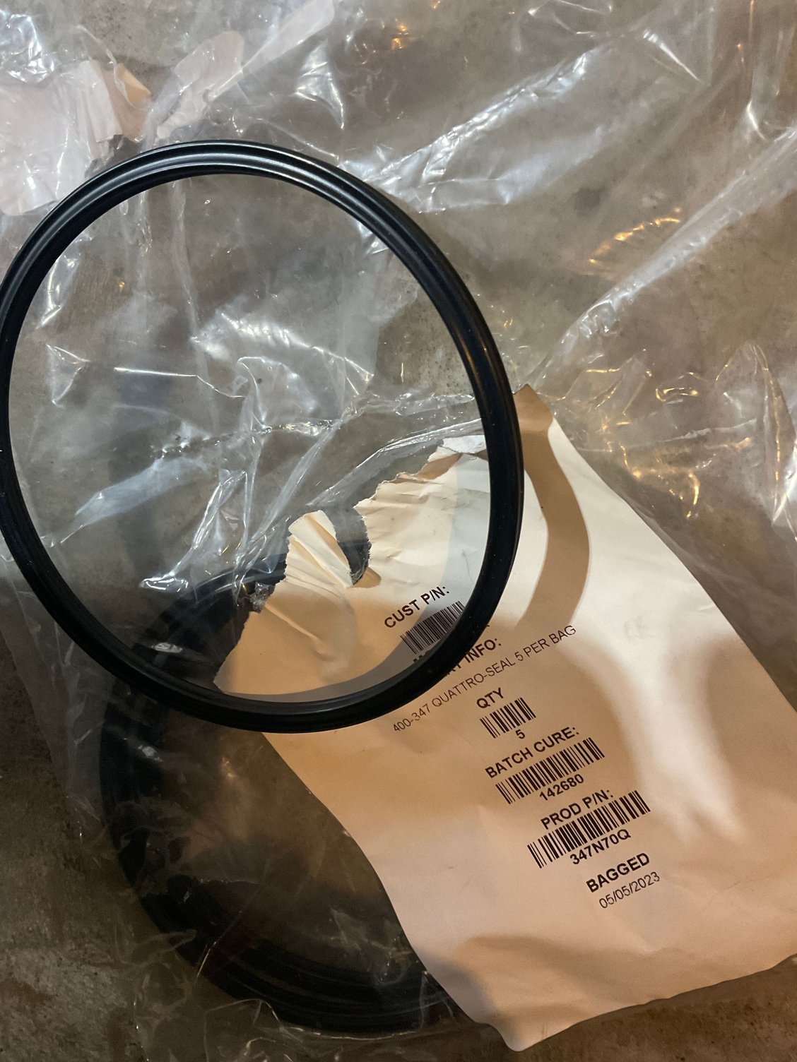

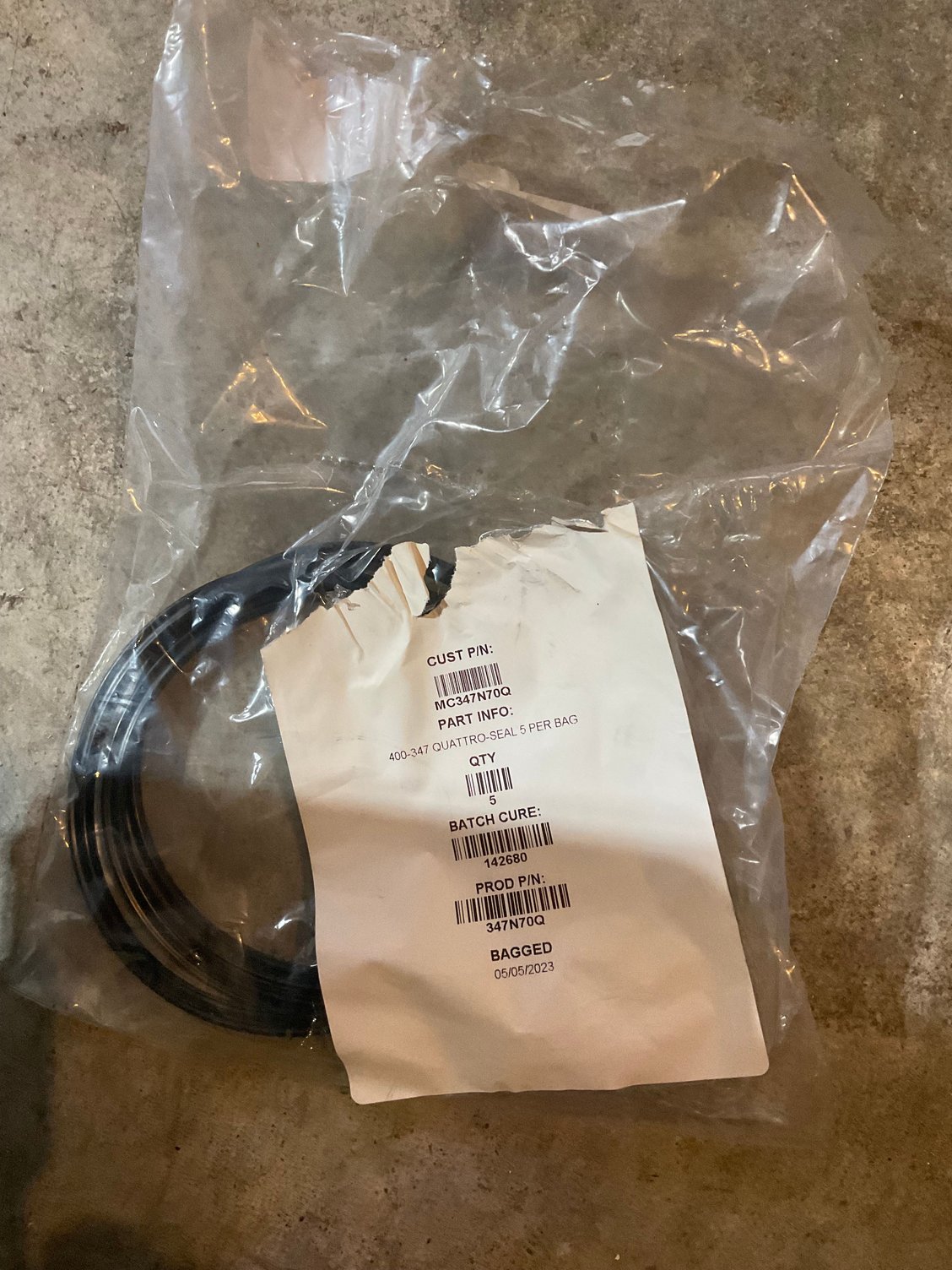

I got a bag of 5 dbl lip rings from McMaster carr. I'll post a photo of the bag shortly.

Been a few days but here’s the dbl lip oring I use. Got them from McMaster Carr. Originally got them for my 7.3 van but have since used them on the truck too. No more fuel leaks and chasing those leaks in the vans is tough.
