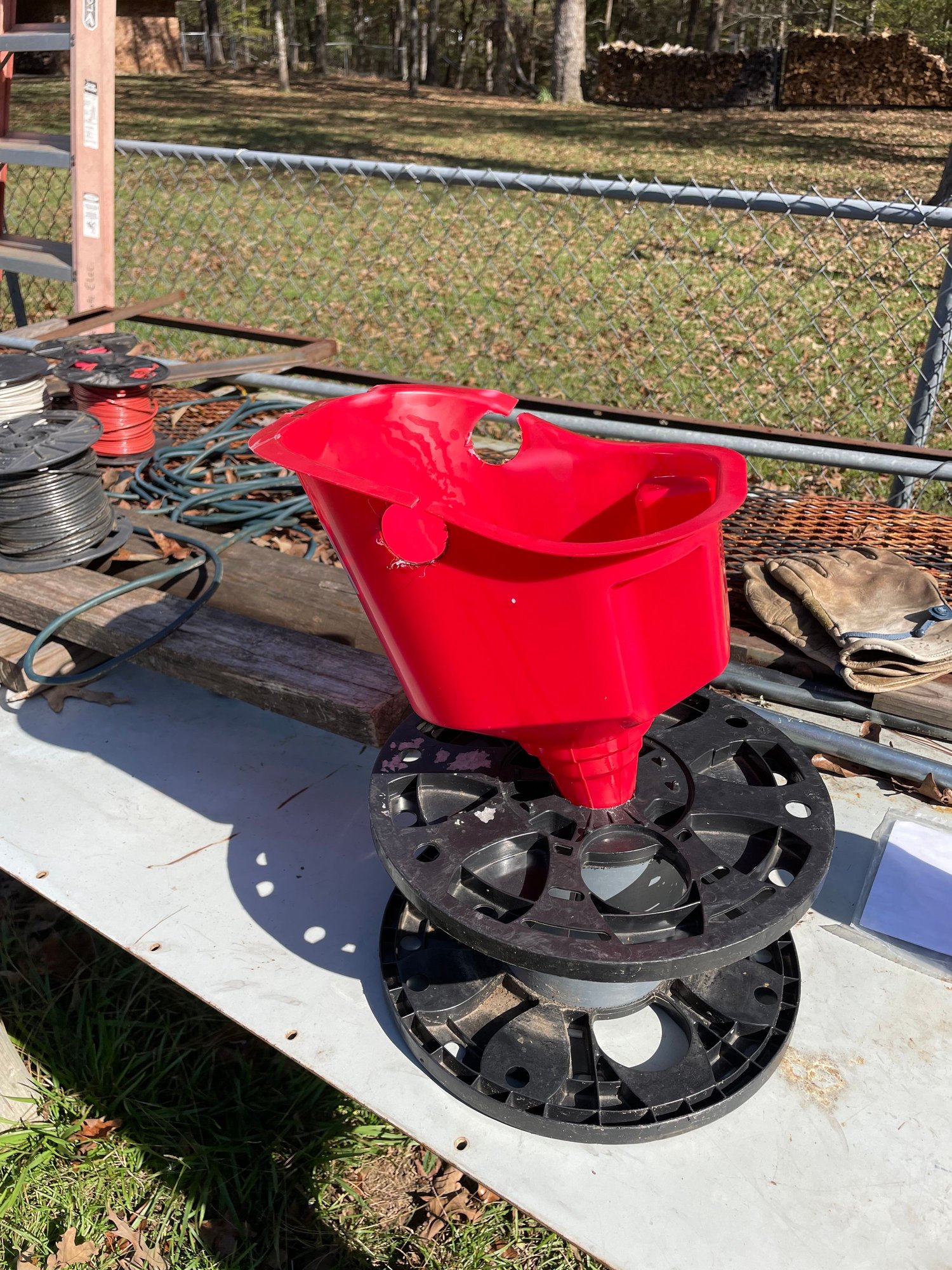

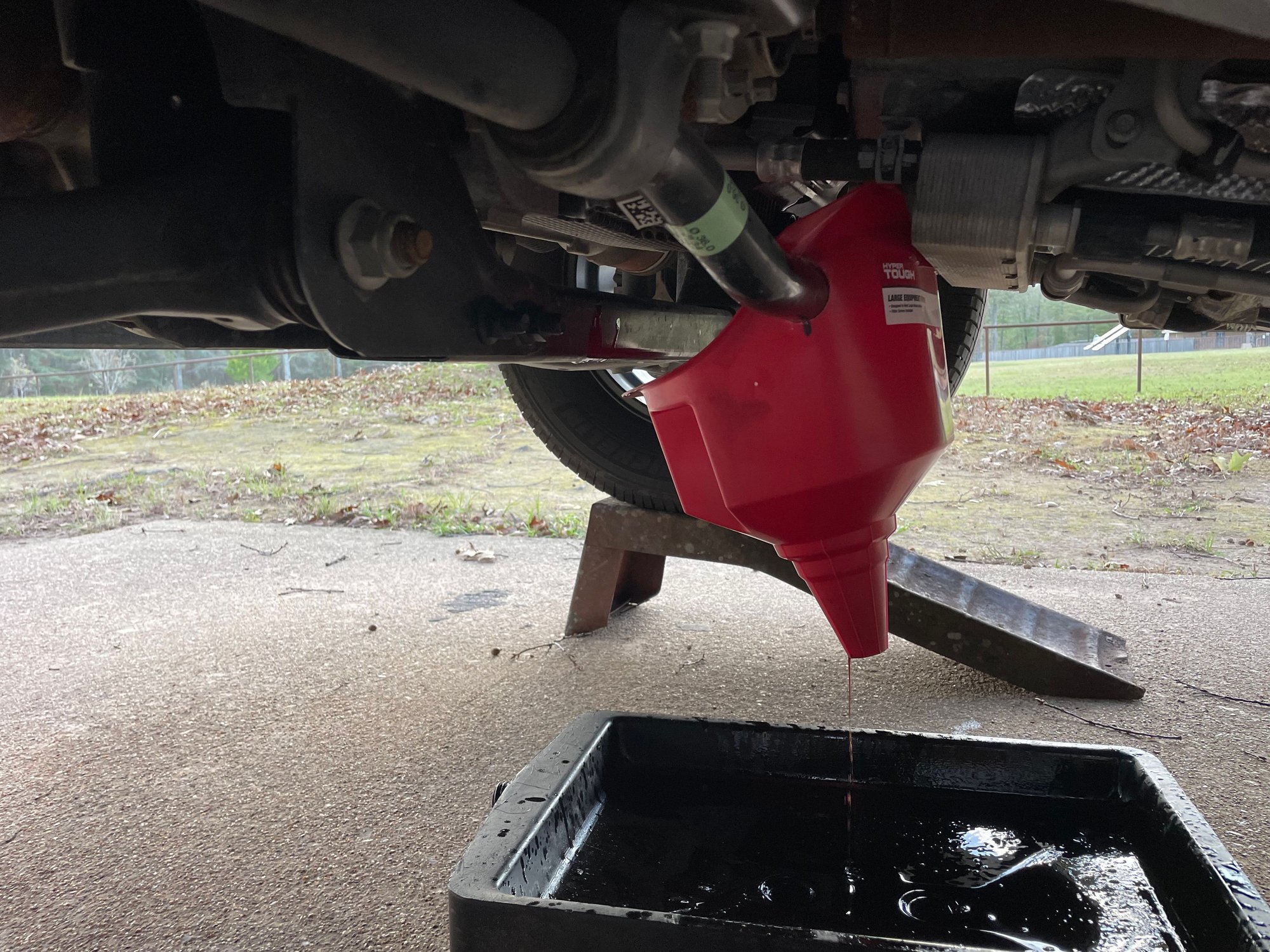

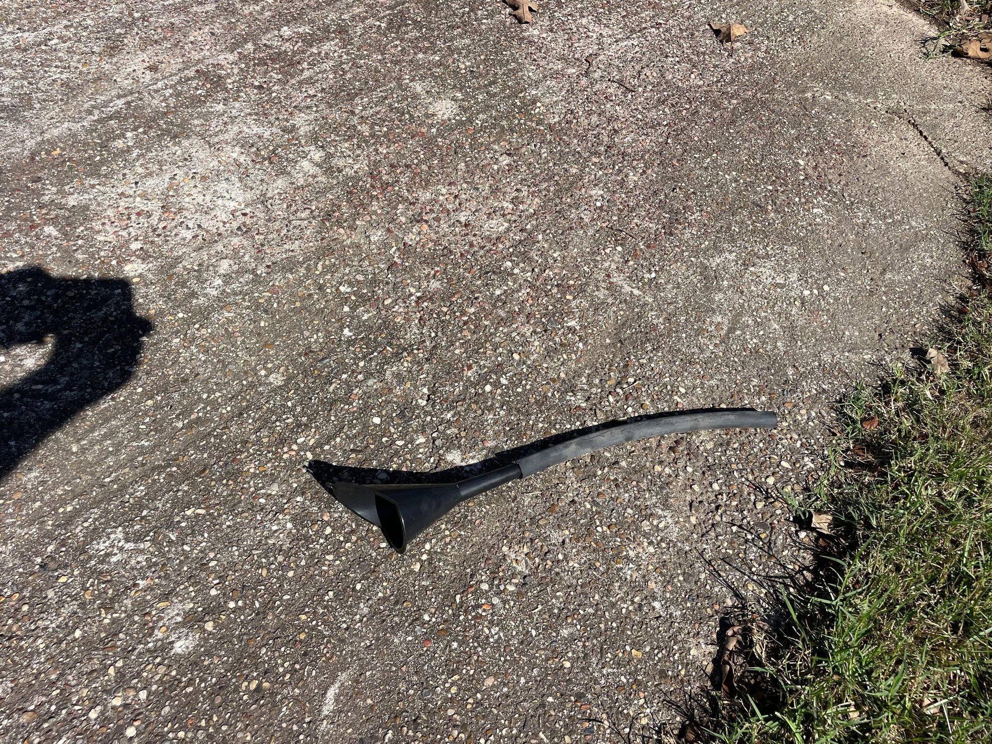

2020 5.0 The drain plug can be hard to turn.
I have to use pliers to get it started. Here are my solutions to reduce the mess. The funnels came from Walmart. The small one goes on the rear filter drain. With the truck on ramps, the filter oil all ran to the rear drain. The red funnel was modified using a hole saw sized for the sway bar and snips to allow it to snap on the sway bar. I had to loosen the drain plug before I put it on.

I like your idea! Mind if I copy it?
Old Feb 1, 2025 | 07:22 PM
Cliffblue's Avatar
Cliffblue
Joined: Mar 2021
Posts: 61
Likes: 15
From: NW Louisiana
Please do. The funnel will splash in the drain pan some. Good luck.
