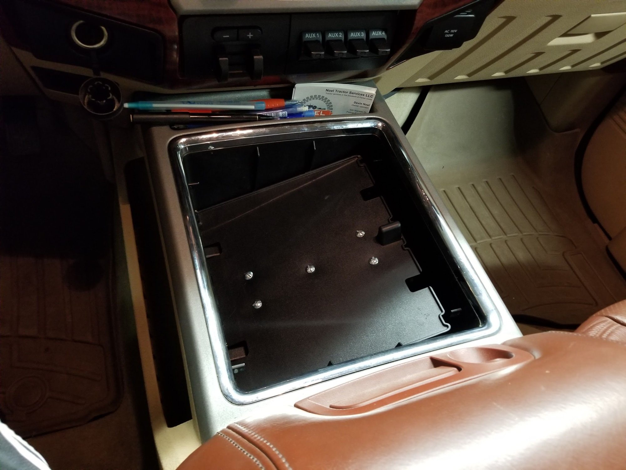

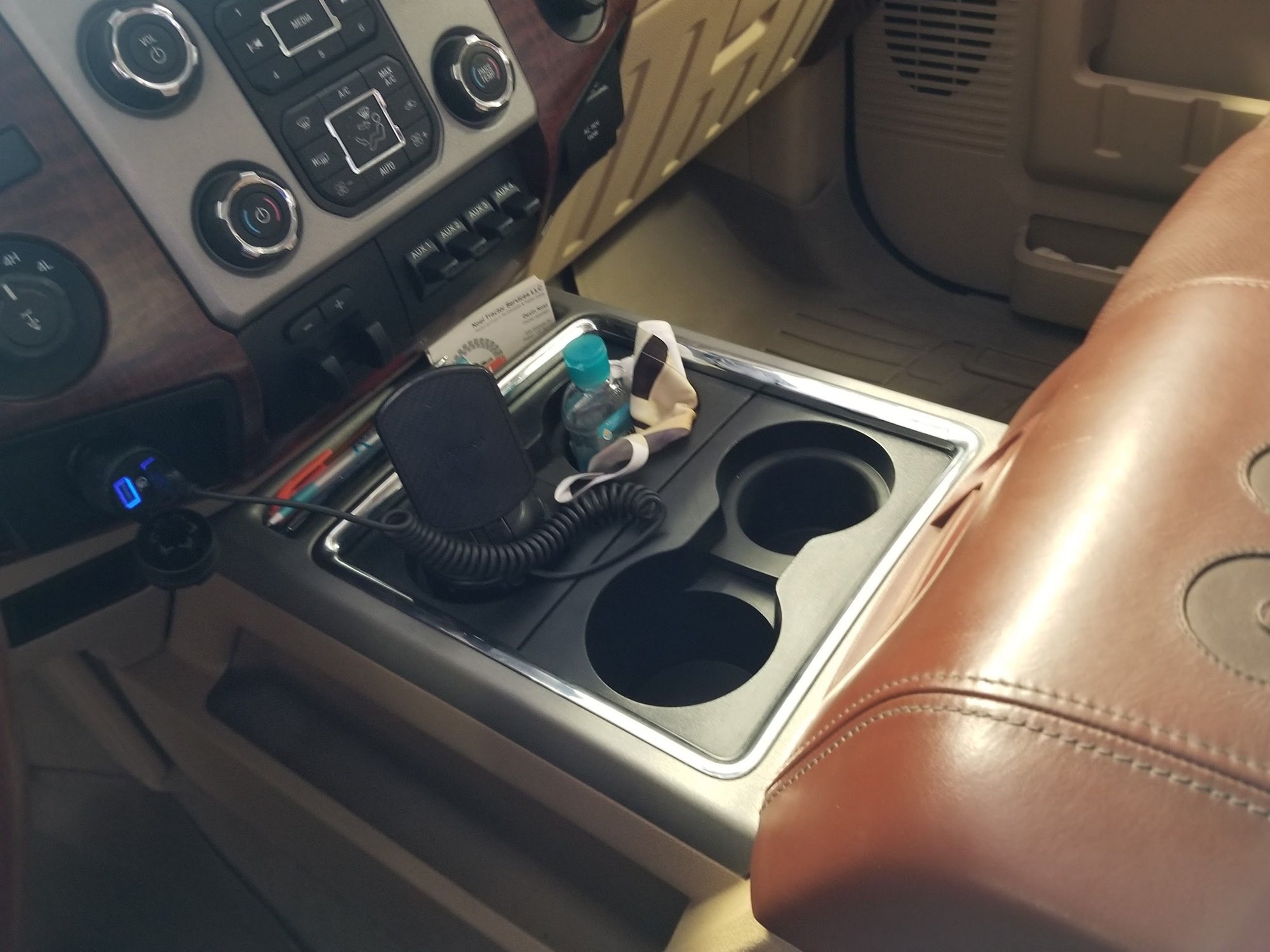

In my 2014 I mounted my Yaesu FTM-400 under the center console cup holders. It had a remote head unit I mounted to the dash with a RAM mount https://www.lidoradio.com/products/1...000-and-ft-891 (or something similar). It was easy to pull the cup holder out, just grab & pull. Plate under them was easy to remove as well. I nicked the vent pipes when trimming under the sub-plate so the main radio would mount & patched with aluminum HVAC tape.

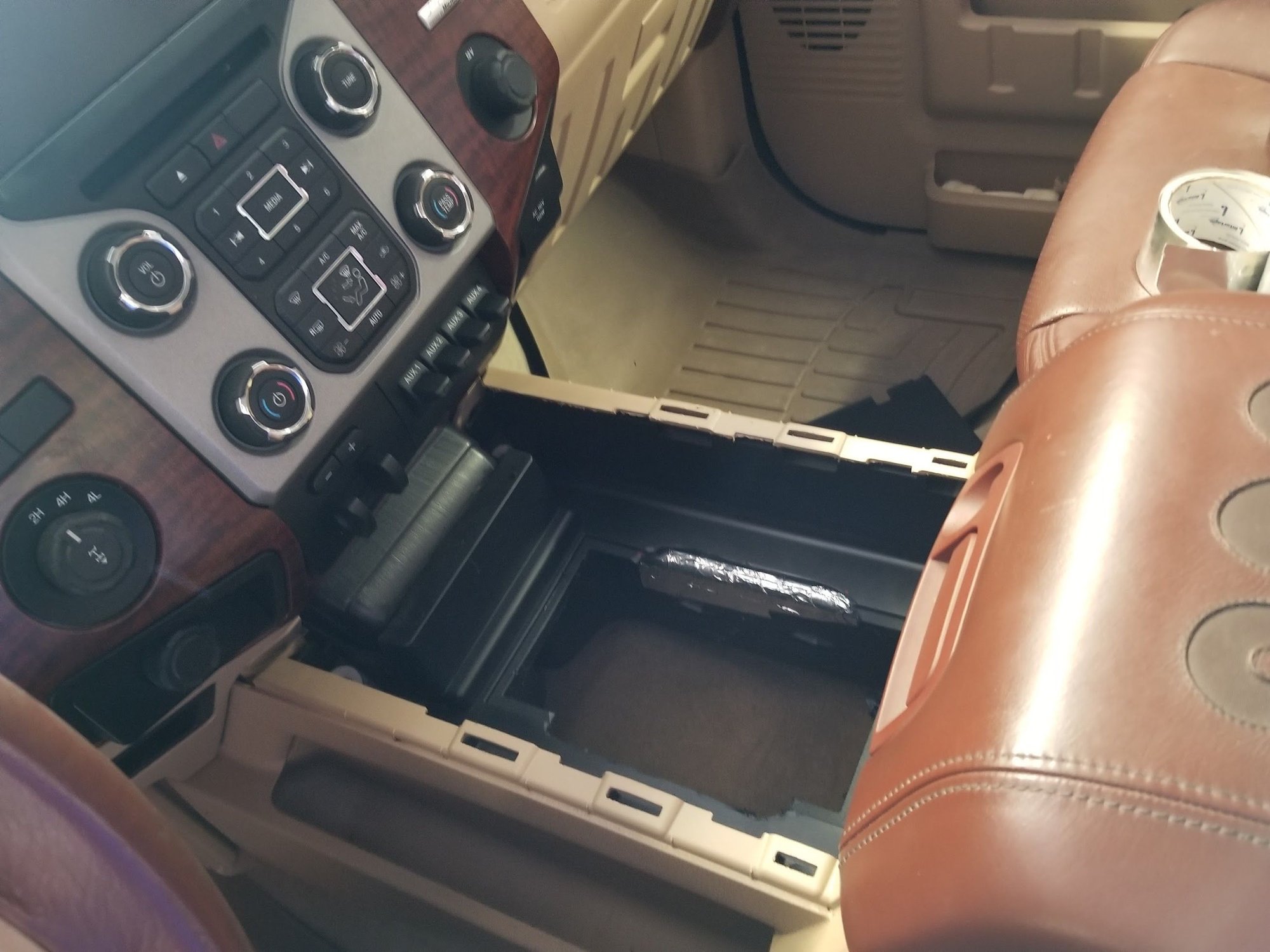

I installed the head unit of my Yeasu Ham radio in the compartment under the radio on my '23 Super Duty. It interferes with the sliding cover but I don't care as I don't use it anyway.

Under the driver's seat. I don't have a photo of that but it let me run the microphone cable between the center console and driver's seat. And the display cable is just tucked into the bottom of the console and runs up and under the factory radio. No holes or cutting needed in the console.
