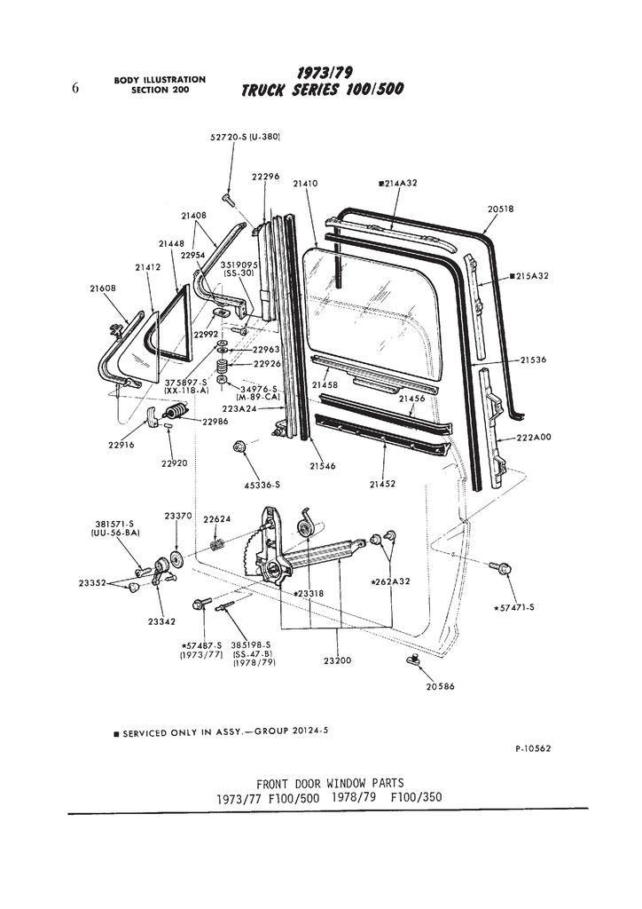

Yes there is a spring.

I believe #22624 is a spring.

Yes you will have to take the panel off to put the spring in it. I happen to have a spring that I forgot to put back that I can take a pic of tomorrow...eer later this morning when I get in the truck.

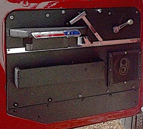

With no door panels in place, my cranks were tight on the shafts, but there was wobble as the shaft bushing was likely worn, or maybe made that way. I did not reuse the springs as I did not reuse the plastic door panels. I made my own, and where the cranks exit, I cut ~3/4" holes to accommodate the crank's hub. Originally with plastic panels, there was a thin plastic washer of sorts that slid onto the crank base and matched the OD of the crank, it was meant to prevent long time scuffing of the plastic door panel. I cut thicker black ones from old drop in bed liner pieces, maybe 3/16" thick, they too have a ~3/4" center hole (used hole saw in drill) so they will slide to the outer diameter of the crank base. Once installed, there is no wobble in the crank, very smooth operation. It's as if the new wood based door panels are acting as bushings.
Don't know that it helps, but might be something there?

My '77 had the springs behind the original hard plastic door panels. When redoing my truck in '21/'22 I had doors off to replace, etc and just made some temporary arm rest / pulls to use, the window cranks did have a bit of slop in them but it was slop between the shafts and the mechanisms in the doors.
Weren't pretty as they were just temporary until I had mine made. New doors had been painted inside by then.
The black washer like under the crank over the panel is maybe at best, barely visable.

Man that panel looks good, great job
Thanks
