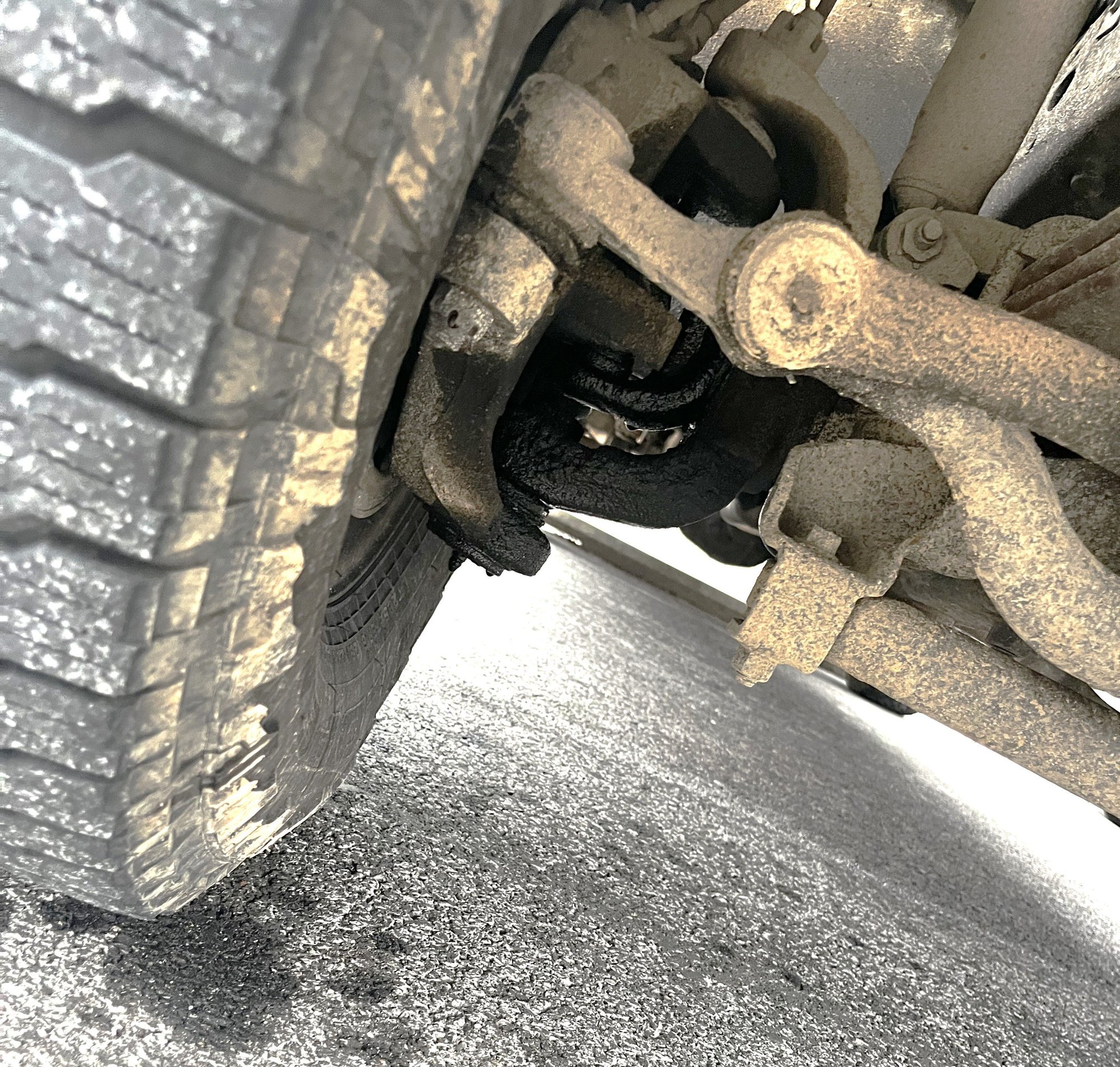

Exclamation Fluid all over front knuckle
Walked out of work today and saw a puddle under my front tire. I looked up under there and there's a gray/green fluid all over my knuckle, ball joints, brakes and caliper, hub, etc. Not really sure what it is but it doesn't go any higher than this. Its on the passenger
side if that helps. I am confident it isn't coolant as mine is bright red. Any ideas on where to start or what to check? Anyone else have similar issues? Any advice is appreciated! Thanks for reading!

Brake line would be my first guess.
Old Jan 24, 2025 | 04:49 PM
Fuzzpuss's Avatar
Fuzzpuss
Posts: 3,422
Likes: 938
From: Fort Worth, TX
Could be differential fluid, though I don't know how to explain it being above the axle tube, unless it migrated via surface tension or got slung while 4WD was engaged. Diff fluid has a distinctive smell so that would be a sure tell.

For clarification I drove it home after and wasn’t too abnormal of a drive and I probably wouldn’t have noticed if I didn’t see. Also I have manual locking hubs upgrade

Axle lube is my guess. Mine dripped on the passenger side after doing the seals and ball joints. Thought I had messed up the diff seals when I slid the axles back in. Kept a watchful eye on the diff fluid level and eventually the dripping stopped, and the level was fine. Just keep an eye on your diff fluid level.

Axle seal has left the chat lol

Axle seal my guy.

Ok so it is 100% an axle seal leak as I have almost no diff fluid left. Couple of questions - how do I know which seal to replace? Can i just do the one on the axle or do i need to do the one in the diff?
Crazy idea - but could I just drive with unlocked hubs and no diff fluid? Obviously wouldn’t be able to use 4WD but this is how I get to work so the faster I can use it the better. Would get it fixed a weekend im free and have parts if this is the case

It’s the inner seal. 2WD would be fine as long as the hubs are not locked in.
