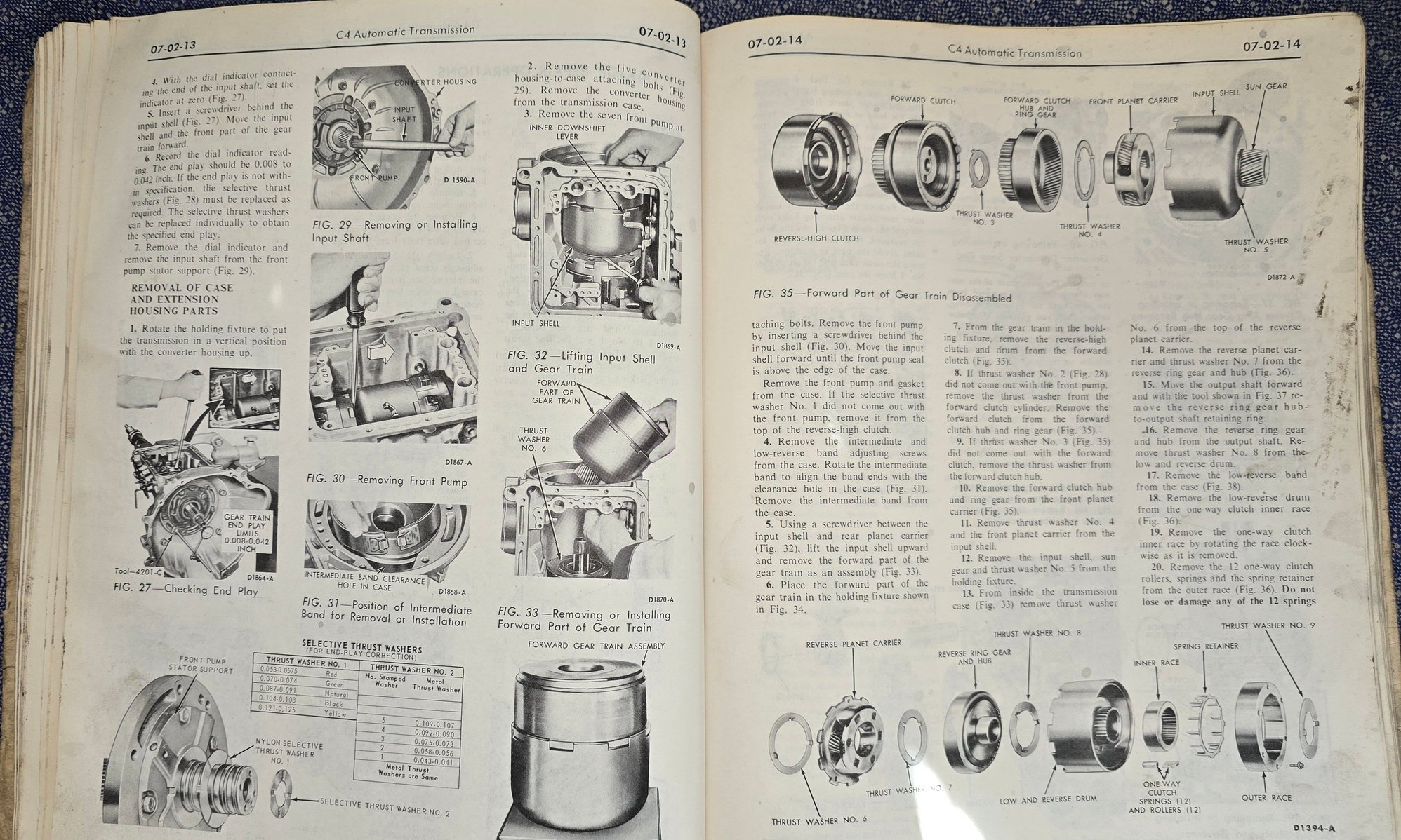

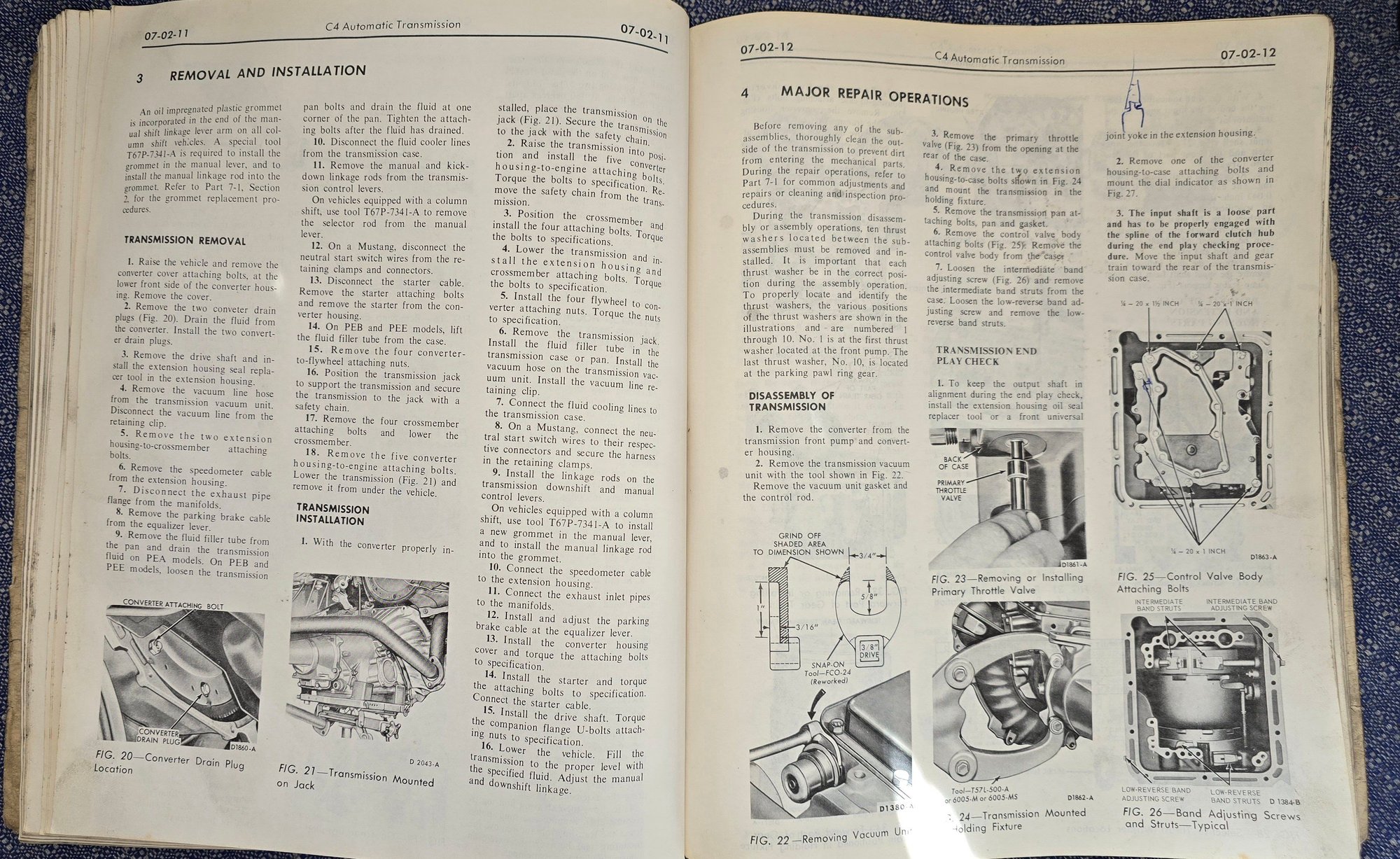

I hope you can see these well enough
These are out of a 1969 Ford Mustang service manual
There are 32 pages

Thank you very much. I'll snip those right on down.
It'll give me a great starting point.
