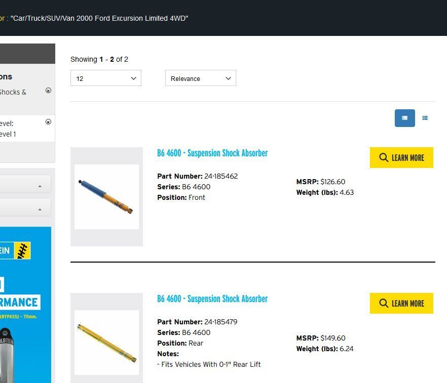

Update: I went to the Bilstein website, put my Excursion info in and they spit out the 4600 series. Then I put in "5100" into the search bar and the "5125" series came up. Did they discontinue the "5100" line? Doesn't matter to me, I just want to know. Also, maybe I should have started with "How do you know your Excursion needs shocks," maybe it is something else. The only time it bottoms out is when I hit a drainage depression in the road to fast. I crawl over speed bumps so they have not been an issue, but that stupid drainage depression gets me every so often, haha.

I thought that w/o a lift you had to use the 4600 series, doesn’t the 5100 series starts with a 2” lift ?
