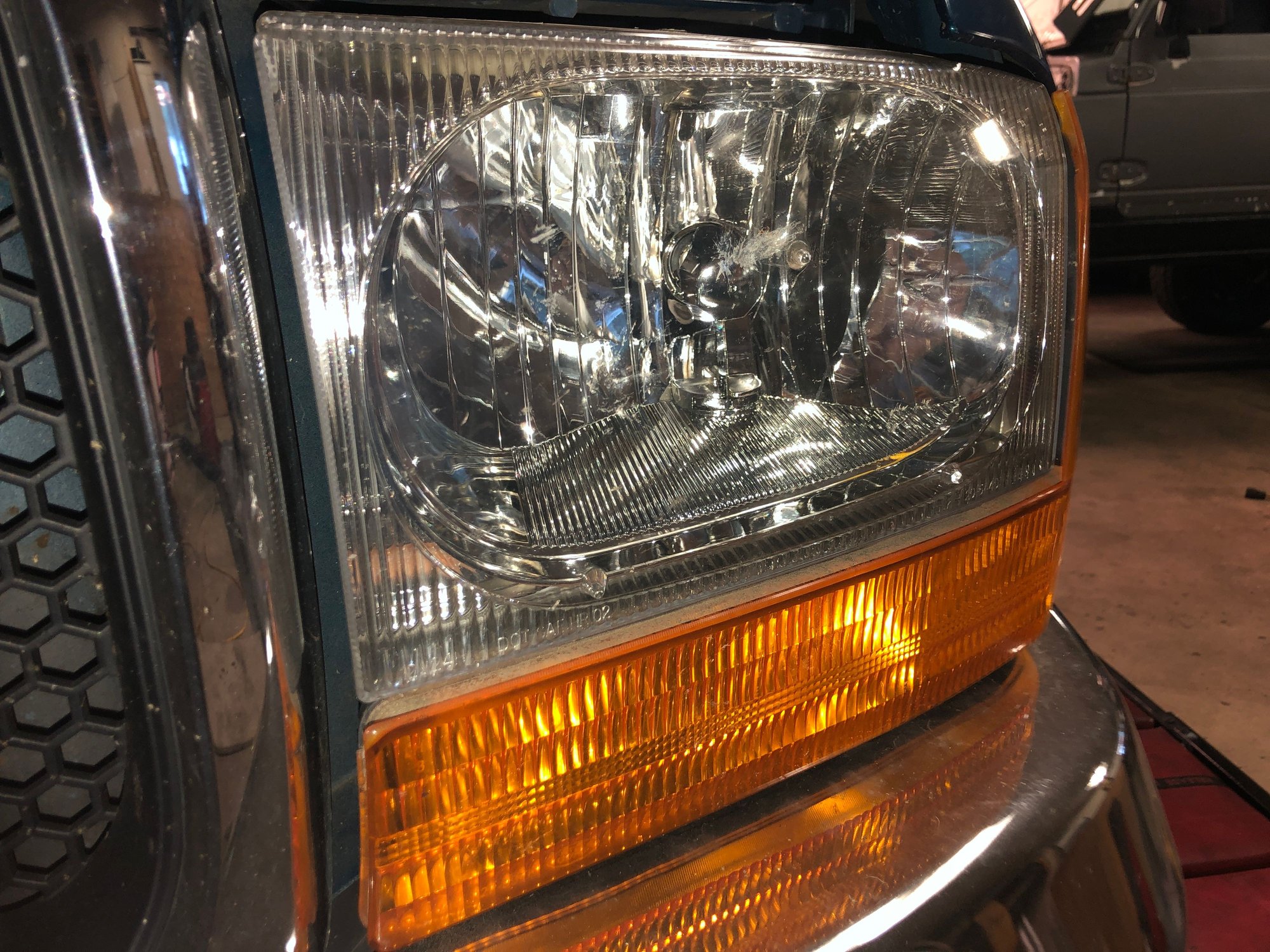

I've ordered the correct harness and Hella bulbs. When I put an order together I'd most likely get my new housings from RA, but I am still thinking about the one-piece upgrade.
Old Feb 4, 2025 | 09:26 PM
Eman85's Avatar
Eman85
Joined: May 2024
Posts: 915
Likes: 296
From: E TN

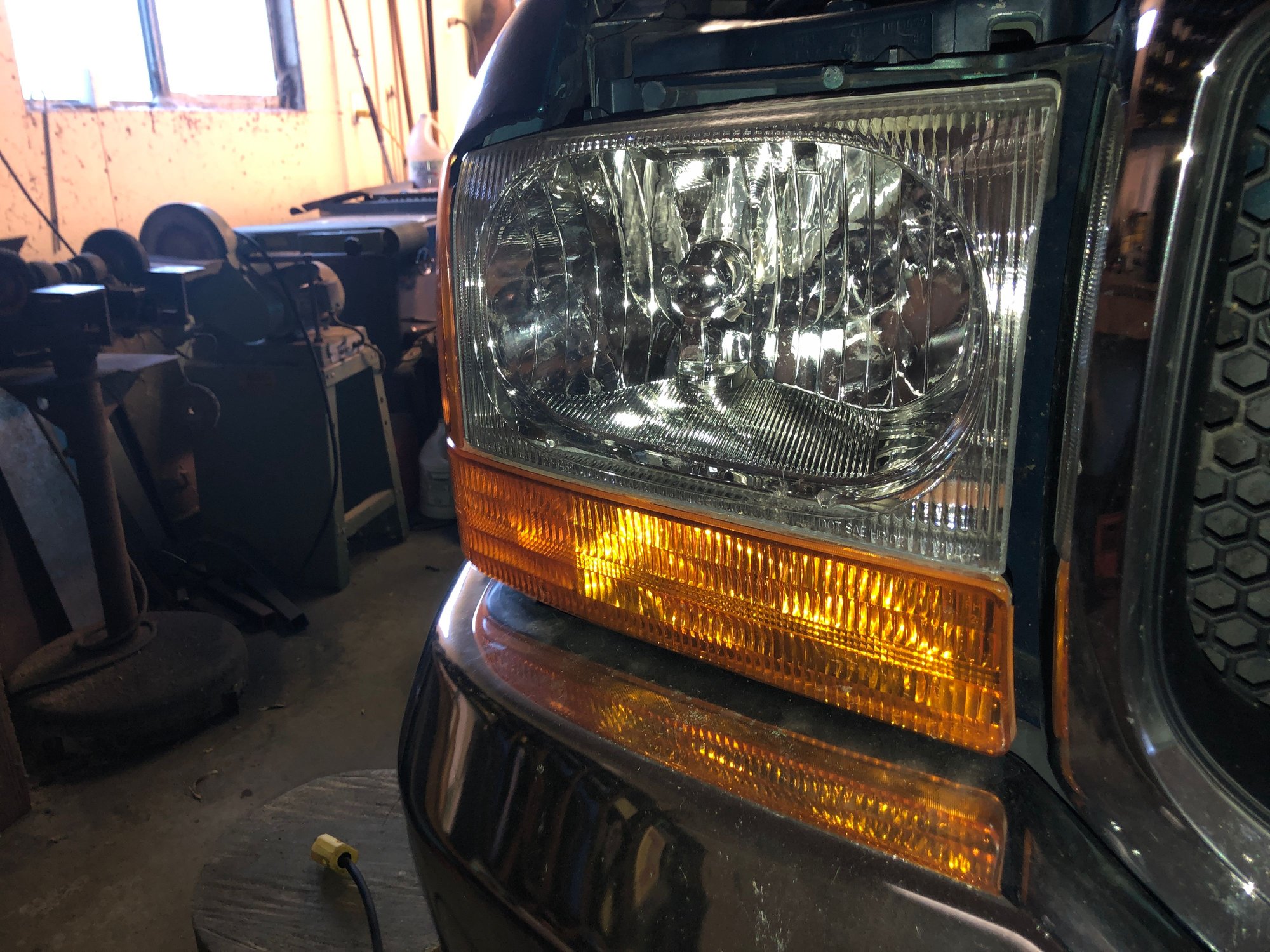

I went with the Rock Auto TYC CAPA certified factory replacement lamps. Bought the harness that was linked on ebay and a set of Hella bulbs from Amazon. Lamps fit and look good. Harness is in, they could have used a couple of more inches of wire, but it did fit running it under the hood latch in front of the radiator. Haven't turned them on yet as I have the batteries out doing some cleanup under the hood. Has to be better than what it was.

Just a follow up, new lamps and upgraded bulbs made a world of difference compared to what I had. I have plenty of spare stock bulbs now.
