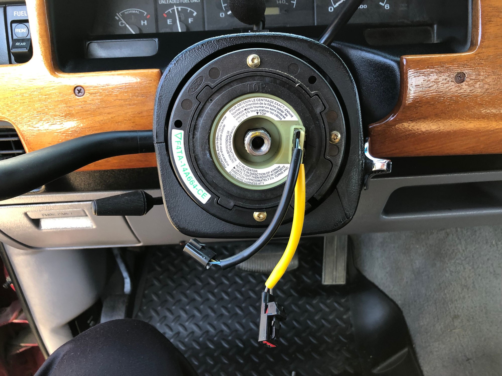

Recently bought a 94 Flareside and this is the main known issue I’m dealing with…
I’ve been searching previous posts but haven’t really found anything that fits 100% with my odd symptoms…
Cruise control does not work. However,
Horn does work.
Airbag warning light was initially not coming on at all and I thought it was burnt out and maybe part of the problem. However, now it does come on while driving (under specific conditions) but NOT when ignition is first turned on.
The beeping/warning chime is constant to begin with, but then seems to diminish to a series of five beeps every half hour if I’m not varying speed a lot.
But here is the really odd symptom… A couple times this past week I warmed-up and let it idle for 10-15 minutes before I left the driveway. Both times the beeping did not happen a single time over the course of the 1.5 hour trips. Instead, the airbag warning light would intermittently flash. No set times between, and anywhere from a single flash, three flashes or five flashes. Sometimes every few minutes, sometimes sooner or longer apart.
Hoping I can replace the clockspring this next week when it arrives, but am still researching potential sources of the problem in the meantime.
Thanks for any ideas.

Old Jan 11, 2025 | 04:05 PM

Just an update for the archives. Info may help someone else in the future.
Replaced the clockspring and while it fixed the constant airbag warning beeps, it did not fix the Cruise Control. Unfortunate, since I was happy leaving the module unplugged and living with the always-on warning light. Cruise Control is really what I want to get going. Oh well, I’ll continue to troubleshoot that.
