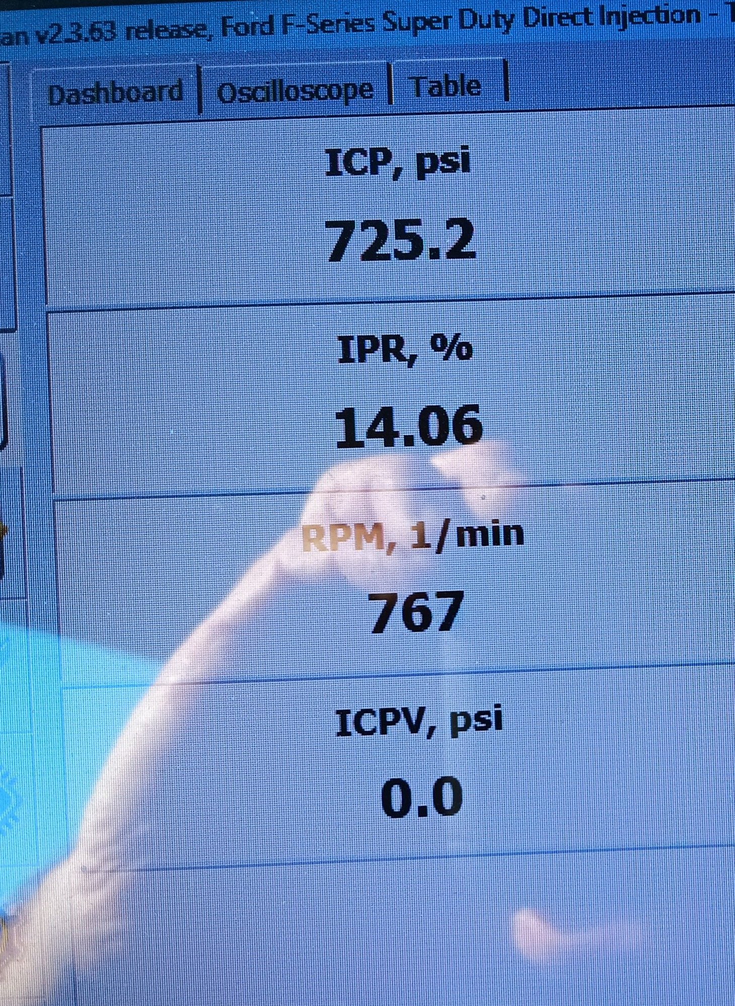

ICP and IPR plugged in engine running
ICP and IRP unplugged engine running

Not only is your IPR not working (runs when unplugged) but now you have a circuit problem with the ICP.
I think I'll replace the IPR, then tackle the ICP since it's new.
