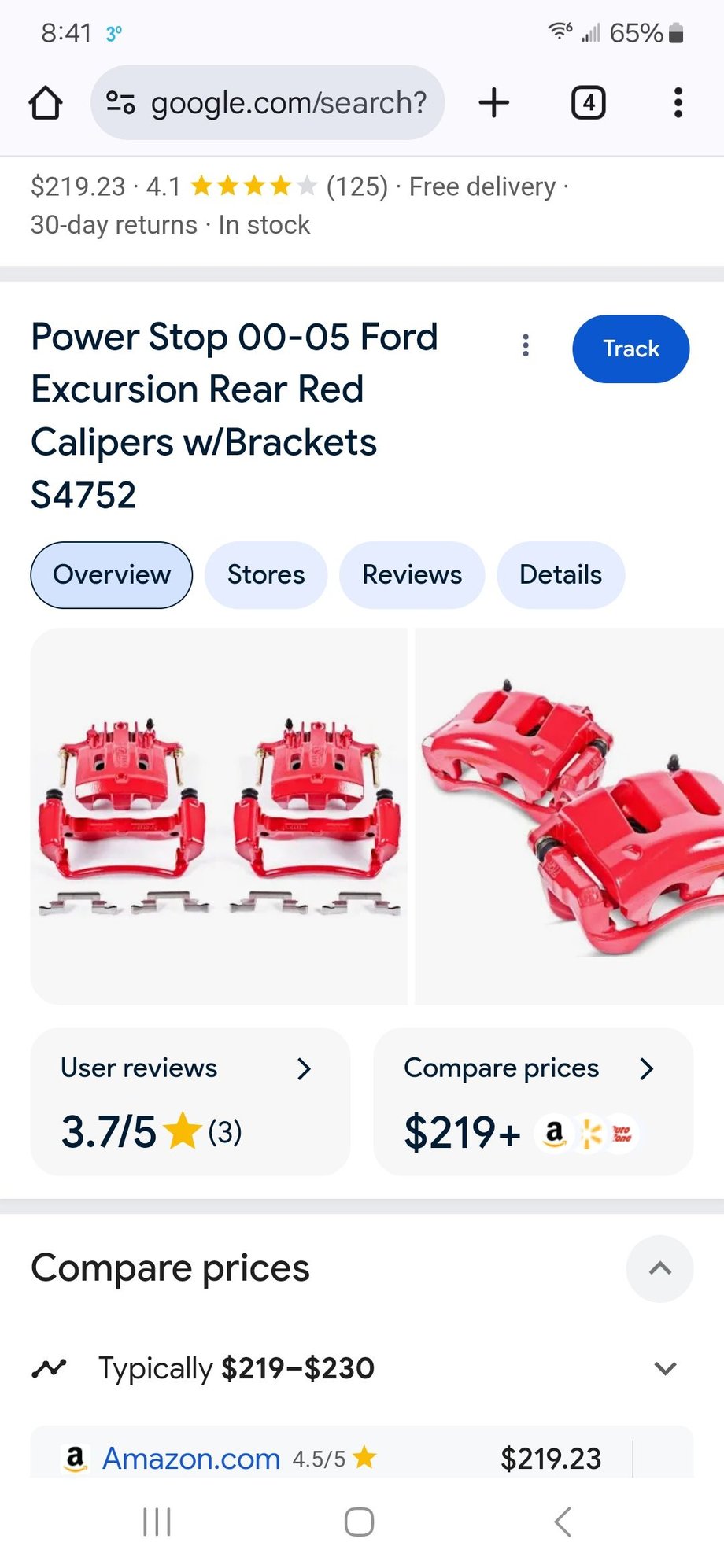

The part number for the rear on RA, Google shows as rear...

According to the Power Stop site 4790 is front and 4752 is for the rear. The picture on both caliper listings is the same so they must use a stock photo.

I wanted to respond earlier but decided not to... I think they may have sent you the wrong calipers.
The rear should have the fins on them and front should be smooth faced. Front calipers are typically larger as they do the majority of the work. You should easily be able to tell the difference between front/ rear calipers.
Looking on amazon and customer images, the rear have the fins and fronts are smooth faced as i mentioned.
Rear on top, front on bottom

that's just a stamping on the bracket, not the caliper part number. You did not receive the correct calipers. It appears the ones you pictured on the left with no stamping should be the rears. They did not send you the proper fronts and are most likely rears as well, but not sure about the piston cups.
they clearly have similar pics to what i posted above on the powerstop website. a few members provided what caliper part numbers you should have gotten.
EDIT, I just zoomed in on powerstops rear caliper pic. they have a 4507 stamped on the caliper itself. If you ask me, they sent you 2 sets of rears but they used some cheap thin walled piston on one set...possibly steel vs phenolic

Pulled the wheels off, you are correct, both are rears. One (thin piston) has 4507 on the caliper bracket and the caliper) . The other (thick wall piston) only has 4507 on the caliper.
