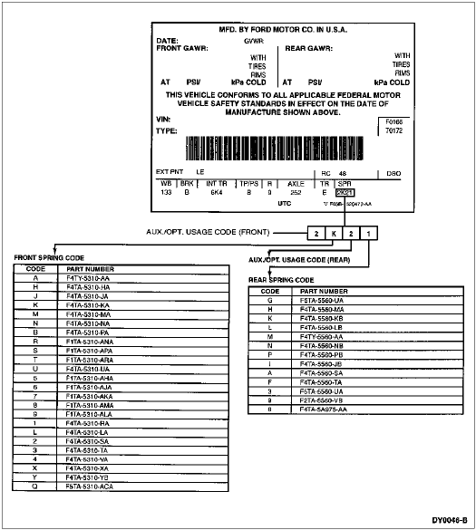

What is the spring code listed on the driver side B-pillar sticker?

Old Jan 3, 2025 | 10:56 PM
Nonofordf150's Avatar
Nonofordf150
Joined: Mar 2022
Posts: 247
Likes: 21
sorry I forgot the photos, yes I will do another post for that, so that's what I thought it was raised at the back, it seemed very high to me from the back.
shock absorber, blade support bearing are new.
in short for my springs the code and e4d.
