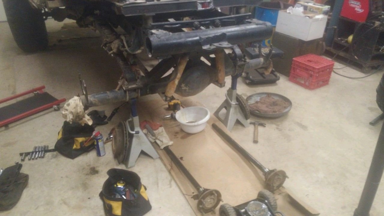

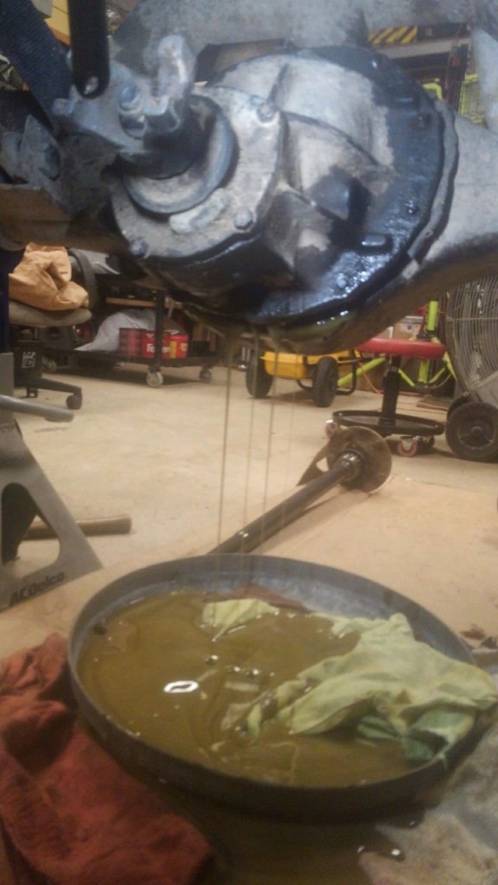

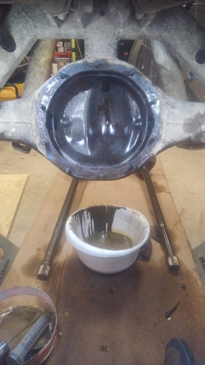

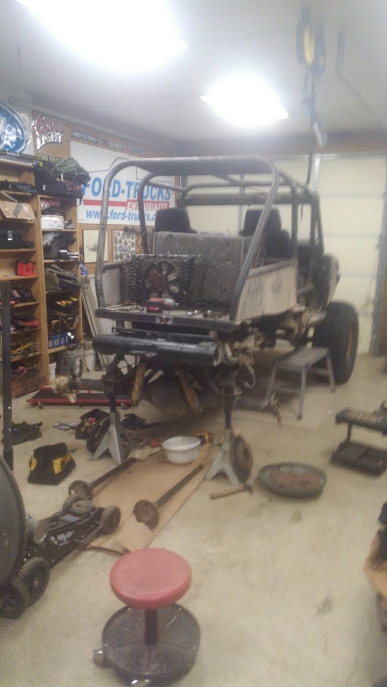

No worries that is why we are all here to help each other out, and make fun of chebby guys. Once you get the big stuff pumped out, put a little clean back in and then get down deep with a smaller tip hose. You want to get as much sludge/gunk out the bottom. This turned into.....playing u boat commander in the deep drop off ahead.
This, and....
This. Followed by....
Draining the milk shake....
I almost has serial numbers on the chunks/gunk in the bottom. You do NOT want to be setting down when the 3rd member comes out.
All clean now.
Back to fun.
