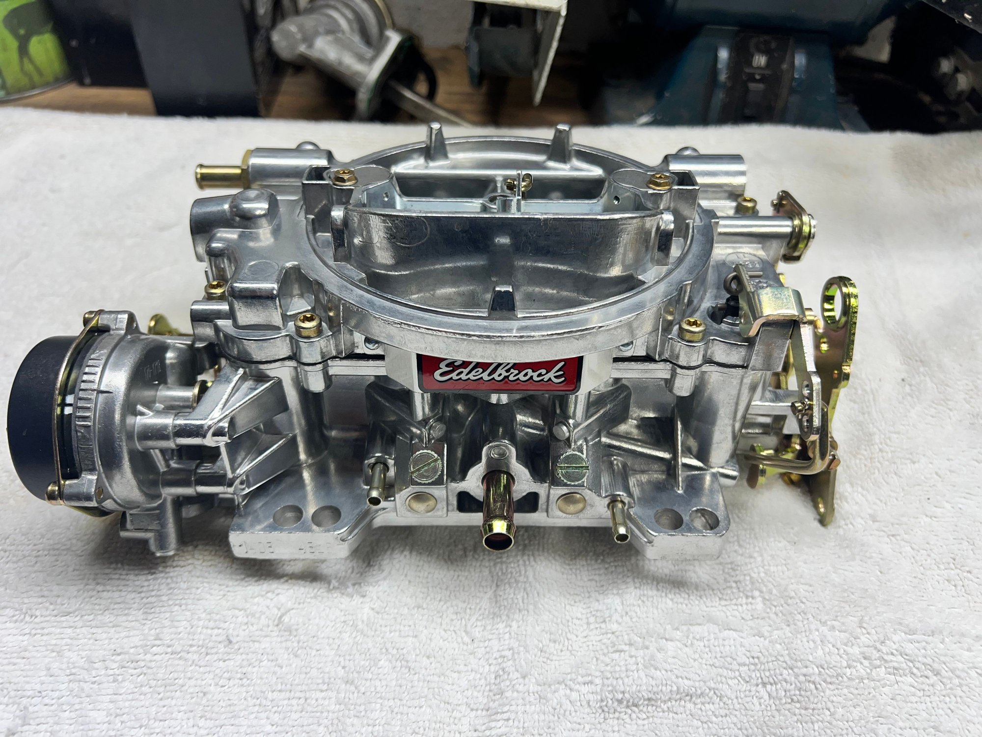

Good morning all, looking for suggestions for a good carb for my truck. 78 Ford F100, three speed on the column, I had it rebuilt and installed a Clifford C series intake and put a Edelbrock 500 CFM carb on it but it’s been years ago and set dormant. It never really ran good with this carburetor. Is there a different carburetor that I should be using? This one seems to be a little big.

The Edelbrock carburetors generally run rich right out of the box and require tuning by using an air fuel meter.
If you want the best fuel mileage out of any carburetor you choose, an air fuel ratio meter is a requirement in order to adjust the carburetor.

Holley makes a 390 CFM that guys run on AMC 258 six's as most others are too large.
Now if you want to run an adapter you can then run a Holley 2300 v2 carb in the 350 CFM, they also have a 2300 in a 500 CFM but that I know that is to large for a AMC 258 so thinking the same for a Ford 300.
IIRC Cliford 6 = 8 offers a Webber v2 I just dont know what the CFM is but dont think it is over 500 CFM.'I never had good luck with Webber's so I ran Holley's

That edelbrock carb should be tunable for the 300 engine.
I ran Rochester 2-Jet carbs on my early Chevy 283 engines with very good luck.
There may not be a "perfect" carb, but most will offer good performance once dialed-in for the current engine.
I've never used an air / fuel gauge, but they will show your ratio's for further adjustment.

Buy the tuning kit for that Eddy and spend some time dialing it in. It is a great carb for that engine. You say it never really ran right. What did it do? not do?

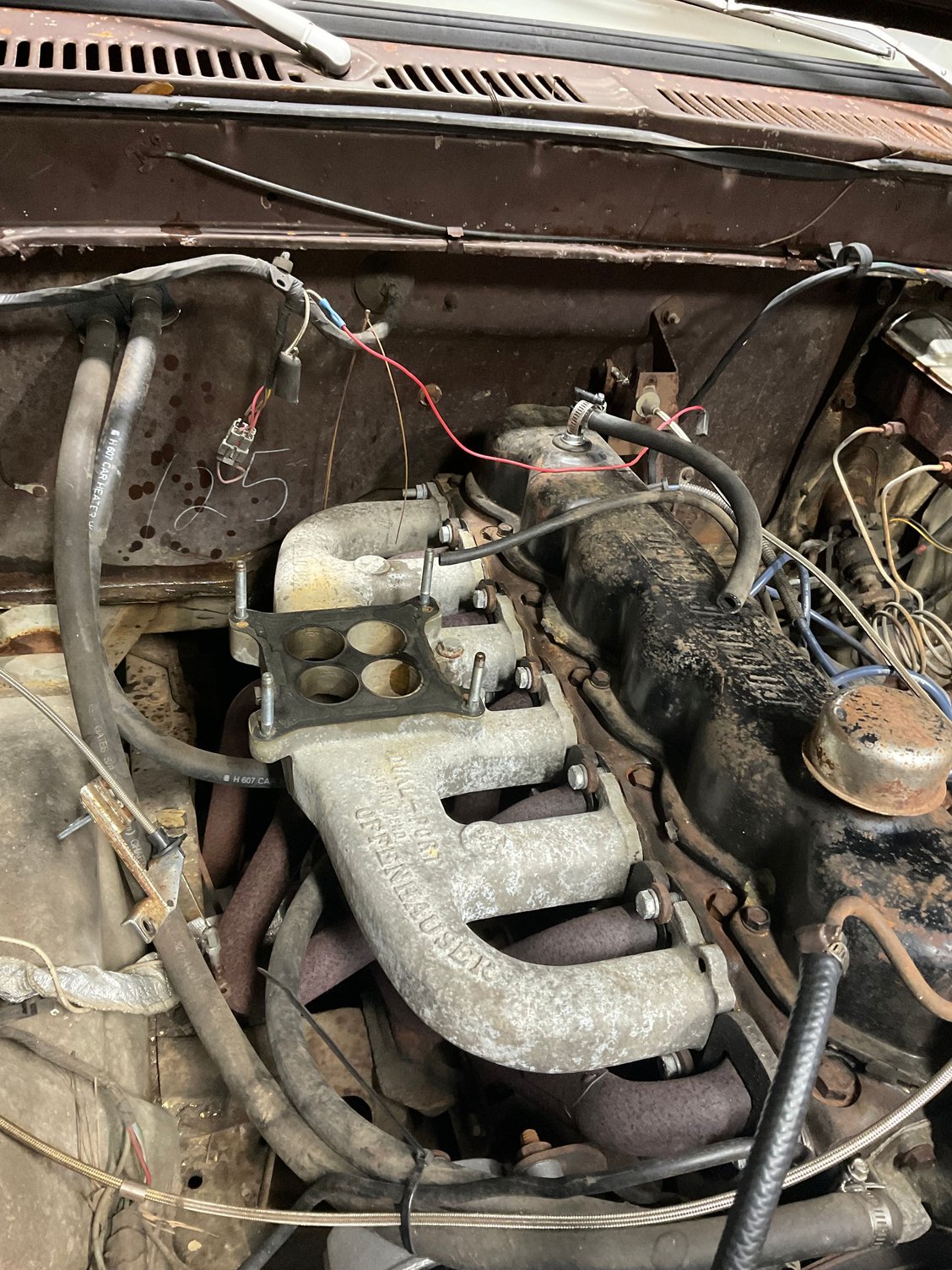

It’s the Offenhauser intake. I don’t know where I got Clifford from. I installed the carburetor on the engine at the same time I installed the intake. But I did not know there was a whole lot of trash in the fuel line in fuel tank, so a lot of that made it into the carburetor. So I disassembled the carburetor and bought the rebuild kit. Put it all back together Now it runs just for a little while and then dies and then will not crank up again. It’s confusing to me. I thought maybe it was a coil issue so I replaced that. No change. If I wait about 20 minutes, it will crank up again and then die. And I do have the heater hoses running underneath the intake.

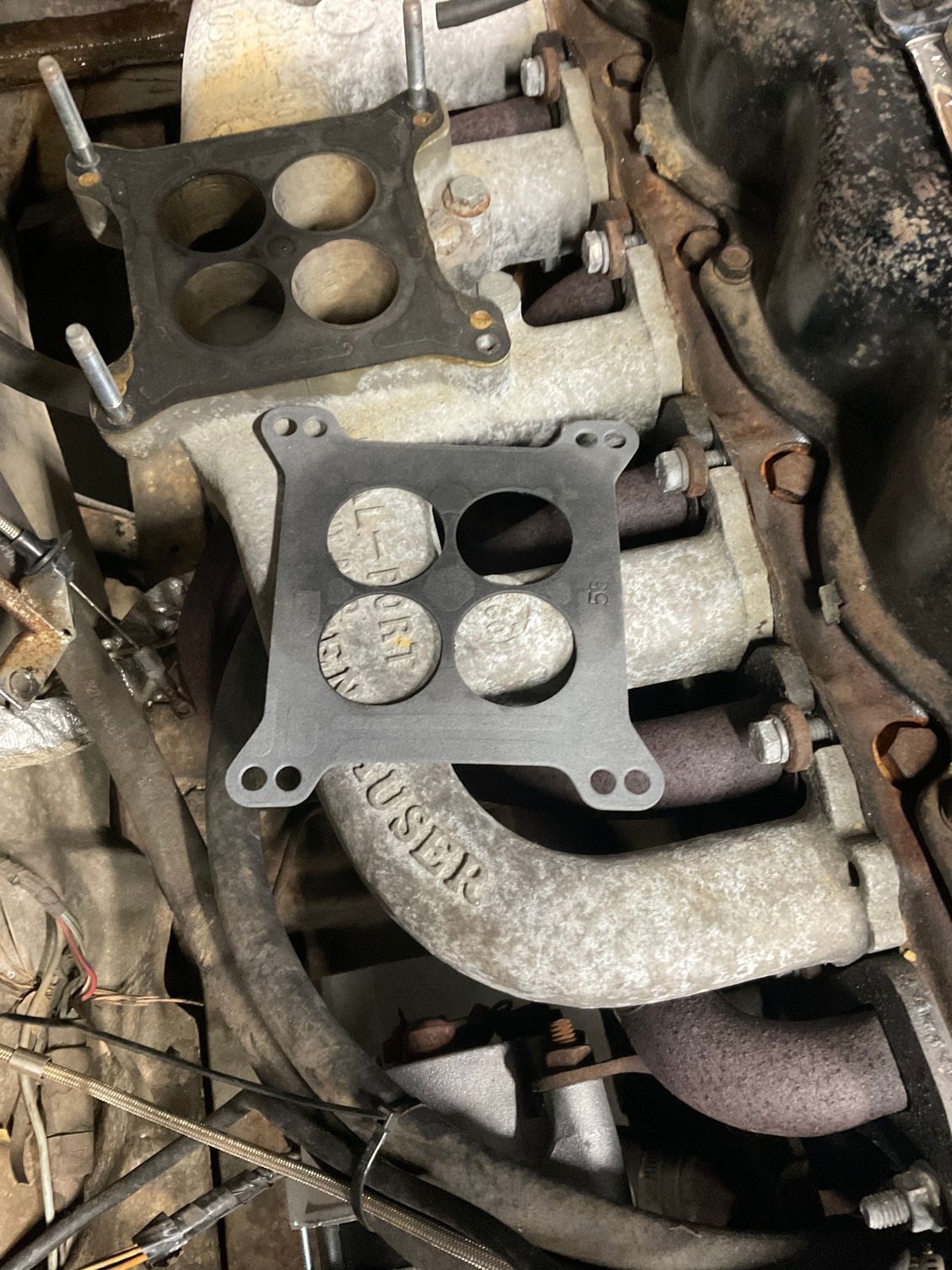

Well, when you’re extremely impatient and don’t know what to do next, you make bad decisions. I bought a new one. I do have a question, though, when meeting this up with an offfenhauser dual port intake, do you use the square flange gasket or the one with four ports?

What is the intake like open or 4 ports?

Yes, for the most part... I put one on my 66 F100 with the Offy for a short while just to see, ended up going back to the Holley 390 cfm, IMO and experience, the 500 is too much, I never liked how it ran, and on hard right corners it would stumble, maybe it was just me. On all the 300's I've done, I went with the Holley 390 and have been pleased, my 79 F250 4x I sold and drove to MO for my BIL, I avg. 18+mpg over 1800 miles, never a hiccup or anything, even at altitude going through Eisenhower tunnel in CO at 11,000' or so. I believe most guys over-carburate their engines, On my 351Measly I redid, I went with the Summit 500cfm on it and still had to jet it down.

The real question is what side dose the primary go to the outside or the inside being you have a dual port manifold
Me I would go to the outside.
Dave ----
IIRC the primaries go inside due to throttle cable and linkage...
