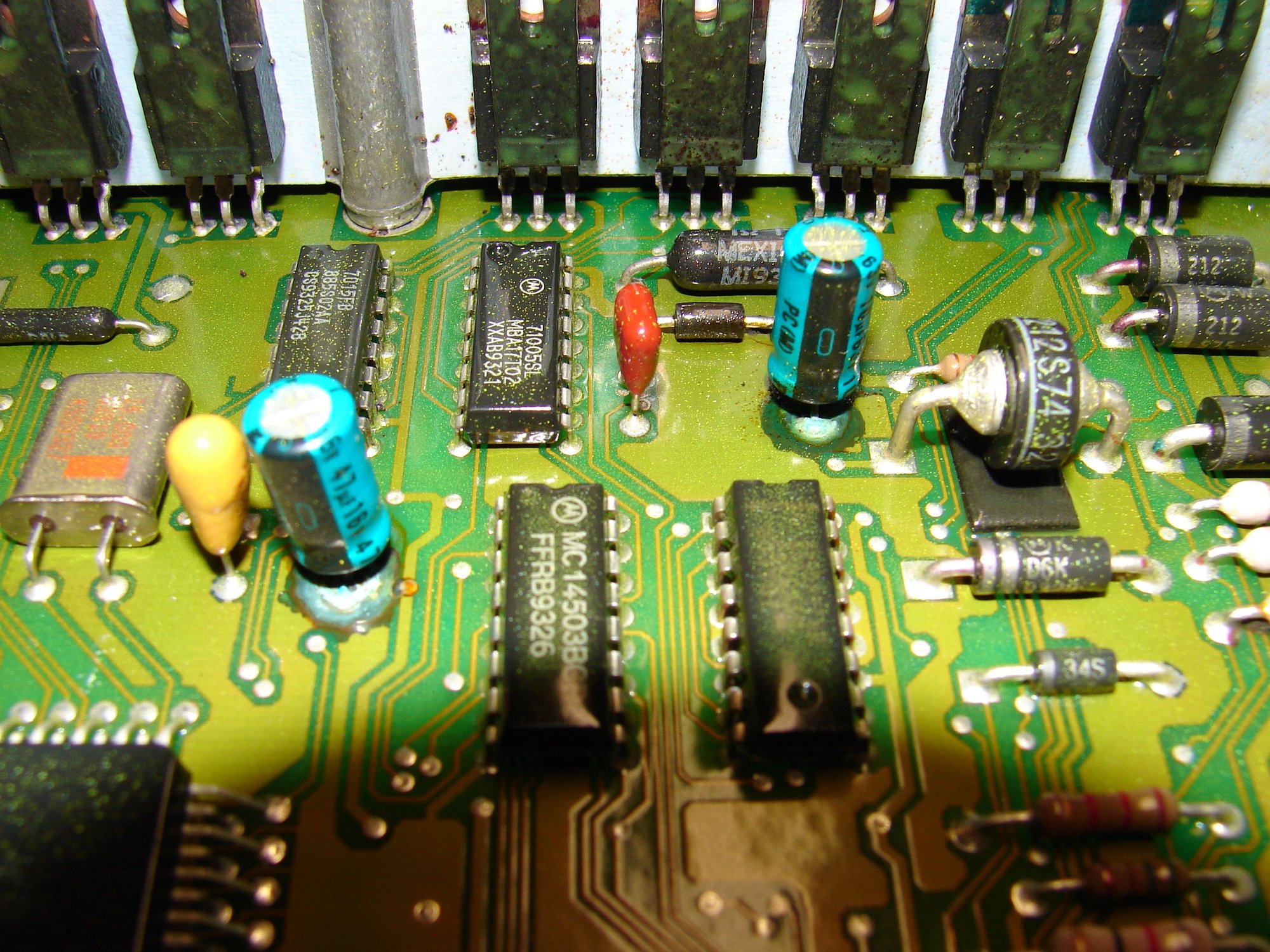

Originally Posted by 5.0Los
I cannot pull any codes, no matter what i try. I have the innova 3145 and it will not start the test it's supposed too....
Remove computer, open & look for leaking capacitors.
Doesn't hurt to look at the PSOM as well.
Nothing like rebuilding a trans, throwing parts & it does the same damn thing.
Ask me how I know.
Ask me how I know.
I have removed it and it looked fine to me but then again I'm not too sure what im looking for. Ill post pics later today.
... I'm not too sure what im looking for. Ill post pics later today.
Do you know what a dead battery leaking looks like?
There should be 3 blue/black can like items with 3 legs on the board.
Corrosion leaks down the legs & onto the board.
