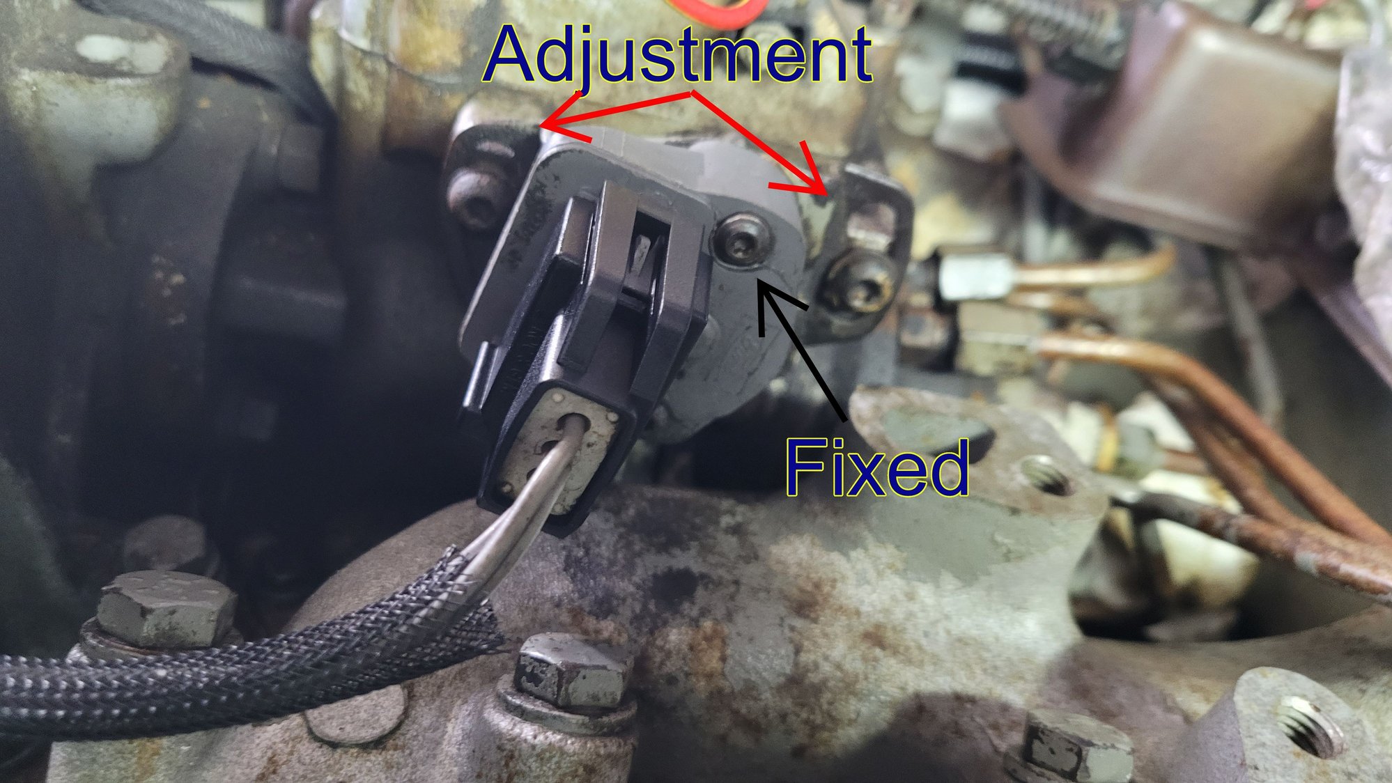

TPS Adjustments
Diesels are a little different than gas. By “relearn” I mean that the PCM/ECM uses the closed voltage as the new baseline every time the engine is started.
The FSB has a C6 and a ZF5 in the F-150. The ‘94 Bronco had an E4OD and when I replaced the TPS because it set a code, all I did was install the new part and reassemble. I couldn’t adjust it even if I wanted to. The holes in the Motorcraft sensor were not slotted.
As you can see in the picture. The TPS in my model is mounted firmly to an 'Adjustment Plate'. It is that plate that is used to set the correct voltage for Idle and WOT. I would be interested to see a picture of yours. My ECM does not 'Learn".

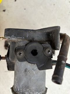

Early style 302/351 throttle body

Dave 78 has a 7.3 IDI so is that an OEM part or has someone added that over the years?
That's our factory setup in IDI trucks. We only have a trans controller, no engine PCM, cus our engines are 100% mechanical, save for 12v to our injection pumps, to turn on fuel solenoid. Manual trans trucks don't even have this of course. We need to set our TPS manually. Both at idle and WOT. The trans controller wont ever change it for us. Dave is correct in how our trucks are; there's no learning whatsoever. You can set the TPS voltage, turn the key on/off all you want and the TPS voltage will remain at whatever we set it at when we installed it. We can only change it manually. The trans controller will only read it. It's very particular too. We set it (once) with a volt meter (50k mile change intervals).

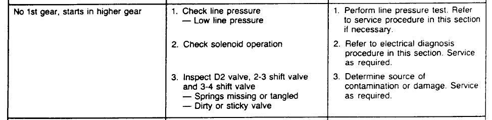

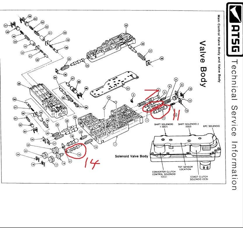

14: D2 Valve.
11: 2-3 Shift Valve (lower valve circled).
7: 3-4 shift Valve. (upper valve circled).
Remove all items from each of these bores (one at a time, to help reduce mixing up parts). Inspect all items. You're looking for any stuck valves and or broken, tangled springs.
Caution; don't loose the check ***** as you lower the valve body from the trans.
Tip; You need an inch pound torque wrench; all valve body torque specs are 100 IN-LB.
Keep everything super clean.
