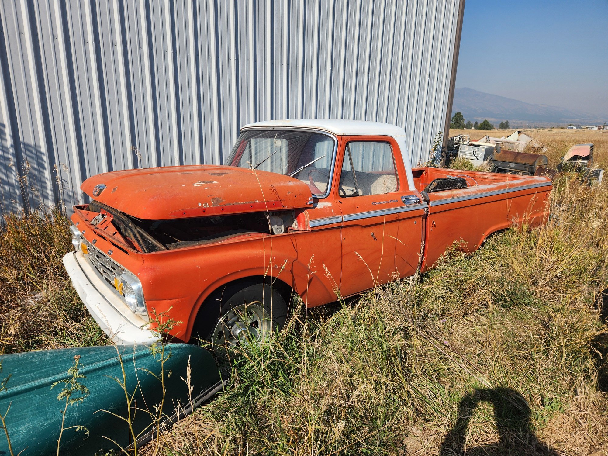

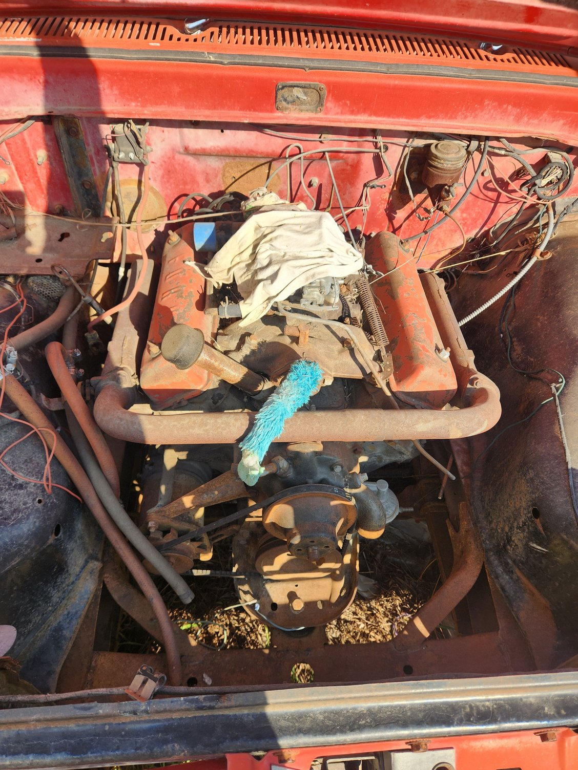

Hey there ! Needing a little help finding a engine code or any id numbers on this 65 f100 engine. Looking to get a rebuild kit. This truck has been on my dad's property since 2004 when a family member passed away. Doesnt look like a 352 by the pictures and valve cover. Thanks in advance !

It's a Y block. Probably a 292. I'll check the VIN later if someone else doesn't beat me to it.

C = 292 2V Medium Duty Y Block
R = San Jose
446534 = 1964 numerical series, August 1963 production
128 = 128 inch wheelbase
JM
J = Rangoon Red
M = Wimbledon White
F100 = F100 4x2, 5,000 lbs GVWR, except state of PA.
E81
E = Red crush vinyl and red check stripe woven plastic
81 = standard cab
F = Warner model T98A four speed transmission
A2 = Spicer model 44.1 3,300 lb capacity rear axle,, 3.92 ratio, locking (probably limited slip)
5000 = 5,000 lbs GVWR
135 3800 = 135 Certified Net HP @ 3800 RPM
73 = Salt Lake City District Sales Office
So, a '64 not a '65. Moving you to the correct forum also.
