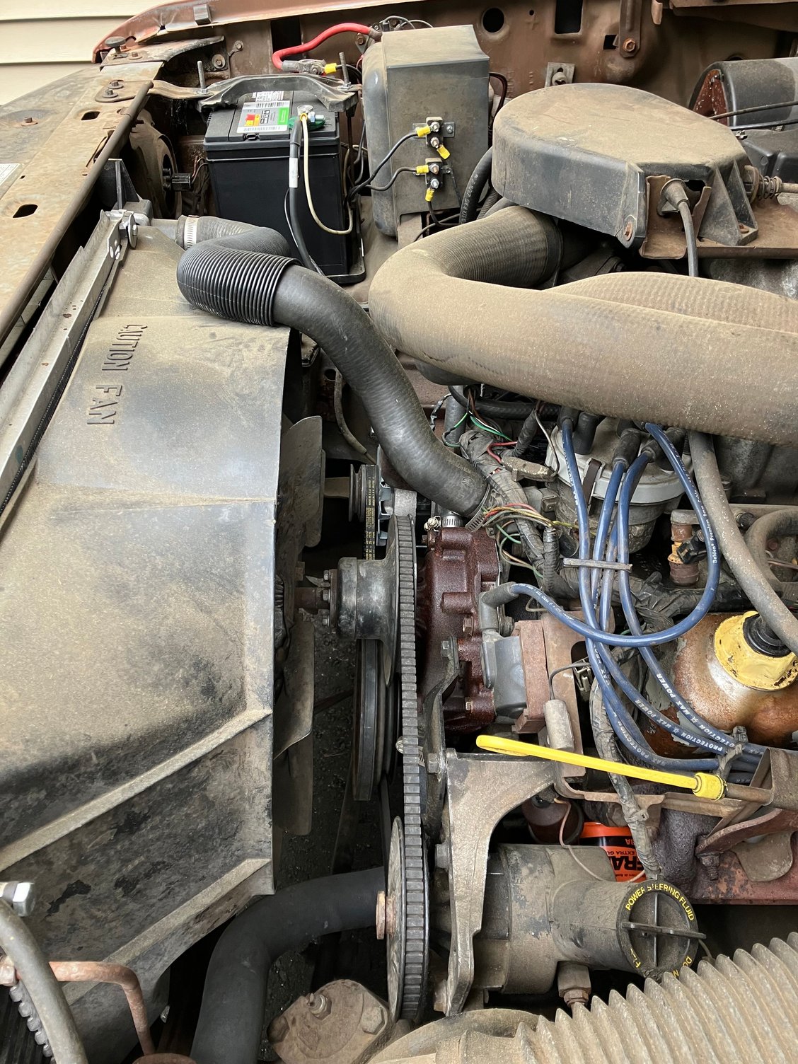

Old Feb 19, 2024 | 05:48 PM
Oldgreen100's Avatar
Oldgreen100
Joined: Feb 2013
Posts: 50
Started truck up for the first time to break in the cam. Runs strong and can break in was successful, but has a rear main seal leak (first time doing a 2 piece) and putting a small amount of coolant in the oil. Also my homemade spark plug wires (I was in a pinch) like to unplug themselves. Been advised to recheck the torque on the intake manifold gasket, as that's a likely culprit. Proud of my work though. This picture is the next day after I installed a different cap and rotor and stock plug wires.
Old Feb 19, 2024 | 07:01 PM
Max Capacity's Avatar
Max Capacity
Joined: Jun 2013
Posts: 5,667
Likes: 1,159
From: Tolland, CT
Just asking, did you bench bleed that master cylinder before you bolted it on ?
Old Feb 19, 2024 | 07:03 PM
Oldgreen100
Joined: Feb 2013
Posts: 50
Not yet. It's coming back off.
Good catch on the new MC. In addition to bench bleeding, take a look here to save yourself a LOT of aggravation:
https://www.ford-trucks.com/forums/1...-bleeding.html
Old Mar 31, 2024 | 09:55 PM
Oldgreen100
Joined: Feb 2013
Posts: 50
Thanks a bunch for the link. Did some brake work a few weekends ago. Having a hard time finding calipers for a 4,600lb GVW truck. Did run some new brake lines though. And bench bled the master cylinder.
