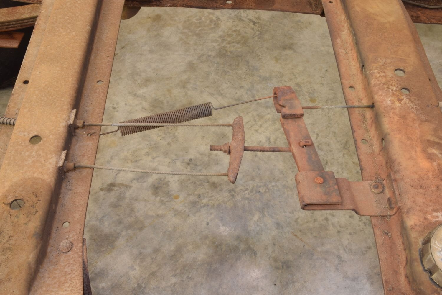

Regarding parking brake you likely won't find the parts you need to fix that new, you'll have to grab them from a parts vehicle or salvage yard if you're lucky enough to find a truck there as old as yours.

Here is a picture from another FTE member of the F100 brake cable set up.

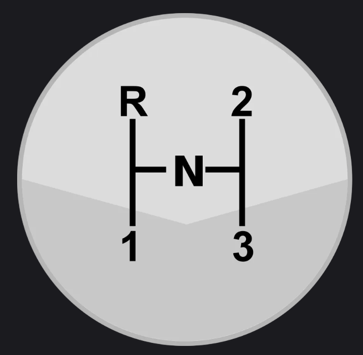

Hey 67 f100 3 speed on the floor
anyone knows the shifting pattern?

This is the typical 3 speed floor shift pattern.
