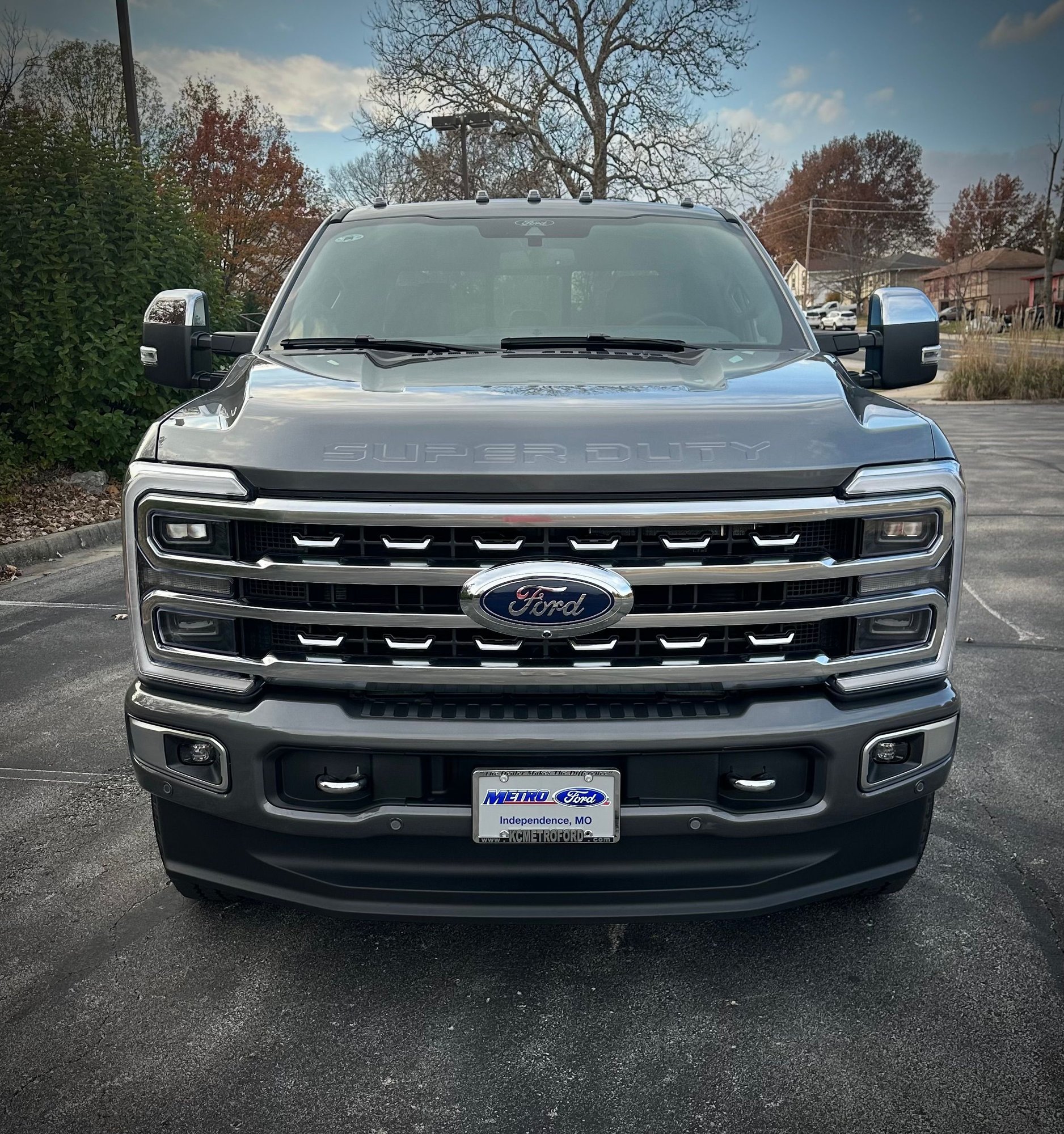

Missouri only provides one plate for trucks licensed as 12,000 or 18,000. The plate has to be mounted up front otherwise I would remove it. I too thought the plate was off center but it appears that it is centered to the blue oval. The center open area behind the plate causing it to look that way. It is what it is for now.

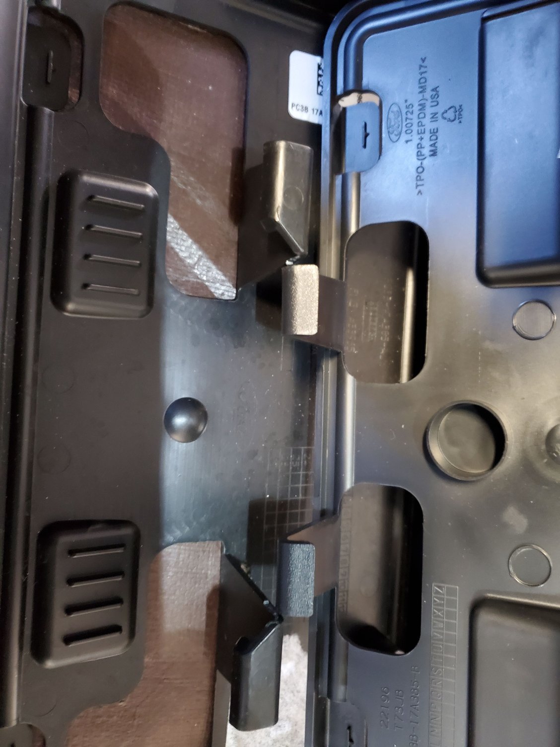

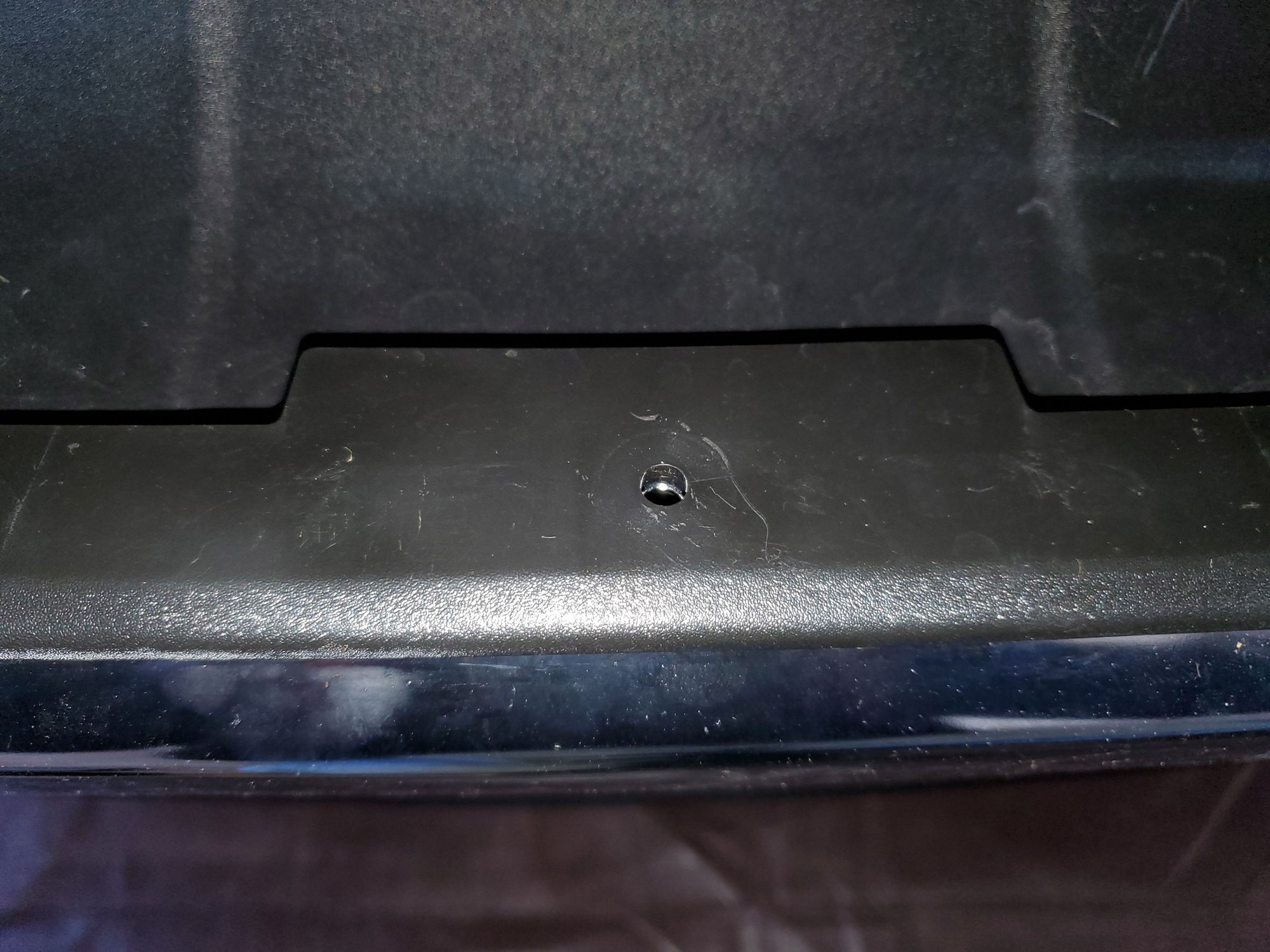

I did a different front (flimsy) plate to move it lower. Think it is the pre-23 plate IIRC, there is a thread on it somewhere.
Wanted to open up the space for a small light bar. Did have to drill a couple holes SS self tappers, which did make it
feel stronger, mounting wise.
Stock plate holder
Plate holders, side by side

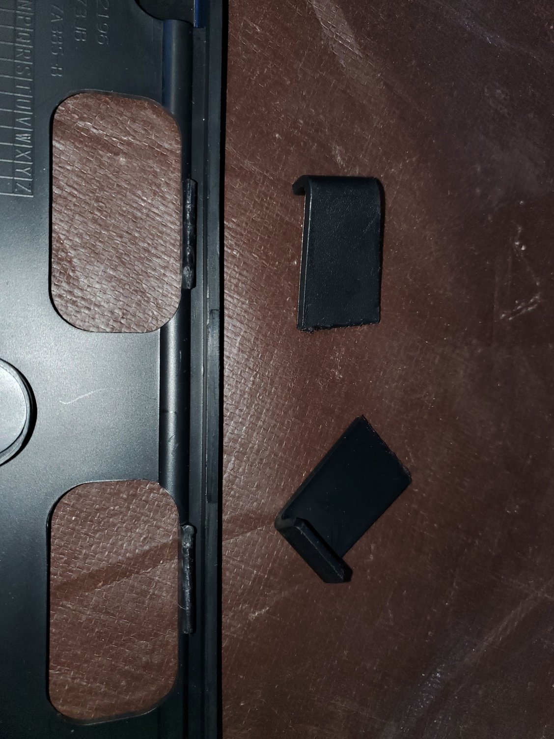

Cut off top mount brackets, as they did not reach inner edge of 23 bumper.
It still uses the stock "slits" under bumper.
