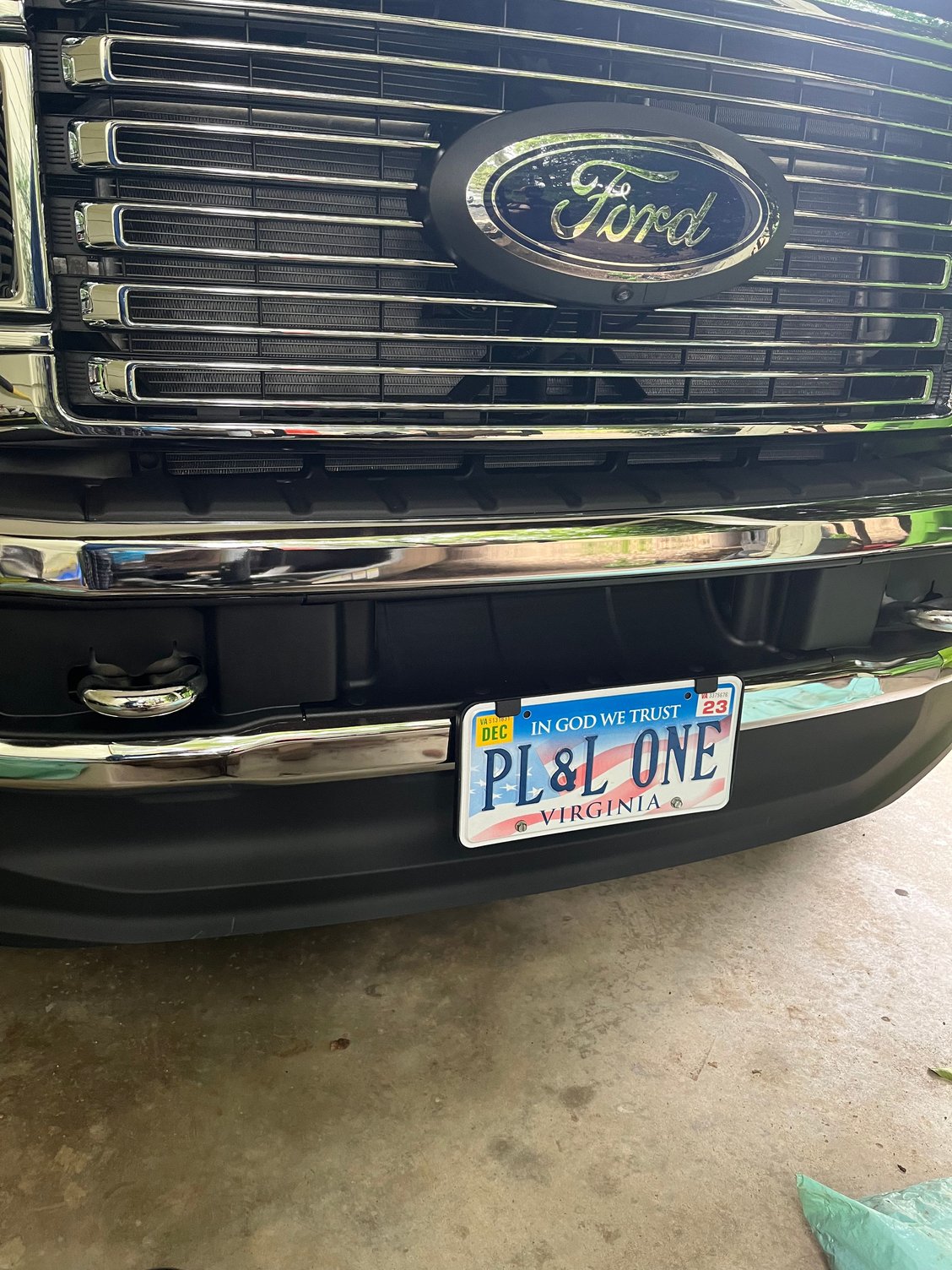

Do you guys know if ford has come out with the front license plate relocation bracket for the 2023 that has the factory winch?

no you need the f450 bracket
its different but does still clip on the same way it just lowers the plate location to where it doesn’t obstruct the front bumper air dam anymore

I think it's. LC3B-17A385-BA

I actually have mine off the truck right now because Alaska doesn't require a (stupid) front plate.
This is right side up:
This is on my 2022.
