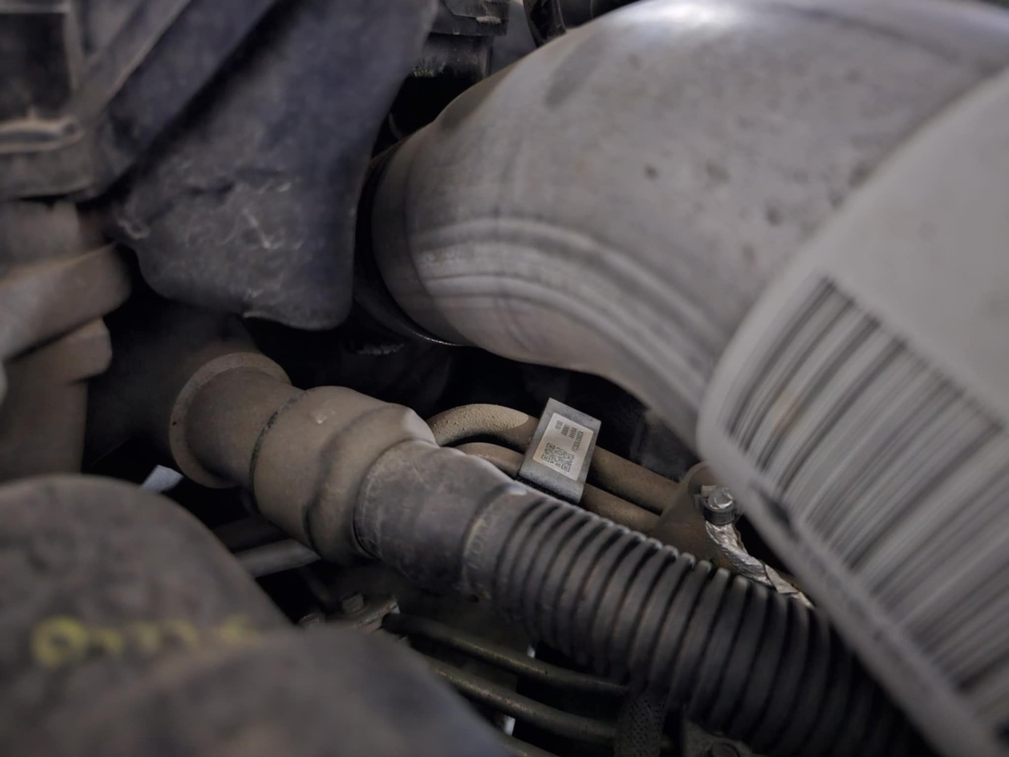

Originally Posted by Normmus
Yes - I just checked and that sensor is unplugged. Not sure about the CCV though. I am assuming that it has a sensor but can't see it.
On my '16' there's a CCV sensor circled in the picture it's a 9/15 build not all '16's have the sensor.
My 16 does not have that sensor there.
Old Dec 16, 2024 | 12:51 PM
acdii's Avatar
acdii
Joined: Feb 2022
Posts: 7,995
Likes: 4,061
Neither did my 2019. Interesting.
Old Dec 16, 2024 | 01:58 PM
Normmus's Avatar
Normmus
Joined: May 2004
Posts: 100
From: Alberta
Things make sense more now. It looks like my '16 is the version without the CCV sensor. The hose looks like yours, but without the electrical connector. I think I could delete or 'reroute' the CCV without getting a check engine light.
