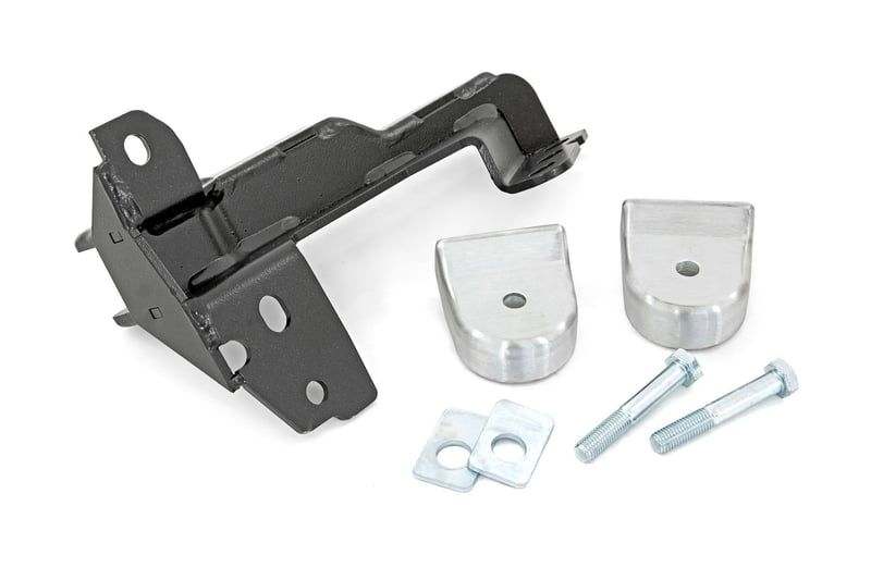

I used the RC level kit $160 on my 2022 f250 and installed it myself. the trackbar bracket is heavy and appears heavy duty. It raised it about 1.5" but I have the 7.3 Godzilla.
From the way I understand it the new trackbar bracket eliminates the need for a adjustable trackbar as my axle is still centered under the truck.
I will be replacing my front shocks with the Bilstien 5100 for a 2" lift soon. I am happy with the RC kit and it did not need an alignment as I had it checked after install.

Wow, RC kit is welded plate, not cast. What did you do for bump stop/ sway bar/ brake line lowering/ spacers? Not needed? Still drives perfect and no death wobble?
I thought adjustable track bar was needed even with bracket. I read track bar bracket is needed to maintain correct geometry. I do feel better using factory parts wherever possible. Just want to take out the 2wd look of my '22. If I add bigger wheels and tires later I will probably use OUO or comparable higher quality components. Thx

Not needed. I will add Bilstein shocks for 2" lift soon though but works fine as is.

True, there is multiple ways to do it. I prefer to put some better parts in but really most guys can run a 2 or 2.5 inch lower spacer lift and some cheap drop bracket, decent shocks, and add 2.3 & 2.6 caster and be fine.

Beacause there are more than 1 way to skin a cat. I just want to level the truck with minimal modifications. Everyone seems to have a different opinion. Should I pay $3800 for the OUO kit with shocks for 2.5" lift or roughly $500 for 2" lift. My goal is not to buy a 80k truck and modify the **** out of it.
If I was lifting 4 to 6 inches I agree with you, buy the best kit out there. But is the best kit the most expensive? Paying the most doesnt mean you necessarily are getting the best. Pays to do your homework and shop around which is exactly what I'm doing.
