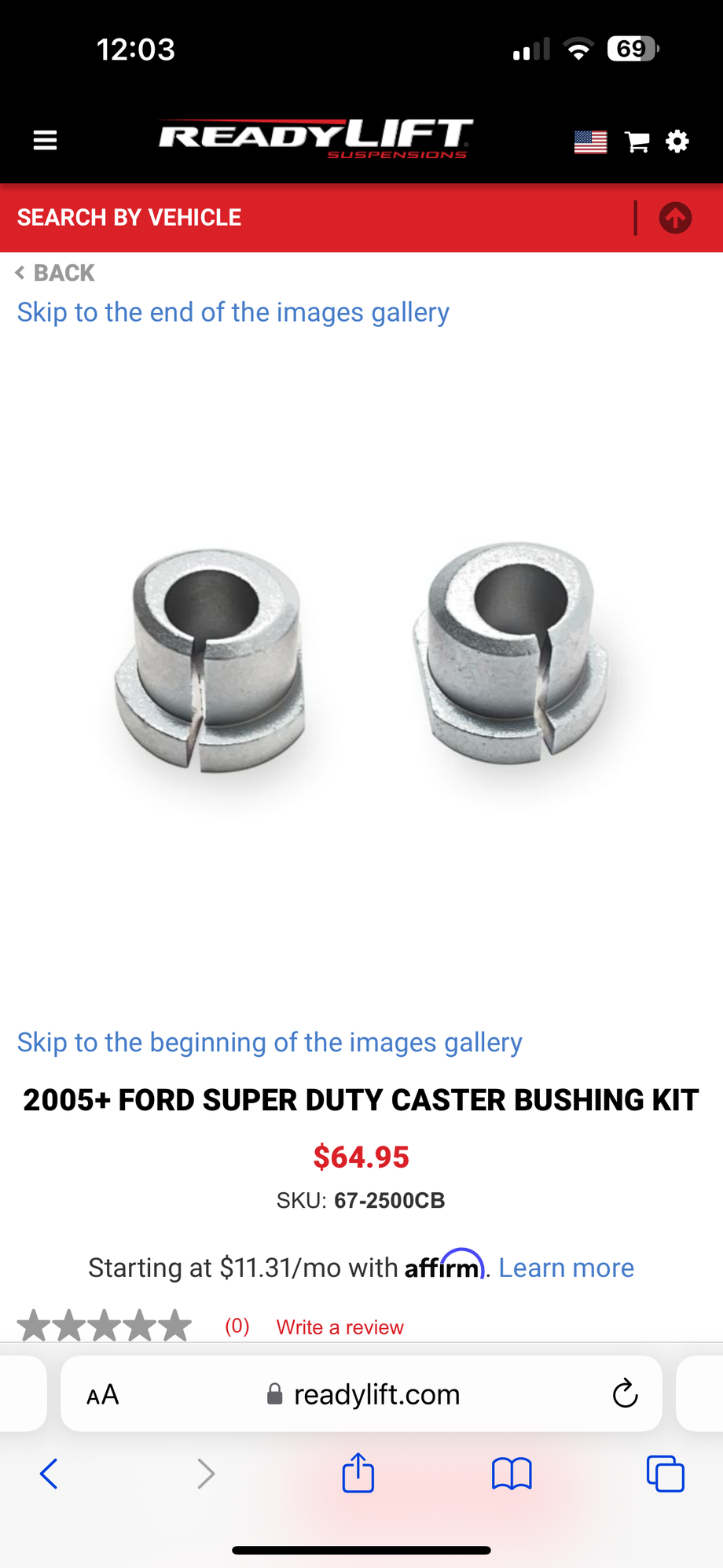

@Campos02 you'll need the caster shims to keep the steering tight. Otherwise it will feel really light and floaty - you won't like it at all. The shims keep the factory characteristics. Otherwise, this is a good solid lift - you'll be happy with it. If you haven't upgraded the steering stabilizer, you'll probably want to do that too. Fox has a good one but there are others; anything is an upgrade from FOMOCO.

caster shims like the ones below? Yeah I was looking at steering stabilizers already to go along with the leveling kit and read it’s a night and day difference. I guess any high quality brand steering stabilizer like fox or bilstein would be nice?
