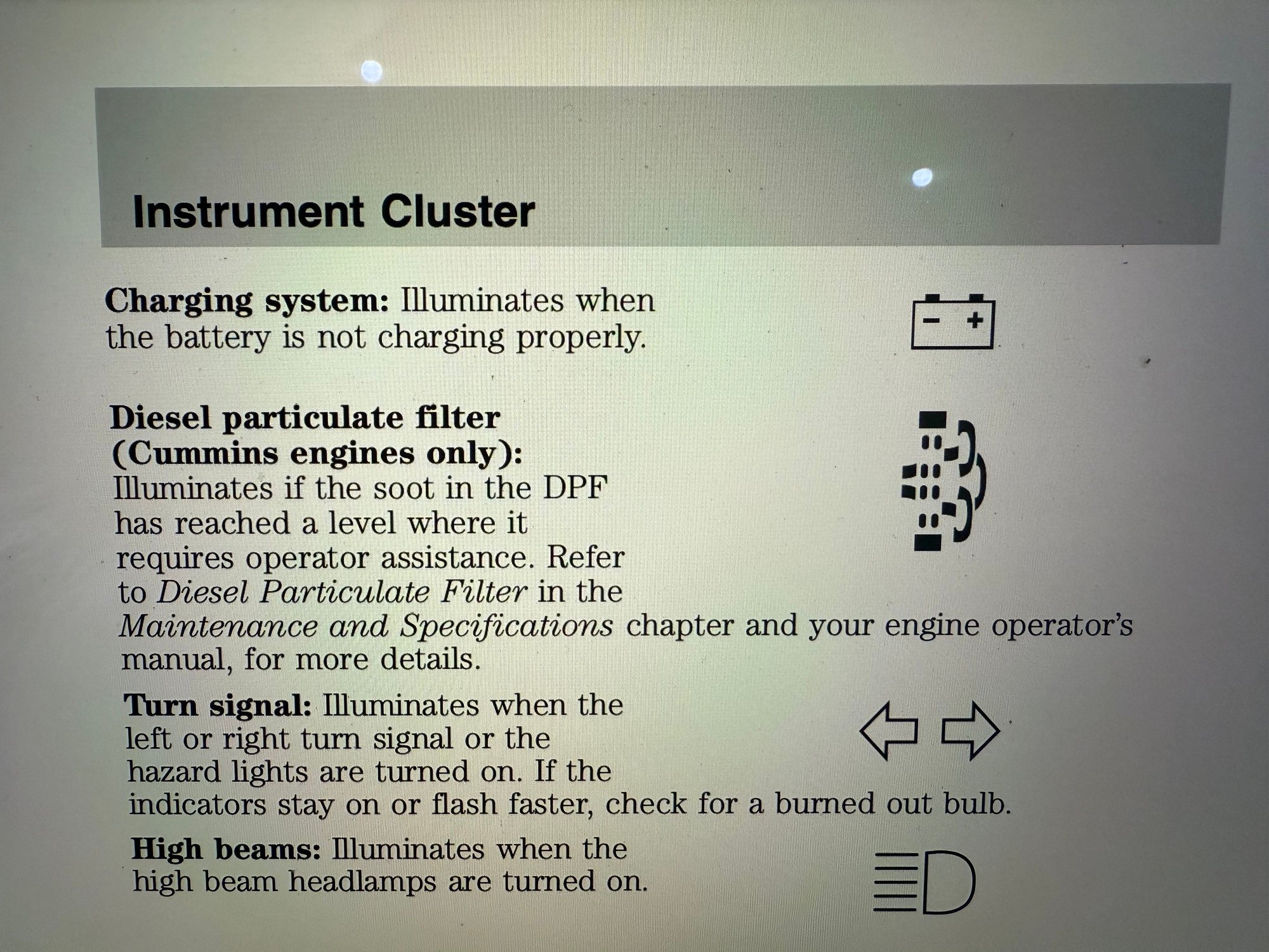

There, FTFY. That's the DPF regen light.

I say RTFM....because it's most likely the regen light and you need further info/ Instruction. Probably says quit idling and making short trips; I need to get on the interstate for more than 10 miles at speed. Or there is an issue with the system and need to do a manual regen.
Either way, there are different cases for that light coming on.
and you probably want to take care of it before it puts you in limp mode...that always makes for a great time

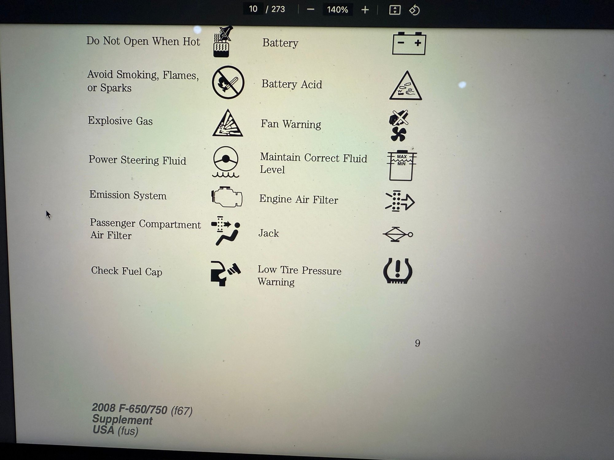

Took all of 2 seconds to google it

Originally Posted by ifrythings
That’s the plugged air filter light
unfortunately you are slightly mistaken...here are the filter lights; there is one similarity being filter sharing the 8 bold dots.
