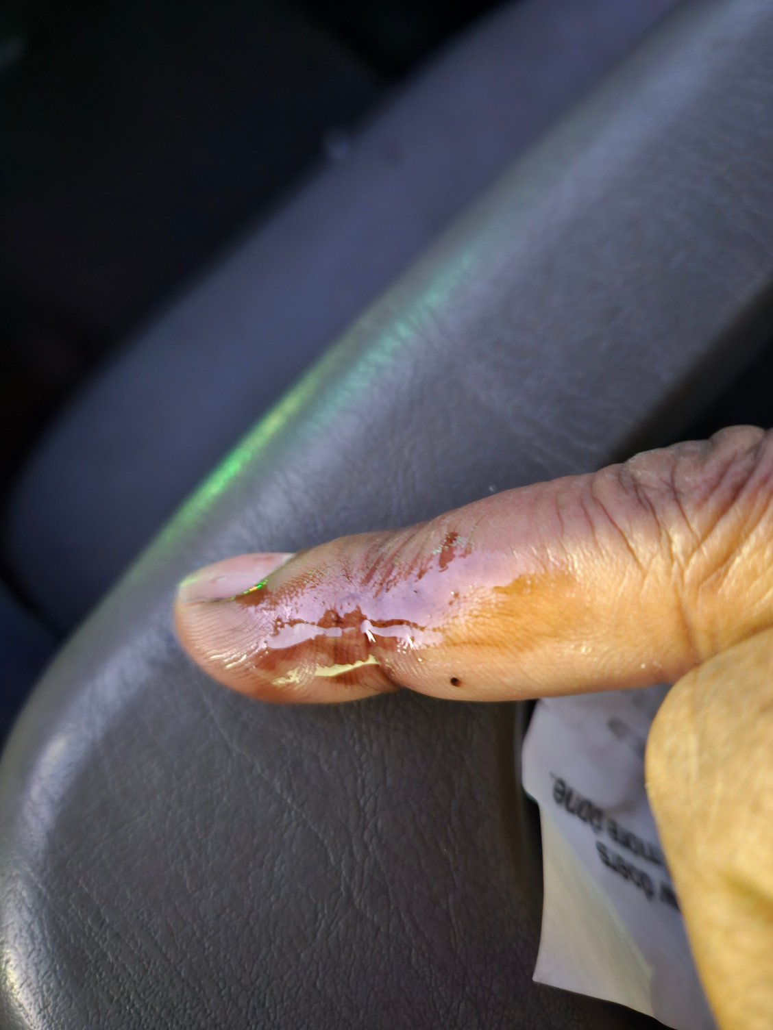

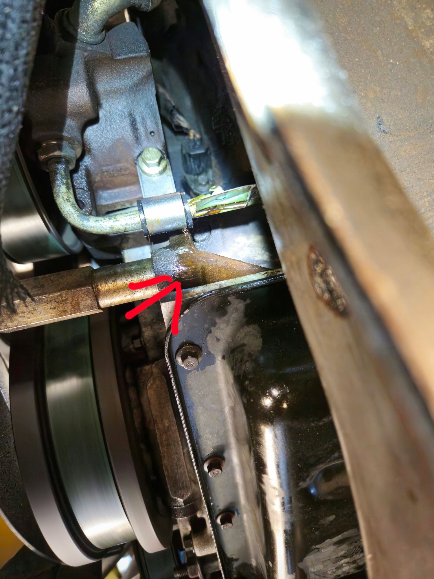

Anyone have any insight on a oil leak from front of motor driver side. I can for sure see the leak near the power steering pump (went back and forth on if it was engine oil or power steering fluid but looks and feels like engine oil to me). Doesn't leak when idling but after hitting it with brake parts cleaner and a quick drive you can clearly see where it coming down by the power steering pump. Assuming it's the front cover or maybe from the oil cooler somewhere.

After watching some videos I'm thinking it's probably the seal in this area. The leak only shows itself after driving. Just sucks you can't see where the leak is without tearing into the front of it BUT there are much worse problems you can have with a 6.0 lol

Yep. I've done that twice now. It seems it won't leak unless I drive it. Really no room to see anything even with a cheap endoscope I got from Amazon. May try unbolting power steering pump and moving it. Should be able to get a much better idea at that point.
