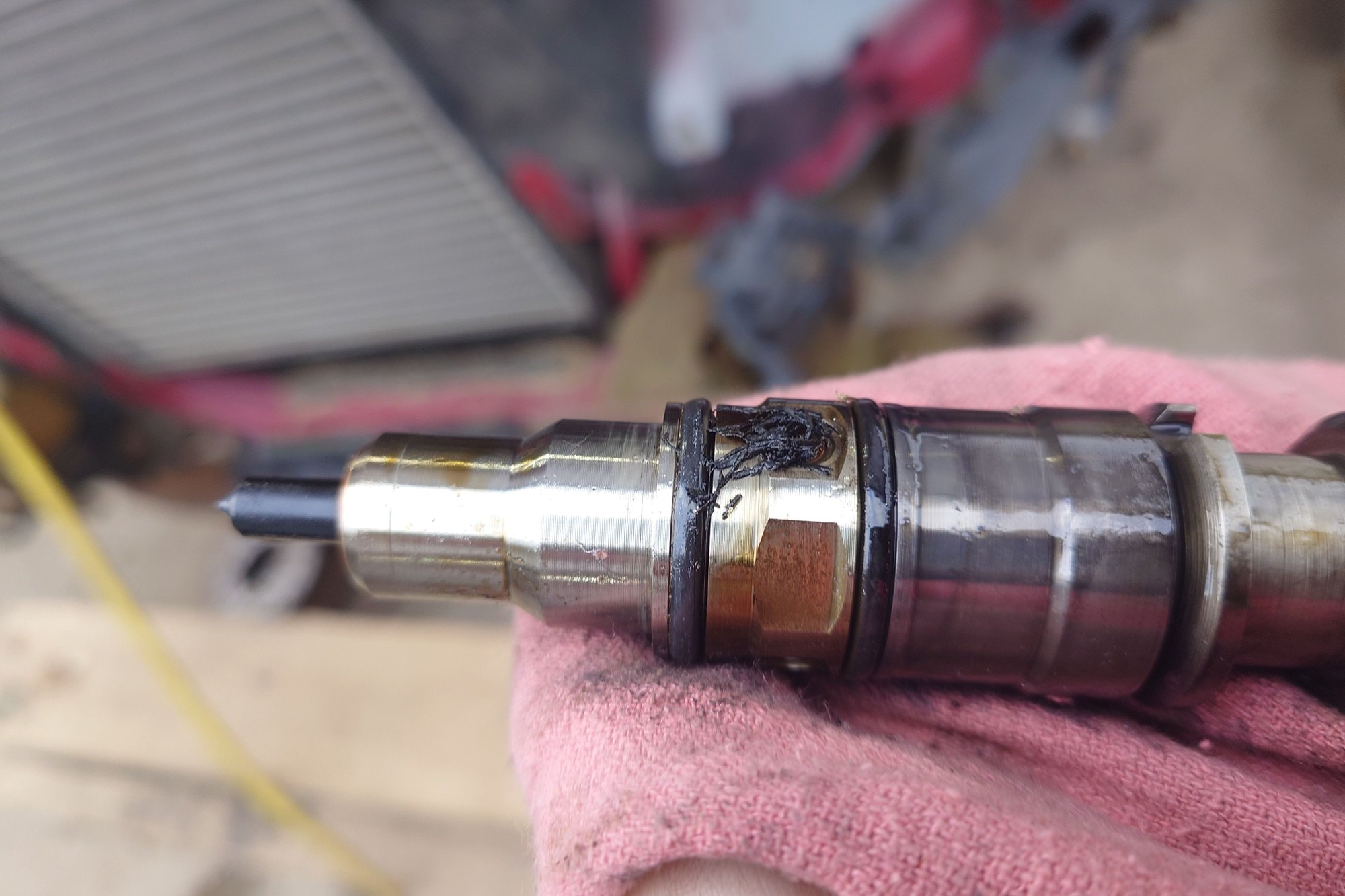

Old Dec 3, 2024 | 03:46 PM
Degut's Avatar
Degut
6th Gear
Joined: Dec 2024
Posts: 6
Loose injector
Loose injector
Loose injector with damaged o-ring
Another view of the damaged o-ring.
Neighboring injector to loose injector. Fuel ports clogged with o-ring shed from loose injector.
Aside from the injector being loose, the injector will be discolored from the fuel o-ring down from carbon deposits. Make sure you get all of the material out of the fuel ports on the head if this ends up being your issue.
