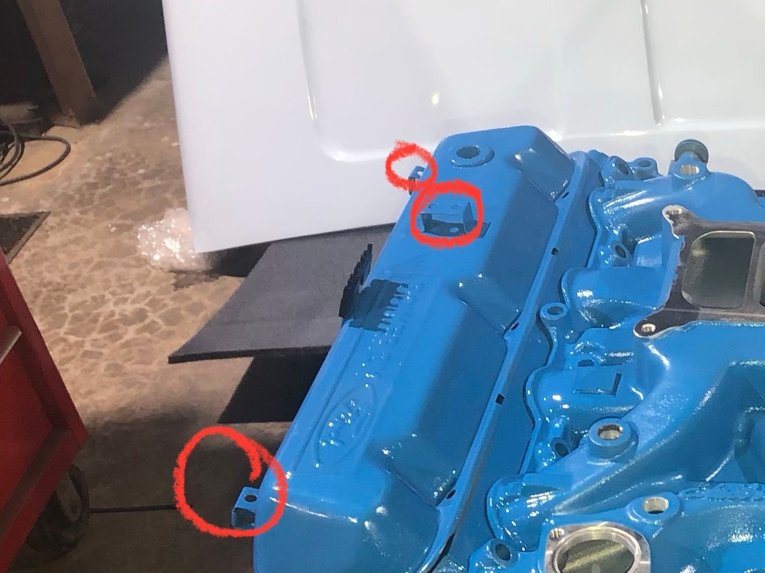

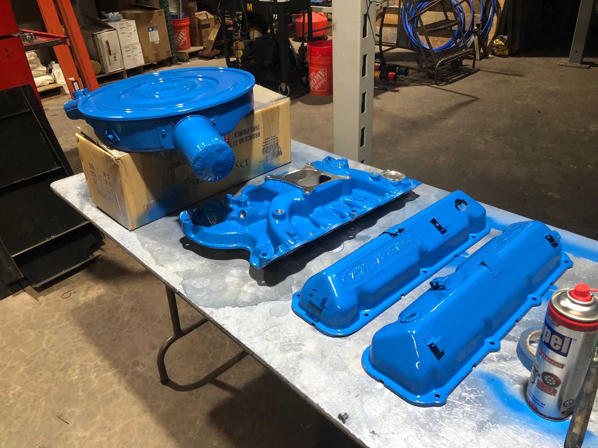

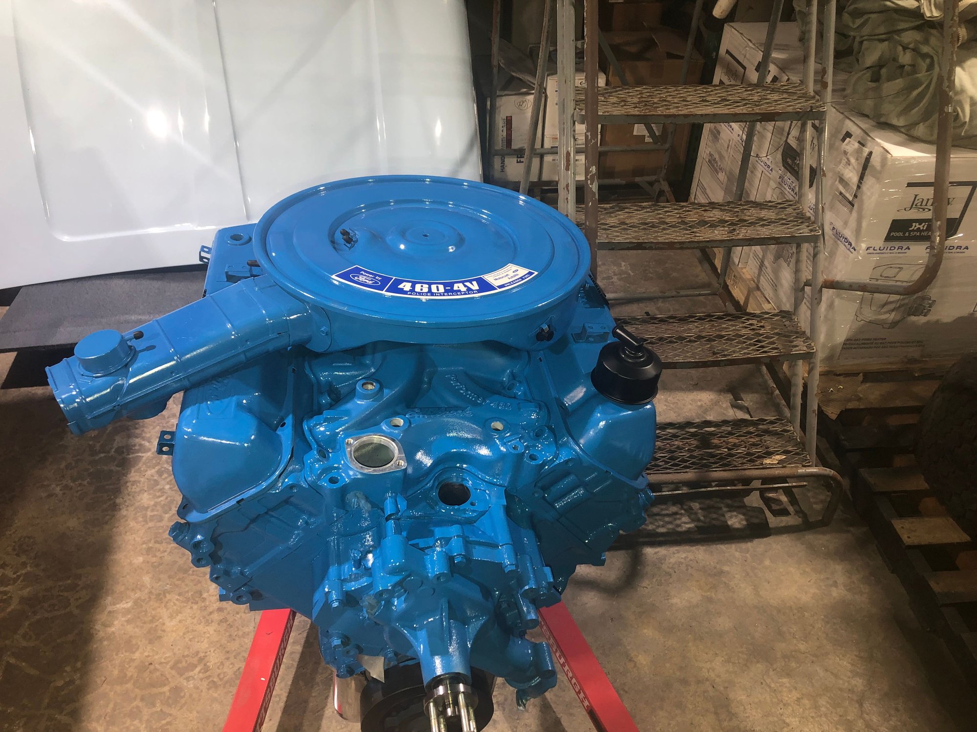

I'll receive the engine this week so I started working on some of the parts I have on hand. I decided to go with the lighter blue. Partly because I think they lightened up the blue as the 70's wore on and partly because I ordered ford blue paint and this is what they sent me lol. Again, not going for OE resto correct but more of a stock "type" of look.
Prob not correct but this is a late 70’s engine in a 1966 truck no i

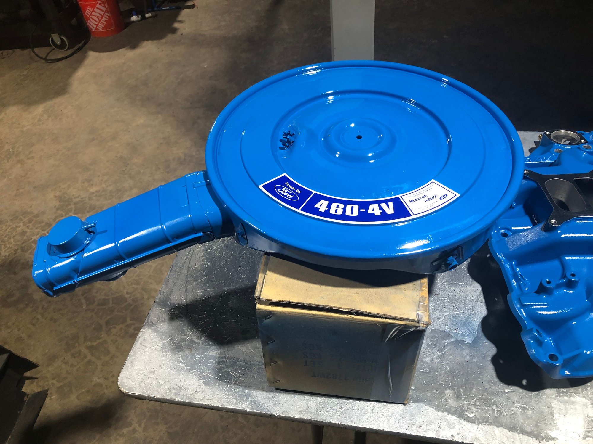

I took this before removing the canister off the side of the air filter

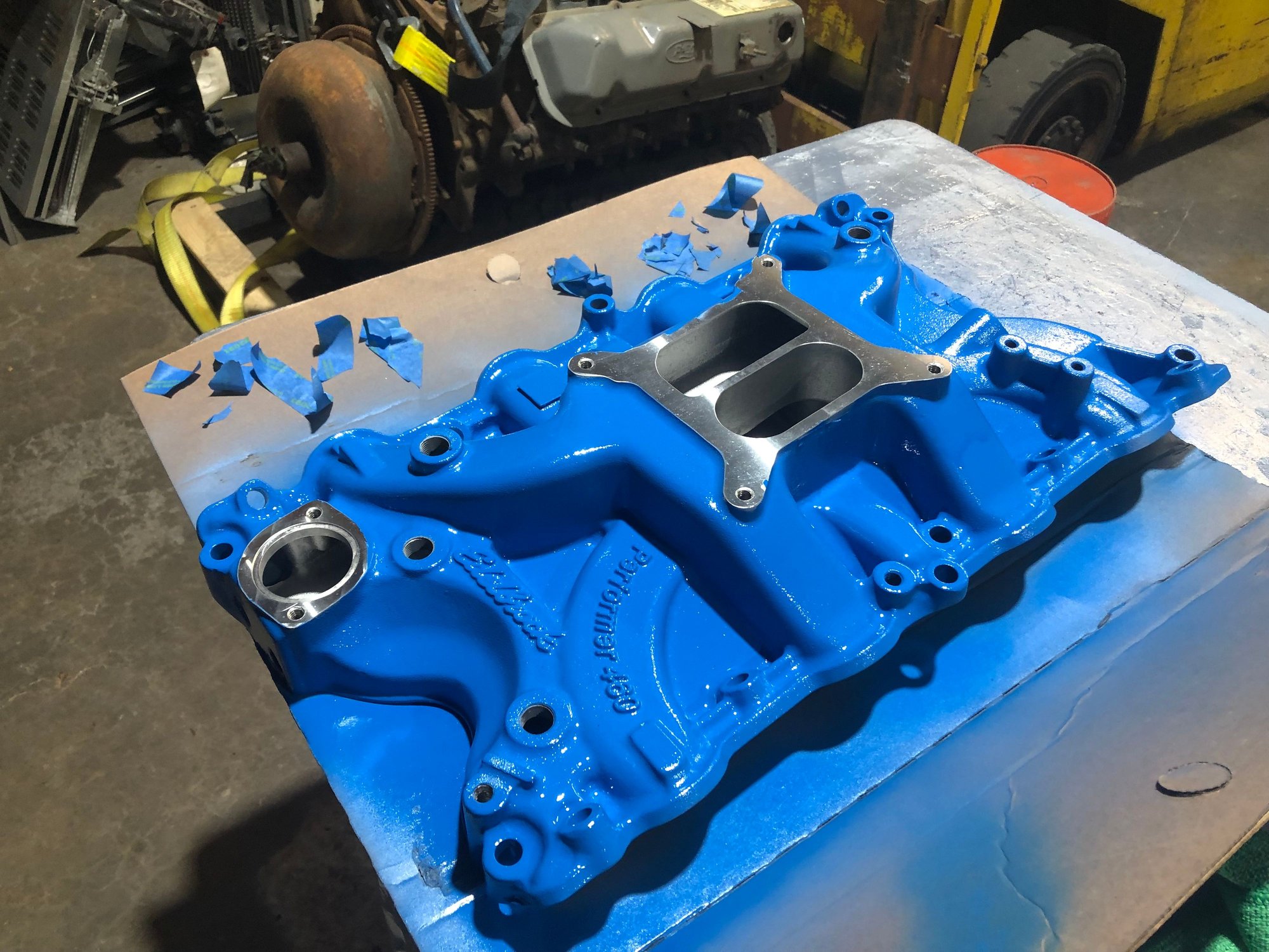

Edelbrock performer 460, nothing special. This will be roughly a 350hp engine. I considered using the factory intake but I’m not a fan of how they deleted the egr passages… like they hammered something  in there. My thinking was use the edelbrock because it’s a clean slate and save a little weight

Nice job! I like the 460-4V sticker.

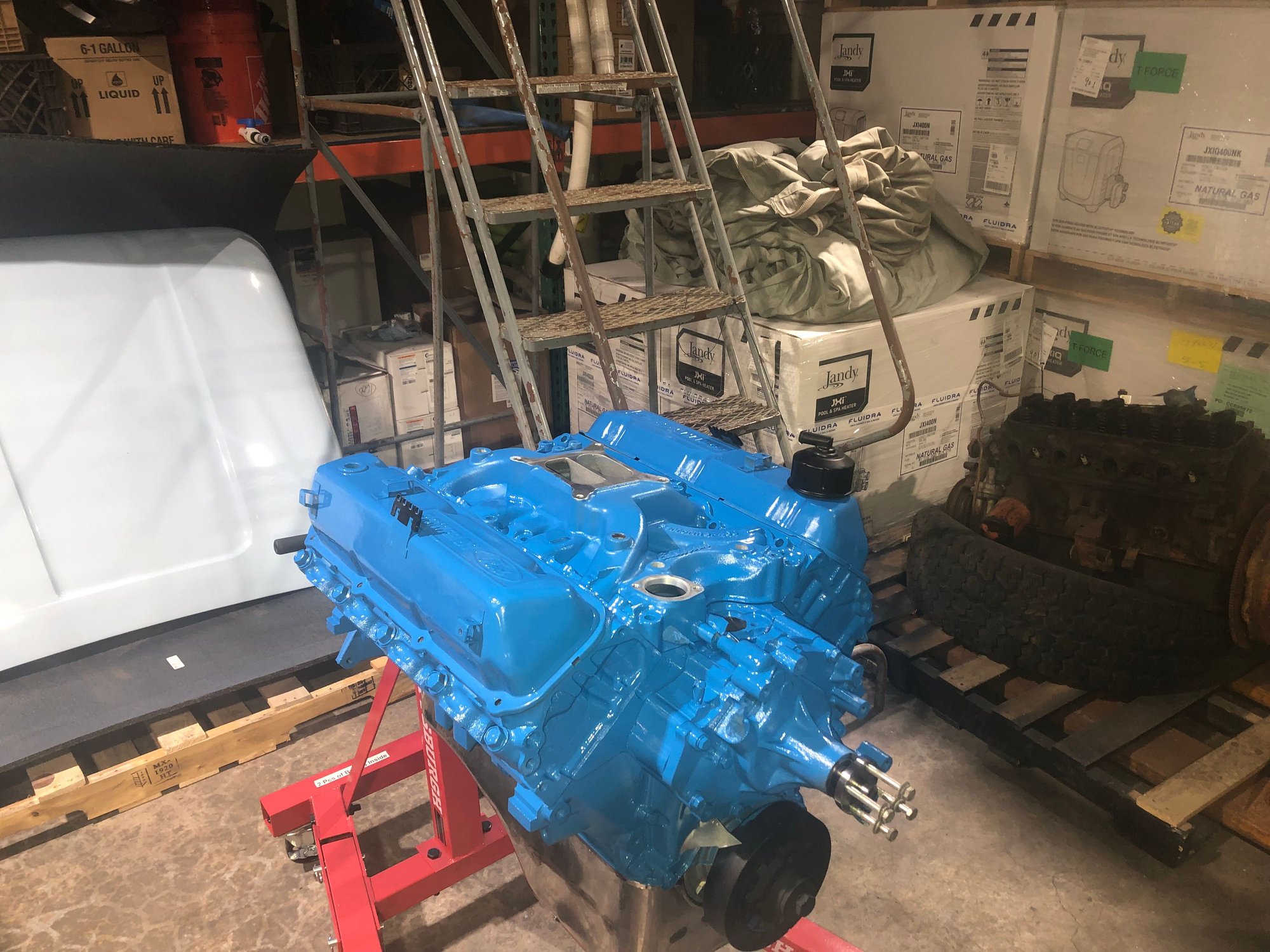

Getting there
Anyone know what these brackets hold?  They are threaded on one side so you can put a bolt in them.

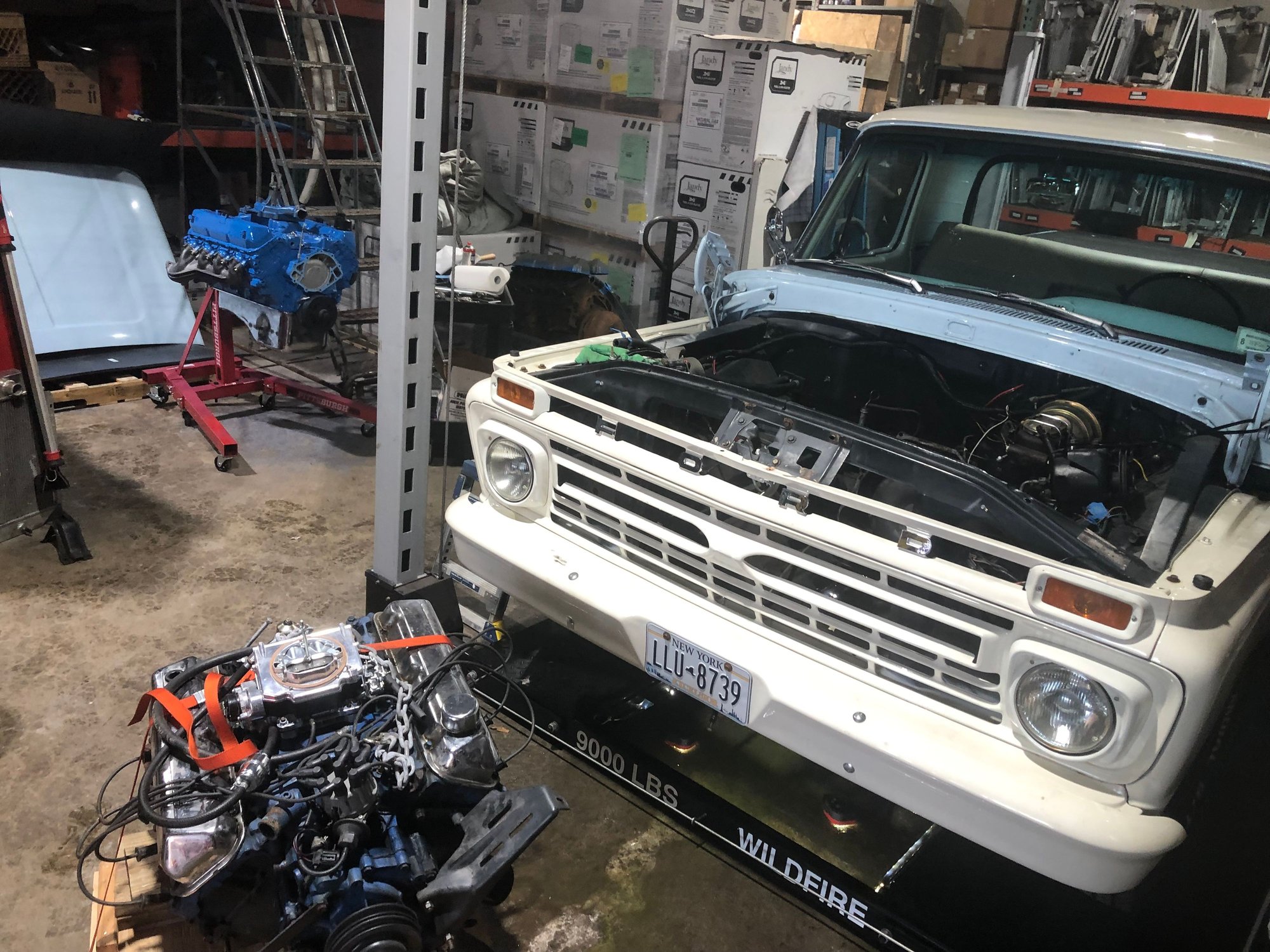

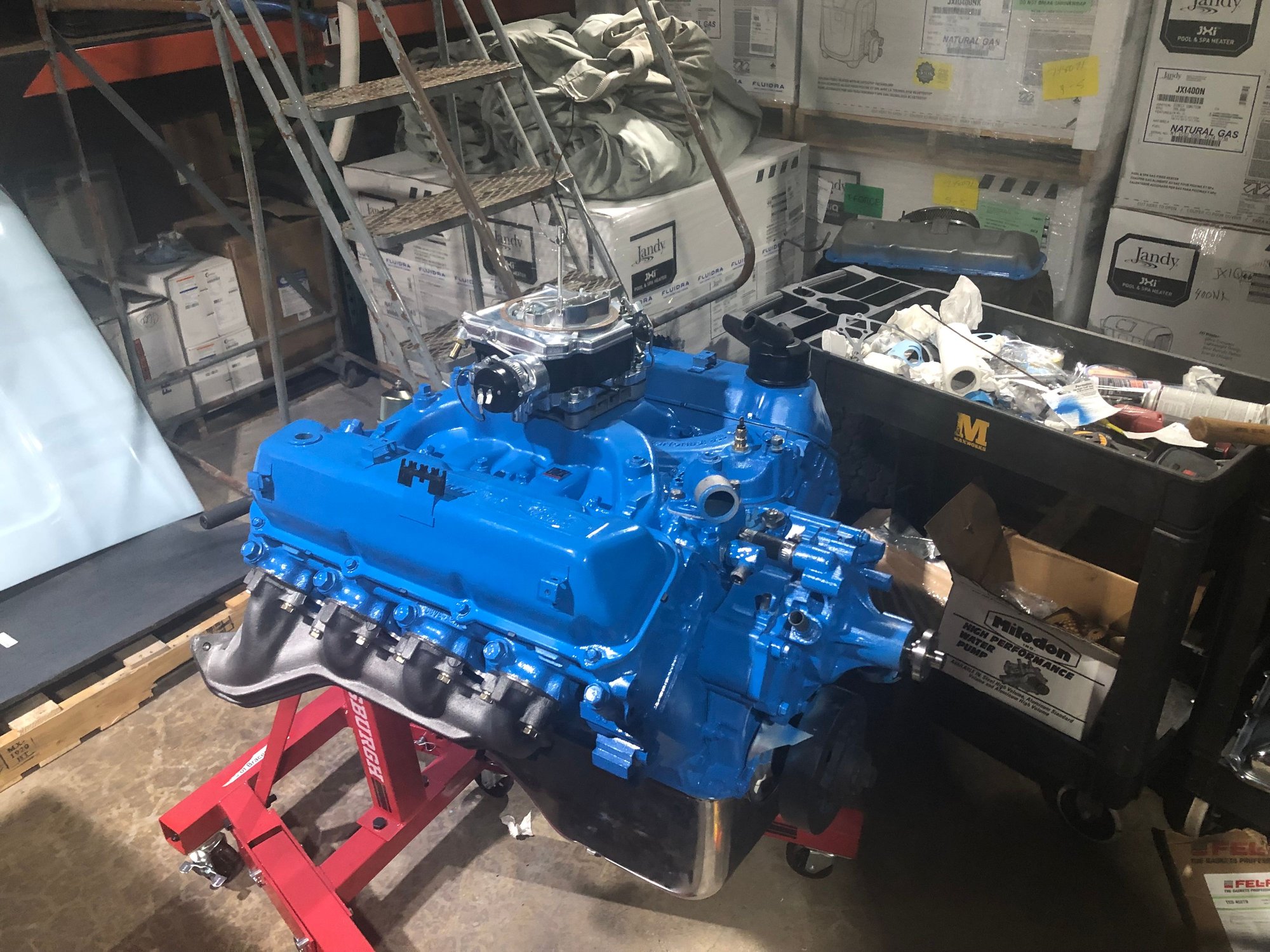

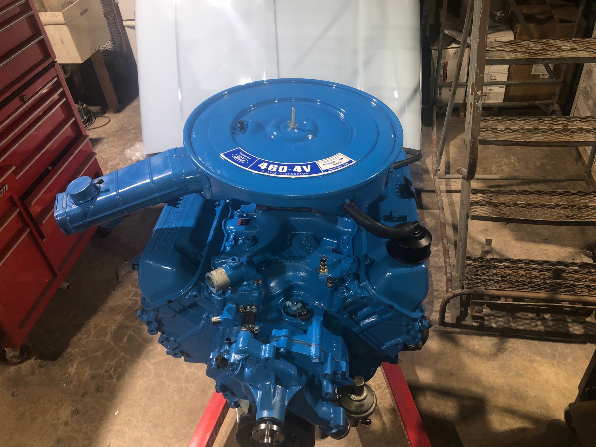

Engine fully assembled, old engine removed. Have to clean up and paint the engine bay first.

Very Nice!!! Are the manifolds painted or another type? I have some Cerakote for my headers, but that is a ways down the road. Great Job!

I media blasted with aluminum oxide via a cheapie harbor freight blaster. Then I sprayed 2 light coats of Eastwood

I didn’t get into any heavy diagnosis other than compression test. - it ran perfect but low on power, 7 of 8 in the 140 range , one was 110. It was using a lot of oil too. but this is a bone stock 70’s smog engine.
Before I could really formulate a plan, a fully rebuilt engine appeared through the 460 forum. I got a very fair deal on it so it made more sense to swap this one in.
