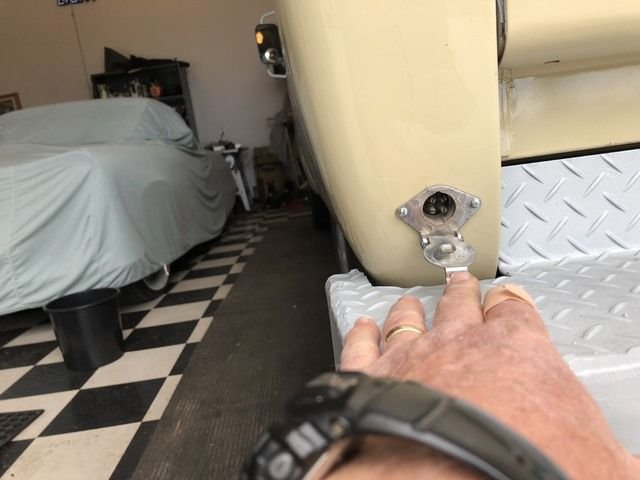

Funny how these treads go along. Anyway the relay has the part number on it. C5SB-13A410B. I always thought it was for the camper lights. Connector on the back fender.

That's not the part number Rich - Ford parts didn't have a part number on them after something like 1956. That is the Engineering ID Number. Different than the part number. Lots of parts have the same thing going on.
Intake manifolds, being discussed in other threads, have the Engineering ID Number cast into them and is different than the part number assigned to that item.
Another example is the front timing chain covers are base part number 6019 but typically have a 6059 base Engineering ID Number.
